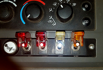

Lighted safety switches for Fire truck air horn, driving lights, ditch lights, backup lights and front and rear strobes:
The attachment 1.jpg is no longer available
Re: Share your switches setup
Posted: Thu Jan 02, 2020 8:40 pm
by verdesardog
with switches off:

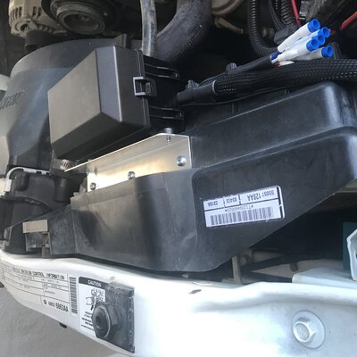

I finally decided to add some switches to my truck, I went with an inexpensive panel and remote relay/fusebox setup. The reason I chose this option is because it's compact and I like the fact that it uses traditional relays and fuses that are serviceable. The newer, more expensive units use integrated circuits that are non-serviceable, so if one mosfet dies, you have to replace the whole unit.
I used a piece of aluminum angle to mount the control box to the top of the A/C condenser fan shroud.

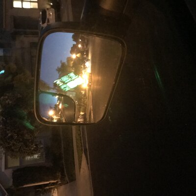

The only downside is that there's a reflection on the drivers door glass that's perfectly centered in the rearview mirror : (
The steering wheel blocks the glare at night and I've kinda gotten used to the reflection in the window. The newer version of this system offers a dimmable switch panel. My total investment was less than $70
