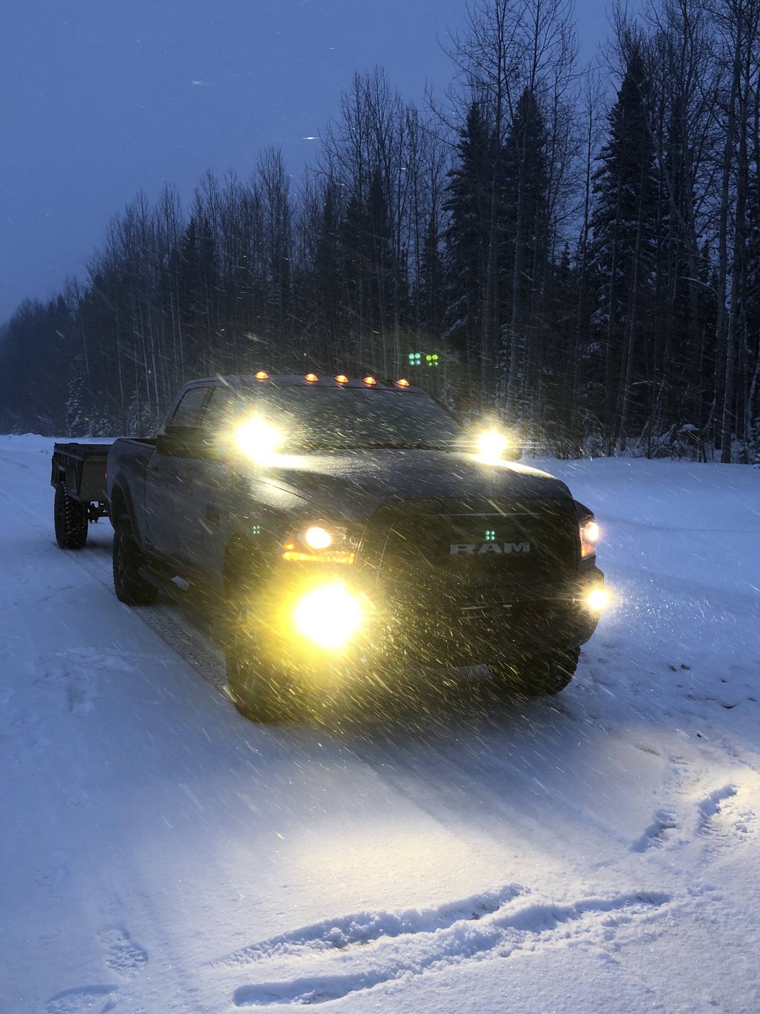

I’m using an AEV switch bezel with an sPod. I installed it about a year ago, was super straight forward and I’ve been really pleased with it. I wanted old school switches as apposed to some of the cooler options out there. Up here in the North Country we tend to use our lights pretty regularly and I wanted to be able operate them while wearing gloves.

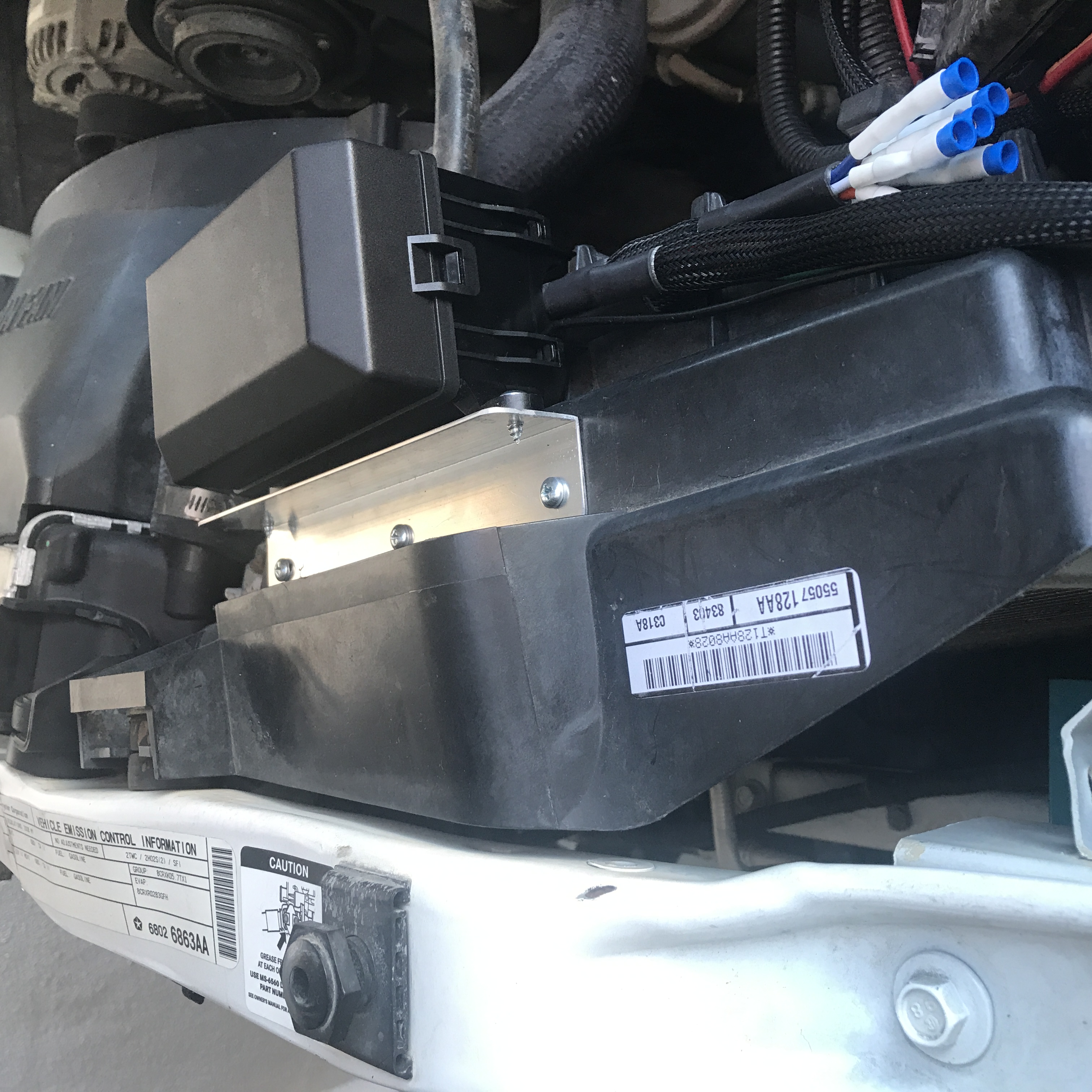

I finally decided to add some switches to my truck, I went with an inexpensive panel and remote relay/fusebox setup. The reason I chose this option is because it's compact and I like the fact that it uses traditional relays and fuses that are serviceable. The newer, more expensive units use integrated circuits that are non-serviceable, so if one mosfet dies, you have to replace the whole unit.
I used a piece of aluminum angle to mount the control box to the top of the A/C condenser fan shroud.

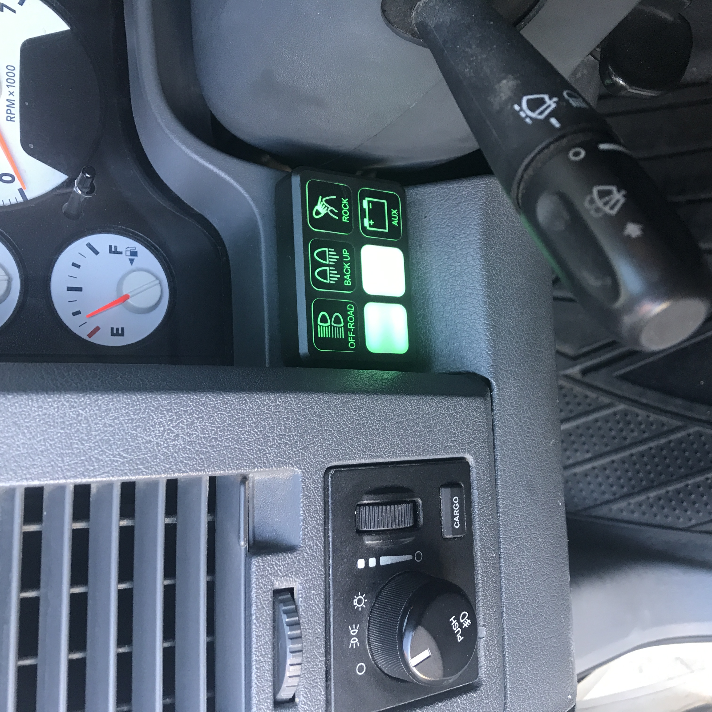

The switch panel fits perfectly behind the turn signal switch and I didn't have to drill any holes to mount it.
The only downside is that there's a reflection on the drivers door glass that's perfectly centered in the rearview mirror : (
The steering wheel blocks the glare at night and I've kinda gotten used to the reflection in the window. The newer version of this system offers a dimmable switch panel. My total investment was less than $70
