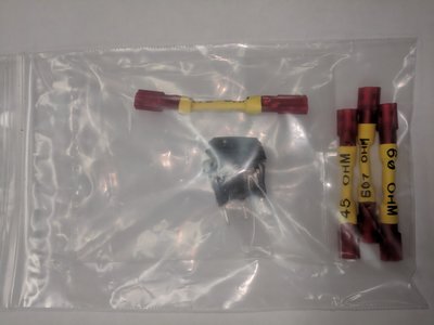

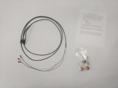

Here's updated pics of the kit in question. Unfortunately for this one, to make it plug-and-play, I needed to manufacture the male connectors that connected to the factory connector that goes to the sensor. The female ones are readily available and I already had the terminals in stock for them along with the male terminals, but per the manufacturer of that connector, they never made a male for it. It's only use is to plug into devices, nothing inline. So while it's found in several vehicles over the years for this and coils, it was never used with wires on the other side. Otherwise it would be a much less expensive setup. It is what it is with that, I have quite a bit of money and even more time into being able to manufacture the males.
I am working on a plug and play solution that uses the knob and doesn't care about what position you have the transfer case in, hopefully have the modules designed soon and a few prototypes in my hand by the end of the month. But for now, this is the only solution on the market at all to allow you to use the locking axles in any gear without hacking into your harness. Sure you can run a set of switches to the lockers, anybody can hack in a set of switches to turn them on!

Also, reading your instruction sheet in the photo you attached, based on past experience, the 210 Ω resistance was used from 2005-2011, as long as the New Process #271 transfer case was used. In early 2012 Ram began using the Borg Warner transfer case and the resistance changed to 60 Ω and is still the current spec as of 2017.
Good luck with your next project, there's a huge amount of interest in what you're working on.

Yes, the kit will work in all the trucks. I have all 3 versions of the knob to test that aspect, and the only thing the transfer case sensor will be used for in the new kit is to unlock the swaybar, which I can't easily get around without doing the 4LO trick. But the lockers will work without the 4LO trick since the module will directly control them. It'll see input from the knob, and turn on the appropriate locker solenoids based on that alone.
As for the rest of the stuff, I'll have to see. I don't have easy access to an actual PW like I do the Neons my business is focused on. I can get those for $200 all day, but not PW's. If it's as simple as pulling a fuse, I can look into something that can do the same thing with a switch and relay. But no idea on an ETA for something like that. Hopefully I can get the v2 locker bypass kit done in the next 2 months.
As for the 210 ohm resistance, I was given some bad info on those where it was 45 ohms for the 2005-2011 trucks, but after some troubleshooting over the phone in a Radio Shack parking lot with a guy that had a 2005, we came up with the 210 ohm resistor. I put them all in the kit for now but may just put in the 210 and 60 if that's what the two options are.
