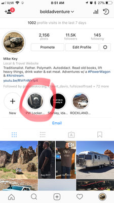

I started this project today. I might be willing to make a harness.... Maybe, it'd def be later in June after PWIM and some other stuff.
But very straightforward. Documenting the whole process on my Instagram story right now if you are interested: https://www.instagram.com/boldadventure/
I'll do a separate write-up and youtube video when I get more time. I'm in crunch time before we leave for Moab. And instagram is a very fast method for me to share info.

So I went to that instagram thing and I can not figure out how to navigate it very well. Didnt find anything about the locker setup. Did see a lot of cool pics though!

You have to have the app, to view stories. Sorry. That's just how it works. I realized half way through my posting this content would make a better youtube video. I decided to even use a wireloom, which ate up WAAY to much of my day, lol.

Ah I see. I will have to try and figure out how to get the app.MikeKey wrote: ↑Sun Apr 15, 2018 10:51 amYou have to have the app, to view stories. Sorry. That's just how it works. I realized half way through my posting this content would make a better youtube video. I decided to even use a wireloom, which ate up WAAY to much of my day, lol.

So I went on my wifes phone with her instagram and watched that locker video.
You definitely need to post that here somehow. Lots of good info.

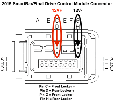

I can see running the hardwire harness all the way to the rear axle if you were going to use an OEM connector, but if you’re going to cut the factory wires, might as well do it up at the firewall/engine bay where it would be better protected from the elements and save 10’+ of wire and loom frustration.

I had a hard time tracing, and when I did, I found multiples of that color wire on my 2015. This was also the case at the sway bar controller.Retired BLM Rig wrote: ↑Mon Apr 16, 2018 5:12 pmI can see running the hardwire harness all the way to the rear axle if you were going to use an OEM connector, but if you’re going to cut the factory wires, might as well do it up at the firewall/engine bay where it would be better protected from the elements and save 10’+ of wire and loom frustration.

You could have texted/call me, lol. I would have told you which wire was the locker source and return at the smart bar....MikeKey wrote: ↑Mon Apr 16, 2018 6:55 pmI had a hard time tracing, and when I did, I found multiples of that color wire on my 2015. This was also the case at the sway bar controller.Retired BLM Rig wrote: ↑Mon Apr 16, 2018 5:12 pmI can see running the hardwire harness all the way to the rear axle if you were going to use an OEM connector, but if you’re going to cut the factory wires, might as well do it up at the firewall/engine bay where it would be better protected from the elements and save 10’+ of wire and loom frustration.

After looking at the wire connector diagram for the SmartBar, I see what he means about duplicate wire colors. Why would Dodge/Ram do that when they have a full spectrum of colors to choose from?

I was banging my head over that "Light Gray and Yellow and Yellow and White color choice. Ok, maybe when brand new, but I spent 5 mins cleaning and getting out my light and being sure my eyes weren't deceiving me. Worst color combo ever! Yellow and orange weren't bad.Retired BLM Rig wrote: ↑Tue Apr 17, 2018 4:52 pm

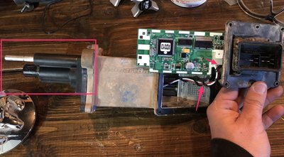

I think they are wondering is if one could simply overide and operate the original sway bar setup with a separate switch, like you just did with the lockers.
Re: Hardwired Lockers with OEM Knob
It's possible based on how the mechanism works, but I dunno if you would be able to wire directly into the harness itself. That doesn't seem likely.
However..... take a look here. I just took this photo of the smart bar control module opened up. The sway bar disconnect acts like some sort of plunger. Then you have a red and white wire leading to it, along with two smaller black wires. I'm assuming that's a bit like the lockers, based on the diagrams in this thread. 12v power, 12v ground, and sensor. You would have to crack it open though I think to bypass it.

Yes you might be on to something there. The 3rd wire might be for a sensor, to notify the computer what location its in.
You could hardwire the smart bar but I’m almost sure it would be internal splicing, so you’d pull the housing like in Mike’s pic, drill a new hole into the housing and splice the hardwire wires through the new hole to those wires inside.
The third wire is the sensor wire, correct. The mechanism is a solenoid and acts like a start motor solenoid, but uses a sensor line instead of a control line.

Here's what another member said about the sway bar disconnect on another thread, however he was talking about a 3rd gen. He says that it's a motor not a solenoid, which makes sense because when I operate my sway bar it sounds more like a motor spinning than a solenoid clicking.
Spikethedog wrote: ↑Mon Jun 13, 2016 10:44 pmThat wouldnt work, the swaybar motor only turns one way, pushing the shift fork into disengaged position against a spring. Theres a plunger besides it that registers depth and when its happy it sends power to a an electro magnetic brake that is fitted at the end of the motor and i would assume simultaniously (sp?) shuts off power to the motor. Then all you need to Do is cut power to that brake to release it and let the spring push back the whole assembly back to engaged.(not sure if that will make sense to anybody its the best i can describe it in writing. Its a clever but overly complicated design imo no wonder it never work that long) I was thinking about a way to use a a 3 pos starter style switch that you hold for a pre determined amount of time then when you release it from "start" to "on" would actuate that brake but I came to the conclusion that a cable system would be the simper way to go about it. My swaybar has been on a shelf for a few months now in the meantime and i havent missed it yet...![]()

I'll leave this here in case someone else in the future wants to hardwire their lockers from the SmartBar connector. Edit: These are the wires you would cut or splice into to apply power and ground to the lockers. And actually you might not even need to cut the ground wires, it would require further testing to confirm whether ground is constant or controlled by the module. I'm still in favor of using OE connectors for hardwiring rather than cutting wires.

Motor, solenoid, whatever. The EVO thing seems to work with just a spring and a bolt that pushes against whatever it is the smartbar part in my picture pushes against. That seems to disconnect the bar. I didn't spend a bunch of time looking in there to figure out the mechanics. That's why I called it a plunger, that thing must move outwards.
