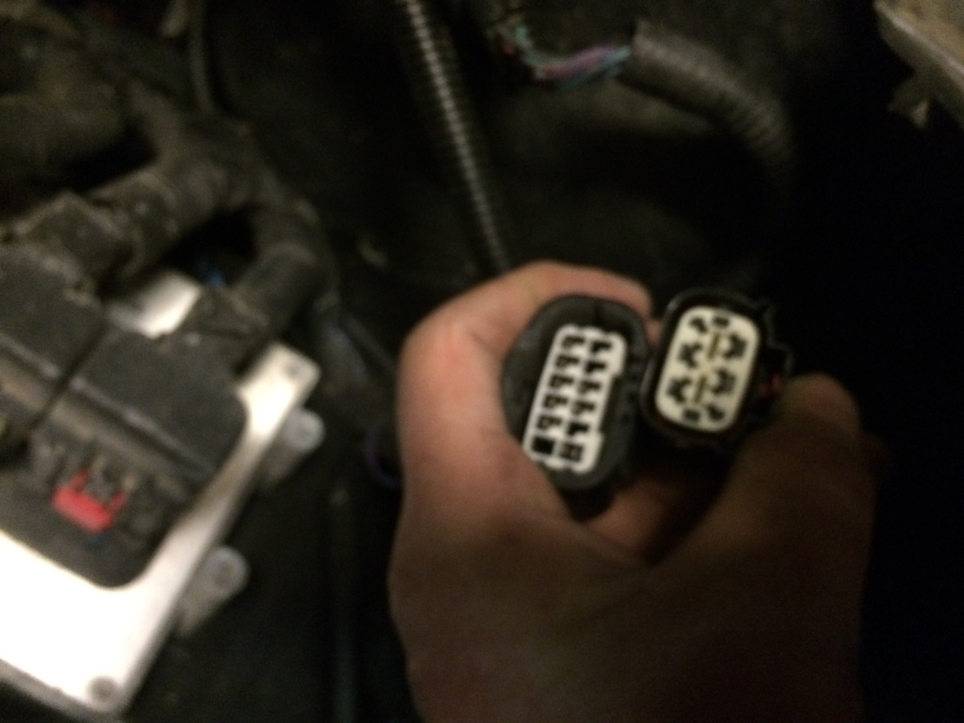

I think you've got the wrong connector for the T-harness. I see the computer in the background and the connector your looking for is towards the front of the truck, behind the headlight on the passenger side of the truck under the hood to the right of the radiator. I'm showing that I've shipped to 4 other 2010s and haven't heard anything about the wrong connector.
Re: Hardwired Lockers with OEM Knob
Duh I screwed up, sorry. Figured it out all installed and tested. One question, when I switch it to front and rear lockers both lights for the selections remain lit. Is this normal with this setup. I know on oem when you switch over to both lookers the rear locker lite goes out. Just wondering Otherwise this is a superb kit I recommend that everyone should have this on their trucks. Thanks again. Cheers. Campy
