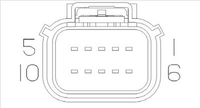

2. Now for the bigger issue. The 10 pin connector that has all the wires for sensing the knob position and for the LED's looks like it might have also changed. There's some incomplete info on the wiring diagrams. Can one of you 2013 guys check for this connector behind the passenger side headlight area? Need to make sure it's the same connector. I hope they didn't change it because that really throws a kink in things... While we're at it, can some of you 3rd gen guys check for this as well?

Would you mind checking for that 10 pin connector under the hood? I'd like to see if the 3rd gens have it too. If you do, that more than likely make this a direct install for all power wagons. From everything I am seeing, 2010-2014 all have this connector...BlkWgn wrote:if it lets me control the lockers so I can ditch the smart bar than I will take what I can get

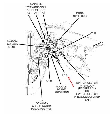

I'll snap a pic of where mine is when I get home. Looking at the 3rd gen diagrams, I don't think you're going to have it. Here's screen shot of the only connector I could find that has the wires that I need, other than at the smartbar itself. This connector is in the cab at the driver's kick panel. The 3rd gen diagrams aren't nearly as good as the 4th gens, so there might be another connecter inline with this one under the hood before it hits the smartbar.BlkWgn wrote:Where is it, if it is not raining I will check when I get home tonightmyoung84 wrote:Would you mind checking for that 10 pin connector under the hood? I'd like to see if the 3rd gens have it too. If you do, that more than likely make this a direct install for all power wagons. From everything I am seeing, 2010-2014 all have this connector...BlkWgn wrote:if it lets me control the lockers so I can ditch the smart bar than I will take what I can get

I'm pretty sure it hasn't change. Here's the pic showing where the plug in question is located. This is on the passenger side.TrueBlue13PW wrote:I won't be back and able to check my 2013 out until next week. If you don't have an answer for the 2013's by then I'll check for you.

According to the mopar connector website, c137 is a 14 pin connector for a 2007 PW. I am anxiously waiting the development of this harness.

Got any part numbers on the connector?
