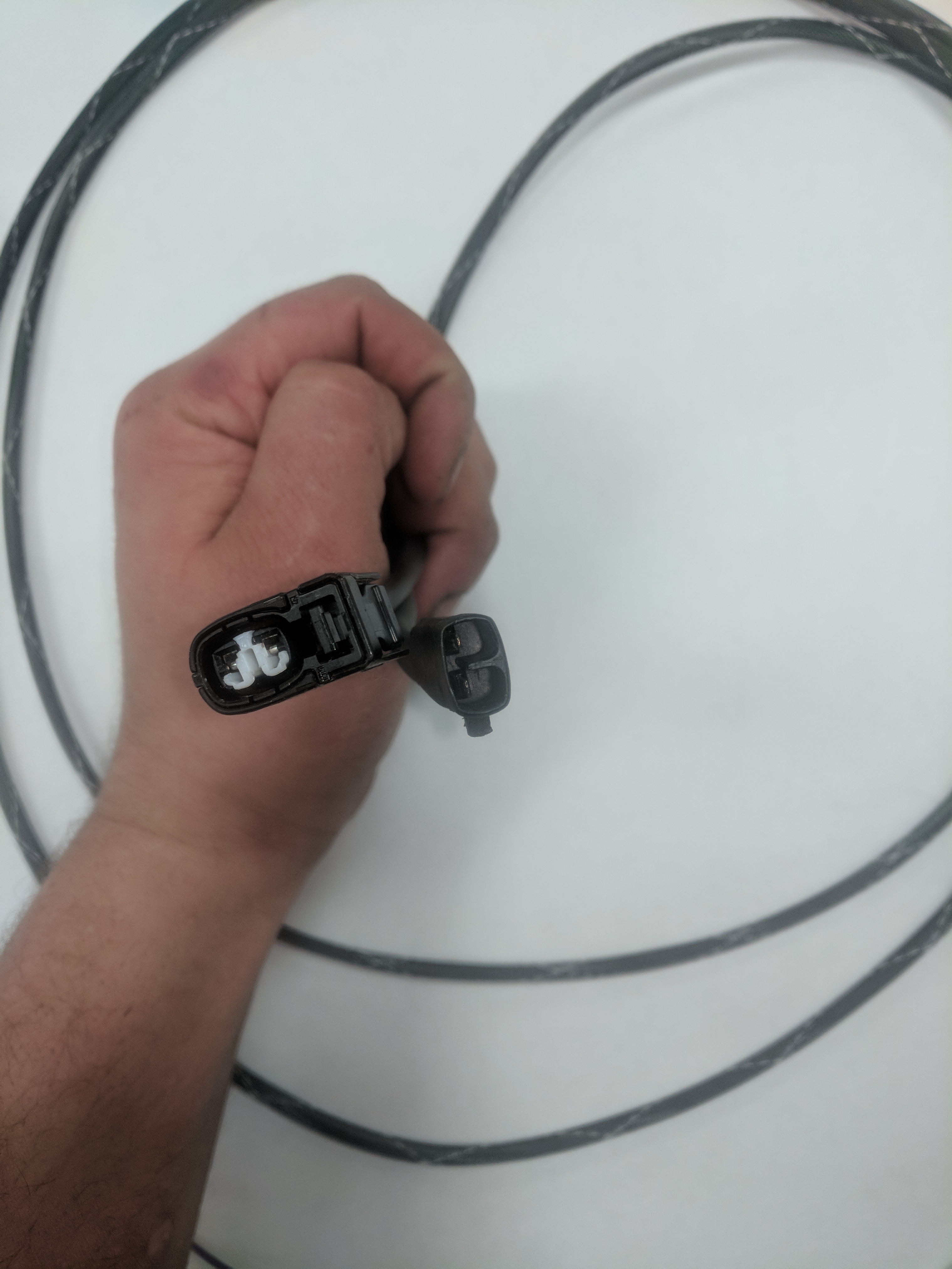

Post by Kinnettic » Tue Jan 16, 2018 4:58 pm
Here's updated pics of the kit in question. Unfortunately for this one, to make it plug-and-play, I needed to manufacture the male connectors that connected to the factory connector that goes to the sensor. The female ones are readily available and I already had the terminals in stock for them along with the male terminals, but per the manufacturer of that connector, they never made a male for it. It's only use is to plug into devices, nothing inline. So while it's found in several vehicles over the years for this and coils, it was never used with wires on the other side. Otherwise it would be a much less expensive setup. It is what it is with that, I have quite a bit of money and even more time into being able to manufacture the males.
I am working on a plug and play solution that uses the knob and doesn't care about what position you have the transfer case in, hopefully have the modules designed soon and a few prototypes in my hand by the end of the month. But for now, this is the only solution on the market at all to allow you to use the locking axles in any gear without hacking into your harness. Sure you can run a set of switches to the lockers, anybody can hack in a set of switches to turn them on!

I'm aware of the downfalls of the first kit, I don't have a PW. I was approached by an owner of one and developed the kit in a few weeks since people wanted to use the knob. I'm working on a better solution. As for copying other kits, no thanks. I don't copy stuff. Hell I was already threatened with an attorney over this kit because it is apparently someone else's design! Nothing ever came of it though, not that I was surprised. I doubt anybody else ever manufactured the male connectors anyways.
I'll be working on the circuit board design tonight anyways. I have the code written and made a breadboard back on Thanksgiving that functioned with LEDs using a Neon TPS instead of the actual knobs just for proof of concept. I have since ordered one of each knob to use to test the setup once I get some more pieces in my hand that should be here tomorrow. It'll work off the stock knob and plug into the stock harness with a T-harness, fuse, ground, and plug right into the front and rear lockers. I can get all those connectors easily, I've already looked over a 2016 PW and almost had them in stock already from another product. Just wrong pin count.
Here's a crude phone video of the LEDs lighting up as I rotate the TPS. The module will see the knob output and control the lockers based on that.

Also, reading your instruction sheet in the photo you attached, based on past experience, the 210 Ω resistance was used from 2005-2011, as long as the New Process #271 transfer case was used. In early 2012 Ram began using the Borg Warner transfer case and the resistance changed to 60 Ω and is still the current spec as of 2017.
Good luck with your next project, there's a huge amount of interest in what you're working on.

As for the 210 ohm resistance, I was given some bad info on those where it was 45 ohms for the 2005-2011 trucks, but after some troubleshooting over the phone in a Radio Shack parking lot with a guy that had a 2005, we came up with the 210 ohm resistor. I put them all in the kit for now but may just put in the 210 and 60 if that's what the two options are.
