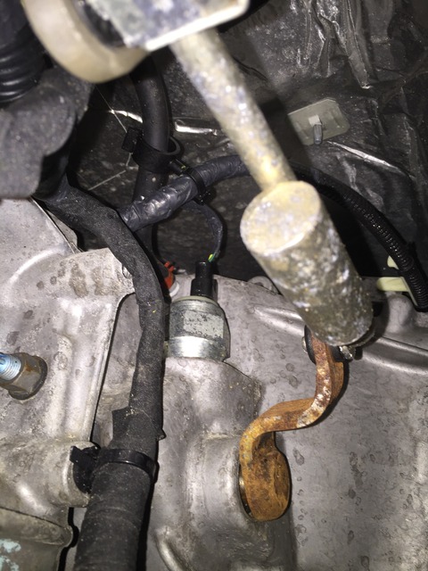

Just a few words about the 4th gen resistance issue:
When Ram changed to the Borg Warner transfer case in Jan. 2012, the TCPS 4Lo resistance also changed and based on the testimony of others I assume it changed to 60 ohms.
Based on what ACBoomer16 posted on page 1 of this thread, we know that the 4Lo resistance of a 2016 truck is 49.2 ohms.
What we don't know is when did it change from 60 ohms to 49.2 ohms and is it still the same for 2017?
To answer these questions will require some detective work and input from the 4th gen guys that are interested in doing this mod.
I'm just trying to help fill in the locker bypass void that currently exists. :patriot:

What I would like to find out is the ohm reading across the two terminals of the transfer case position sensor, when it's shifted into the 4X4 Low position, for each model year truck from 2012-2017. If you want to supply a reading for a 2015 truck, that would be great! To do this you need to unplug the sensor located just above where the shift linkage enters the T-case and then probe the sensor terminals with an accurate ohm meter. It's easier said than done, the access is very limited. It might be easier to just remove the sensor and bench test it.
If any 4th gen guys have a factory service manual, the sensor specs should be available in there.
Thanks for offering! :patriot:

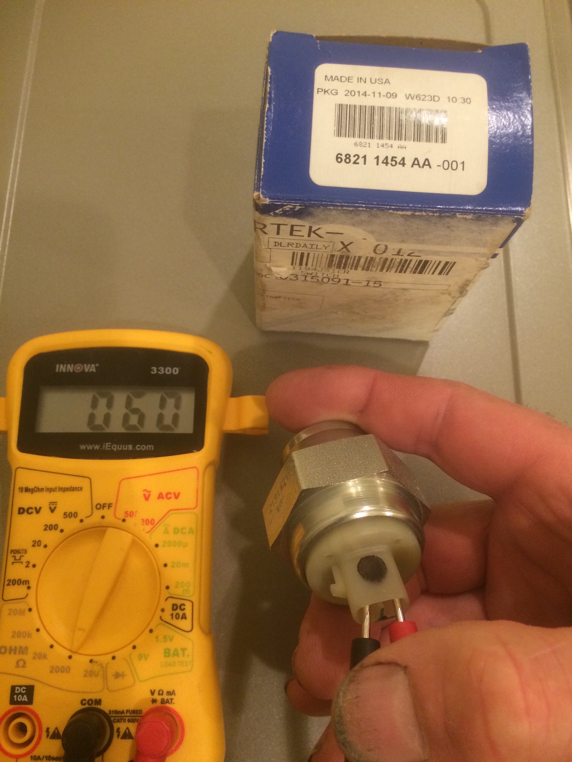

According to service information from late 2012 through 2017 the resistance should be 60.4 ohms +/- 1%. Hope this helps.

I had parts look up a t-case position sensor for a 16 and came up with 68211454AA and says it fits 13-18.

Yep, this setup worked on my '16. Needed the resistance set at 60 ohms. 47 ohms = no worky.
