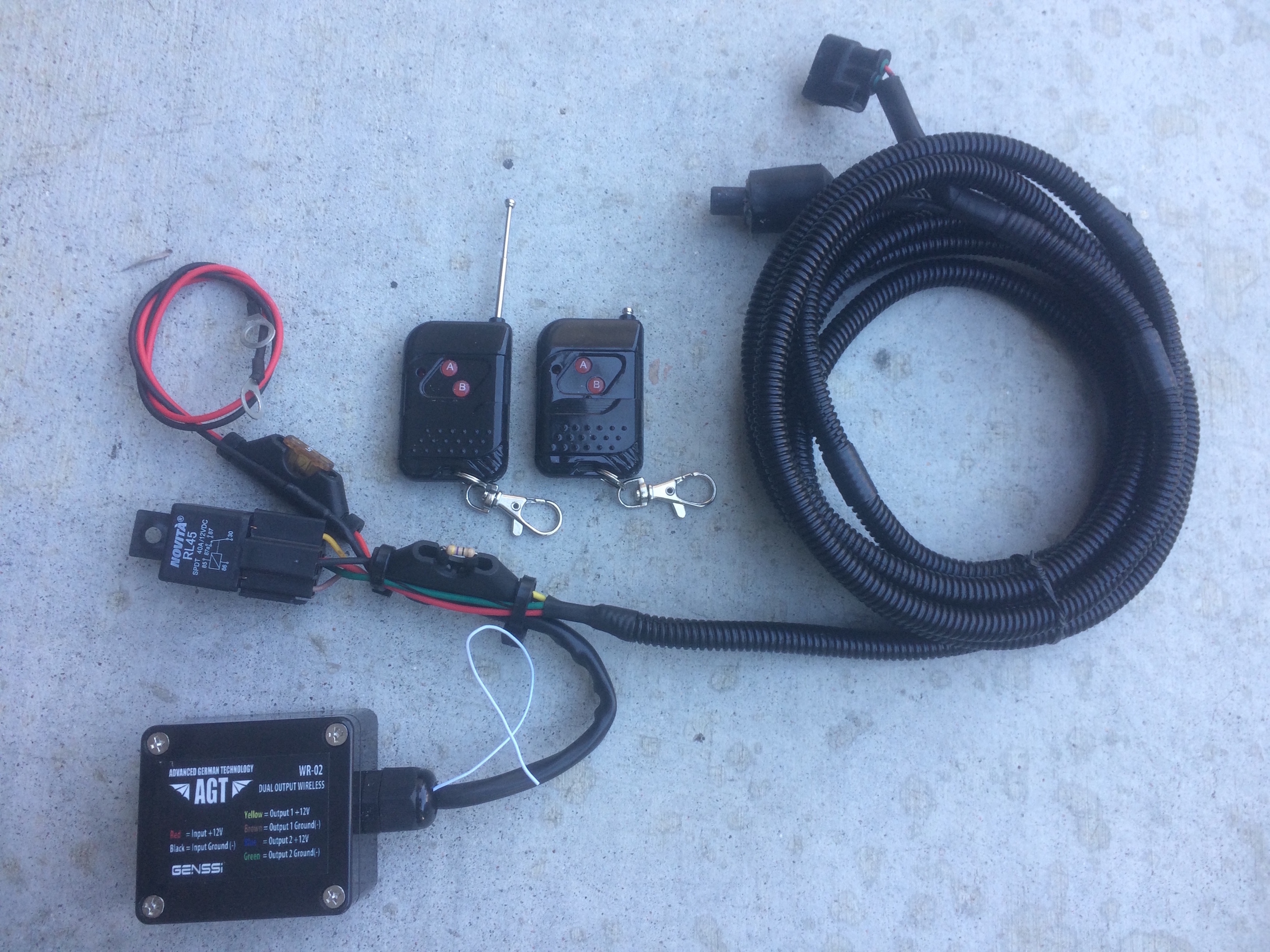

I found a victim... I mean volunteer.
Working on a prototype to see how the new/old school locker bypass affects the newer trucks.
I'm curious to see if the traction control and ABS nannies shut down, when it sees the truck is in faux low.

There sure is an awful lot of stuff in that pic!

I have that same remote, I had to disassemble it and glue in the loose circuit board.Retired BLM Rig wrote:I found a victim... I mean volunteer.

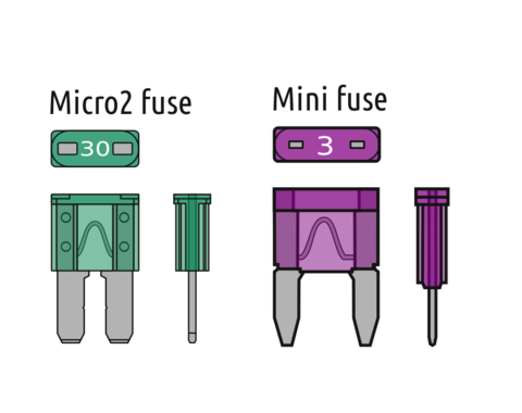

Ok... next question. Are the small fuses on the newer trucks "Mini" or "Micro2"? The owners manual says micro, but I want to be sure.
Since Ram doesn't provide an accessory power source, I'll have to make one with an Add-A-Fuse. I need to know what type to get though, mini or micro.
Re: Homemade Old School Plug and Play Locker Bypass
Micro but I couldn't find them anywhere except from Ram.

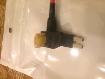

Finally got the "Add-A-Fuse". Here's what it looks like for those that are unfamiliar.
Since the bypass draws less than one amp, overload will never be an issue.

Did you physically verify that fits in the fuse block?

I think that is the wrong fuse plug.

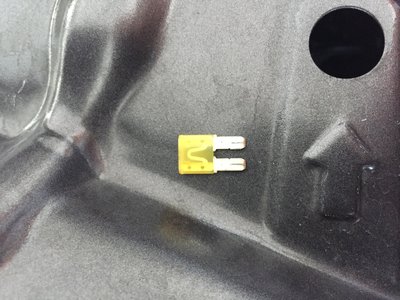

Could you or someone else with a 16-17 pull out one of the small fuses and take a picture of it for me please? I don't a 4.5 gen at my disposal right now or I would check it myself.

I won't be home until tomorrow. I had to modify an actual fuse which is one of the reasons I abandoned the ABS disconnect. If you found the correct remote fuse holder that would be great. Your remote could control the ABS and 4lo bypass.
Yes, that's it!
It's the correct "Add-a-fuse".
Good to go!

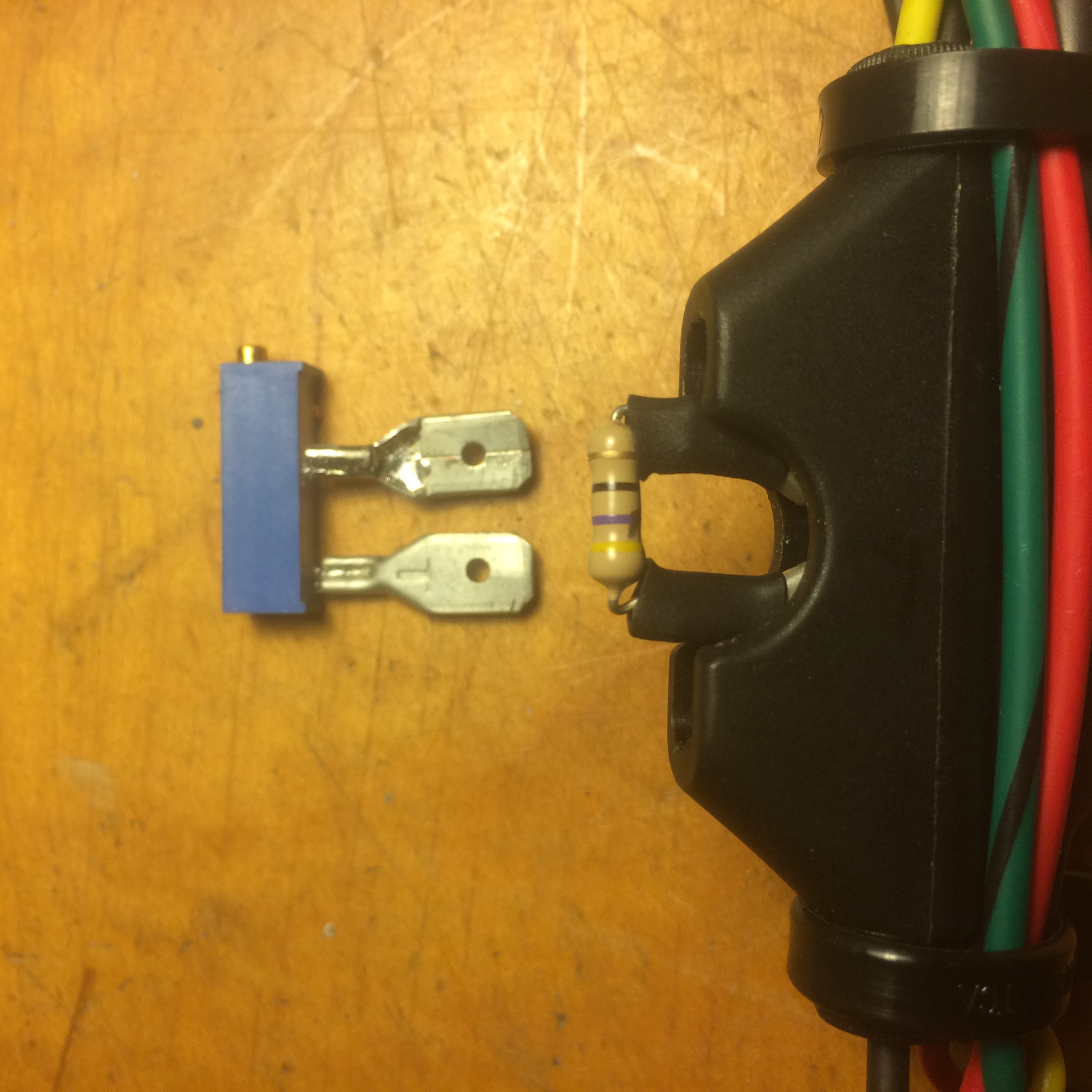

Sorry, that's my fault. The technical term would be rheostat or potentiometer, which is just a fancy name for a variable/adjustable resistor. This is the one I got from Radio Shack.14wagon86 wrote:So I get all the necessary parts and how to wire it up to the switch. However an adjustable resistor set to 49.2? I have no clue what that is and google failed......
It's adjustable from 0-1000 ohms, just hook up your ohm meter to the center and either one of the outer terminals and adjust the screw to the resistance you want.
This is the one I made for testing.
The only problem is that both 49 and 50 are non-standard resistor sizes. The only one I could find was a wire wound ceramic insulated 10watt that was too bulky for my use. The closest standard size is 47, that's why I'm trying that in the prototype.you think I could just use a 50 as most of the time there is a little play in ohms??
If you decide to try it, share some pictures of what you come up with.
