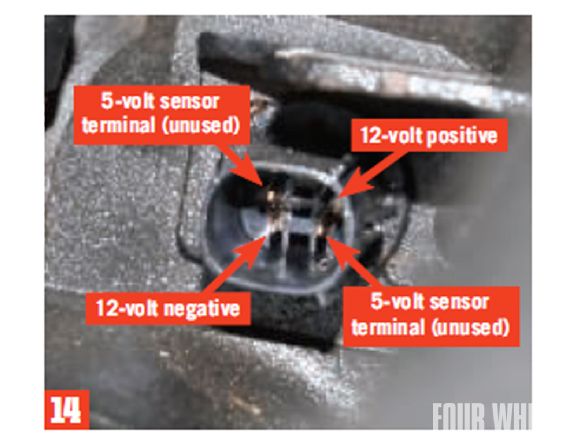

The only diagrams I have are for the old 4 pin system. I read somewhere that they changed the axle connector on the 14+ trucks from 4 pin to 6 pin. I don't know if they changed the wire colors or not. If your truck is still 4 pin, let us know for future reference.
Source is HOT (12v+), Return is Ground (12v-).
If I can remember, I'll try to look up a 2015 diagram at work tomorrow.

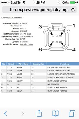

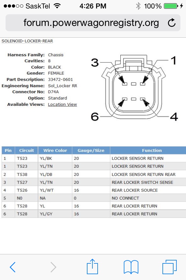

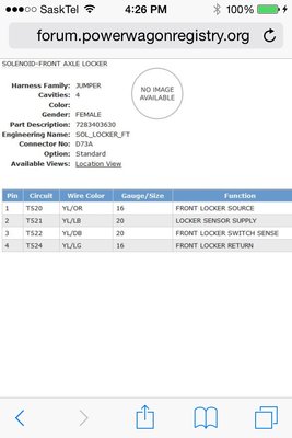

Well I did find these on the forum mentioned for a 2015...

The pictures you found correspond to what I found as well. So the rear is a new 6 pin connector and the front is still the same 4 pin. The wire colors look like they still match. If you decide to hardwire, don't cut your harness, the connectors are available on Ebay. Here's the front four pin connector and here's the rear six pin connector.
If you got these blank connector plugs, you could make waterproof caps for your O.E. harness connectors and tie them up to the frame for safe keeping. You would also need this type of terminal crimper plier. You could even make a tee harness with diodes if you wanted to (right Reloaderguy?). The benefit that I see to hardwiring is that you're never at the mercy of a faulty SmartBar while you're out on the trail. The weakest link then becomes the actuator inside the diff. Also there's no restriction to transfer case range or speed limit.
Good luck with whatever route you decide to take (OE repair, hardwire or elusive bypass). :patriot:
