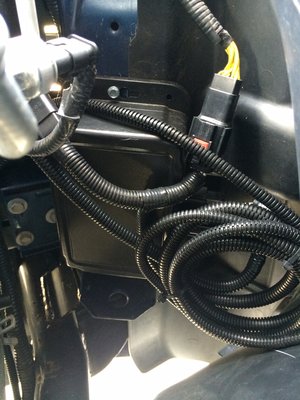

The first pic is where you have yours mounted notice the ground wire and the metal line. I mounted the box on the post to the right of the radiator right below where the Tee part of your kit plugs in. I have to neaten up the extra cable I coiled it up quickly to test the locker bypass out. I've used the lockers a few more times just checking out how quick they lock. I am very impressed this is how it should have been from the factory very quick. Thanks again. Now we need a decal/rear window sticker Myoung Locker bypass :idea:

That's very interesting. Is your truck a Laramie by chance? I know the Laramies have separate driver and passenger HVAC, maybe that's the reason for the difference?
TrueBlue13PW
Posts: 188
Re: Hardwired Lockers with OEM Knob
Post by TrueBlue13PW » Mon Apr 21, 2014 3:33 pm
myoung84 wrote:That's very interesting. Is your truck a Laramie by chance? I know the Laramies have separate driver and passenger HVAC, maybe that's the reason for the difference?
No it is a SLT level. I'm not sure what that line is didn't really look it over too much was just trying to get the locker bypass installed. When I get time I'll go look it over and see what that line goes to. I'm curious have any other 2013 owners installed your kit yet?

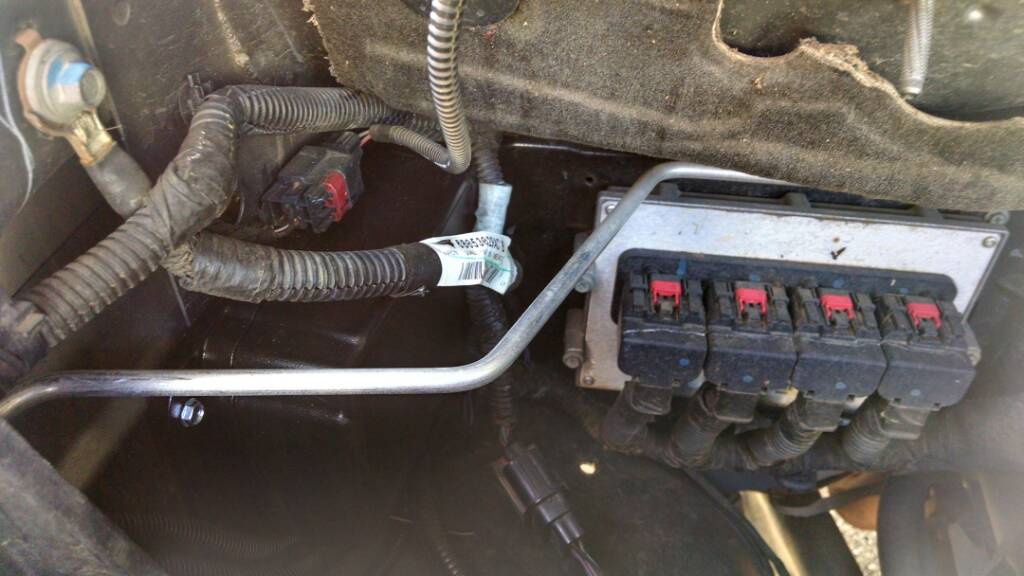

Post by Will » Mon Apr 21, 2014 3:36 pm
My 2010 has the same things, it'll fit under all of that. See next post for picture. The box is the clean black thing with the shiny screw in the top left corner :lol:
Post by Will » Mon Apr 21, 2014 3:37 pm
[attachment=-1]uploadfromtaptalk1398109042739.jpg[/attachment]

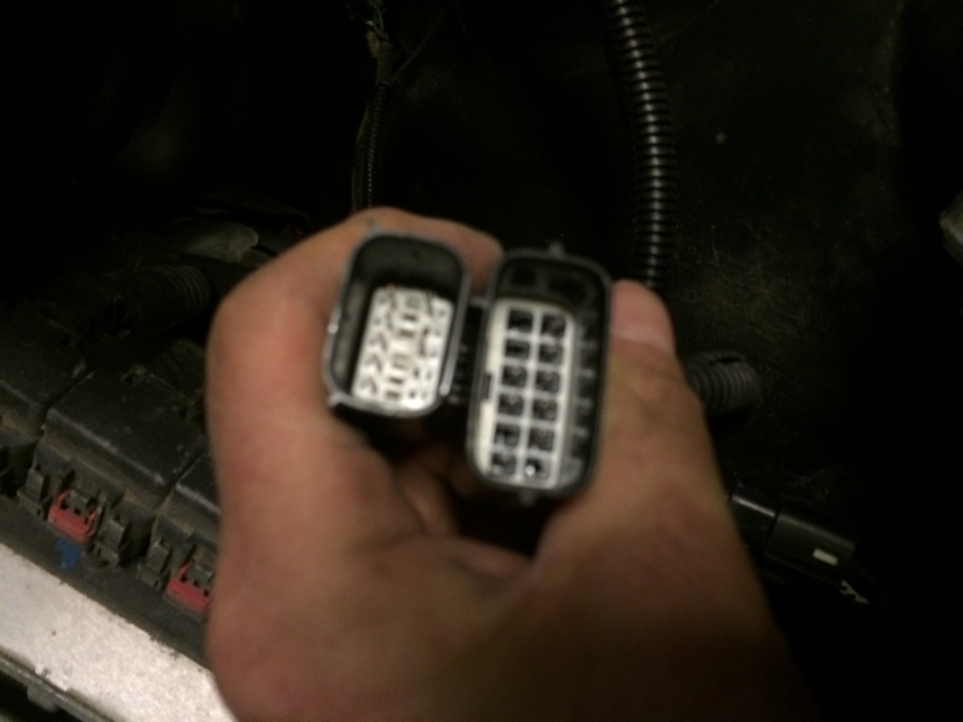

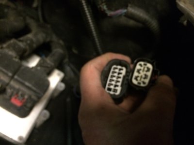

Post by Campy » Sat Apr 26, 2014 2:06 pm
Connectors do not fit. 2010 power wagon.
myoung84
Posts: 1475
Post by myoung84 » Sat Apr 26, 2014 2:36 pm
Crap. All my diagrams showed they were the same. Let me do some digging and I'll get back to you.
myoung84
Posts: 1475
Post by myoung84 » Sat Apr 26, 2014 3:12 pm
I think you've got the wrong connector for the T-harness. I see the computer in the background and the connector your looking for is towards the front of the truck, behind the headlight on the passenger side of the truck under the hood to the right of the radiator. I'm showing that I've shipped to 4 other 2010s and haven't heard anything about the wrong connector.
Campy
Posts: 10
Joined: Sat Feb 02, 2013 9:52 am
Post by Campy » Sat Apr 26, 2014 5:03 pm
Duh I screwed up, sorry. Figured it out all installed and tested. One question, when I switch it to front and rear lockers both lights for the selections remain lit. Is this normal with this setup. I know on oem when you switch over to both lookers the rear locker lite goes out. Just wondering Otherwise this is a superb kit I recommend that everyone should have this on their trucks. Thanks again. Cheers. Campy
myoung84
Posts: 1475
Post by myoung84 » Sat Apr 26, 2014 5:05 pm
Excellent! I was hoping they didn't have some different connectors out there. That is normal operation for the lights. Glad everything is working!
