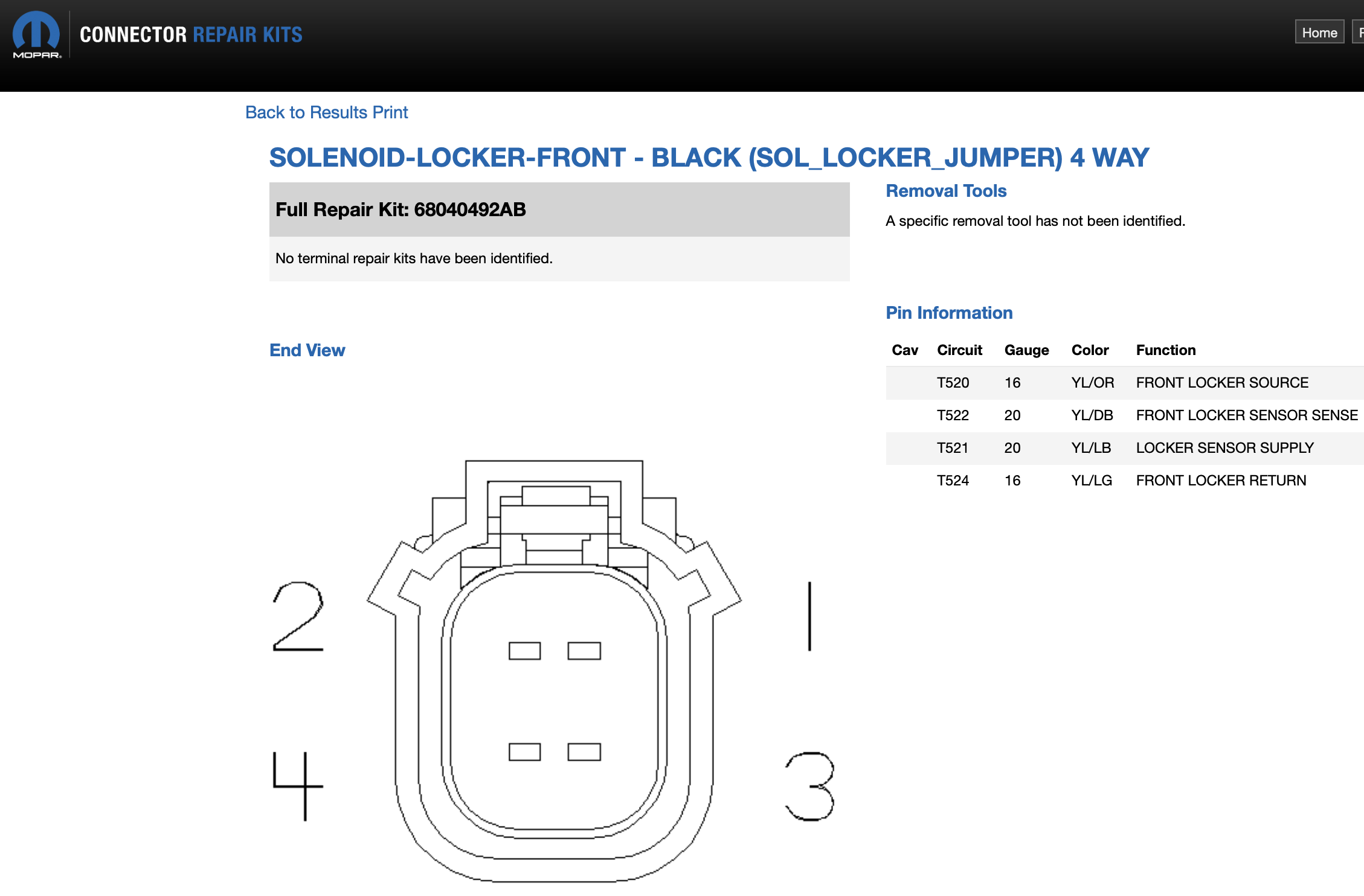

Stellantis changed the website for connector repair info, all the old website links are dead which include http://connectors.dcctools.com
Here's the new website link: https://connectorrepairkit.mopar.com
Enter the year and model, click "Find Now", scroll down to "Solenoid-Locker-Front" and click on that link.
The picture is looking at the face of the connector.
Pin #1 is Yel/Org = 12V+ for the solenoid electromagnet.
Pin #2 is Yel/Dk Blu = Front locker sensor signal return back to the SmartBar.
Pin #3 is Yel/ Lt Blu = Front locker sensor supply. This is a 5V reference signal for the sensor, with the key on your multimeter will read 5V+.
Pin #4 is Yel/Lt Grn = 12V- for the solenoid electromagnet.
I hope this helps. Happy New Year!
