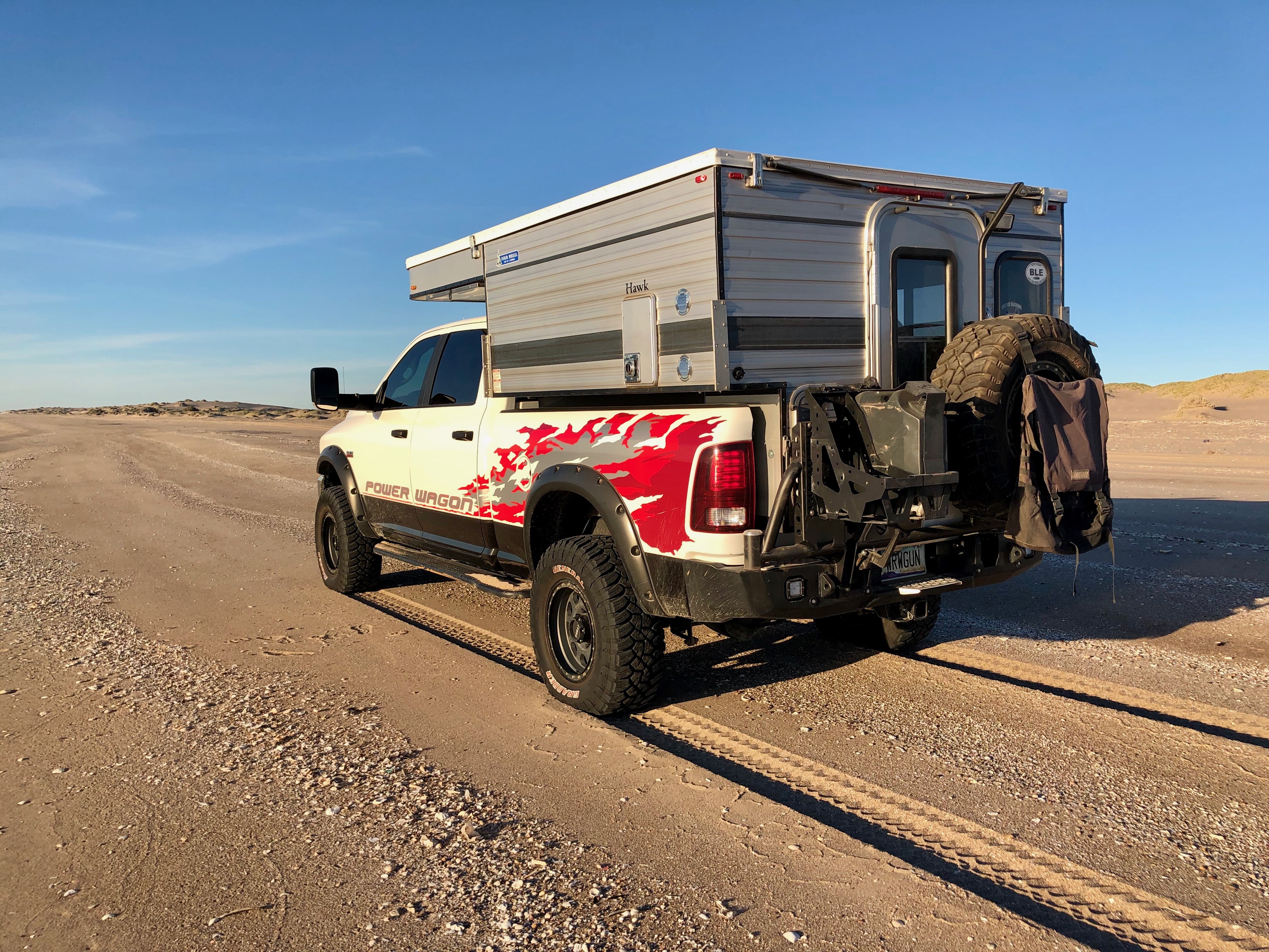

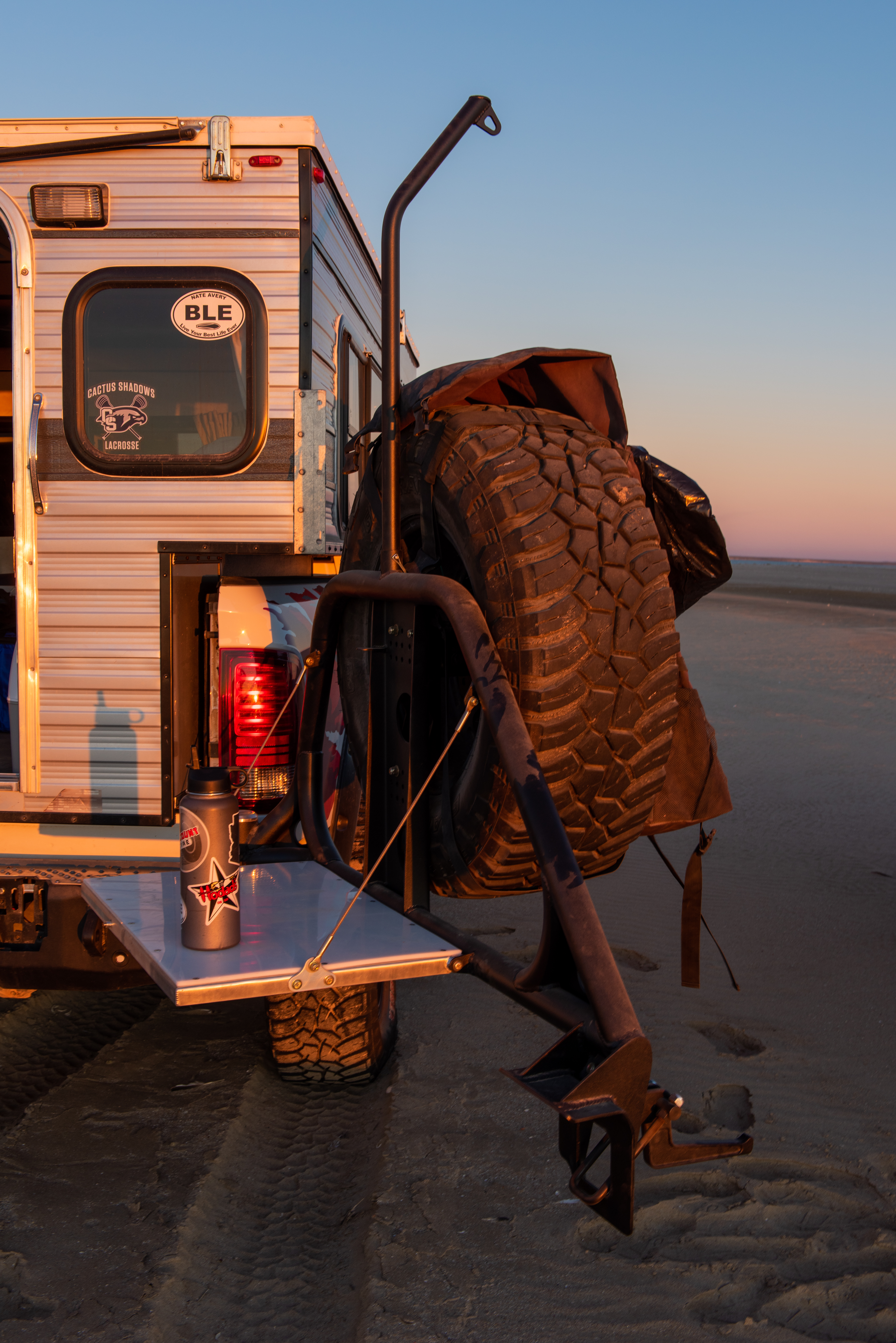

The company was very dishonest about many things including lead times (some guys gave up after 14+ weeks), Park Assist (forget it, they'll never work) and latch operation. The latter was really the deal breaker for me. Countless times they would jam, and you could not get them to release. Not the end of the world if your bed is open, but I had a shell on mine at the time, with gear, fridge and sleeping inside. Not good.
When I got the FWC, I had to have new arms made anyway. The fabricator, Rob Bonney just chuckled at the use of the slam latches. This is what he came up with which took some work to make a turd into a functional piece.
I might add that the side corners will give little to no protection from anything major off-road, like coming off a sandstone shelf in UT. But whatever.
'16 with '17 FWC
Oilbrnr
Posts: 164
Re: 37
Post by Oilbrnr » Fri Feb 21, 2020 11:49 pm
Klien 6,000 lb. latch seen here. Only one needed for both swings.
Oh, and the limit pins would never drop, so care had to be taken that the arms wouldn't continue unabated on around with 110 pounds of tire/wheel or liquid into the bedside. There was no welded hard-stop.
