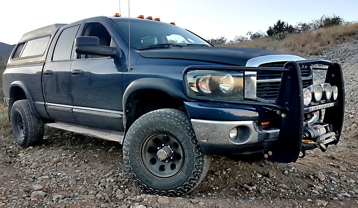

After two warranty replacements and three attempts to balance a set of Continental tires I decide to get new wheels and tires. Cooper AT3 XLT's and a set of American racing AR172, black. So far without adjusting the air perssure they ride nice, will do a chalk test tomorrow to find the ultimate pressure for my truck when unloaded.

They look great. Hope they work out for you better than the Conti's did.

They do look good! But my real concern is how well they stand up to the torque of this diesel and my off pavement excursions for search and rescue. As you can see with all the Arizona pinstripes on the side of my truck this is no pavement queen.

They are E & 10 ply, but god concerns for sure. Keep us posted on your thoughts & good luck w them!

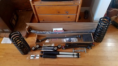

OK, shop tried alignment, could not get within specs. Caster still way to low! Time for all new components. Carli leveling kit (springs, shocks, sway bar links), new Thuren control arms (+1/2" longer) and Synergy steering kit (drag link and tie rod).
I had already installed a Carli track bar and Carli ball joints.
SOOOOO, should steer better than new when done.

Re: New rims and tires
Let the fun begin!

The longer Thuren arms don’t require changing anything else. The tires will clear the wheel wells better now and new joints are probably what will let you get on caster spec. The longer arms don’t require changing... stance? Unless you feel like some 20-wides and some panty dropping offsets.
I was refering to the factory, rear-high attitude. I can't tell from his pic if the truck is level, low in the rear, etc. I can't imagine .5" longer Thuren arms (same as my Carli set) throwing it out of spec unless the rear is really low, tipping the front axle back. That would have to be WAY low!. But I like the way my Thuren shackles freed up the rear springs. That was my main point.

There is a level kit on the truck now. I think that's what giving me grief so everything should just bolt right up and be the same. Possibly a bit lower in the front than now which would be ok with me.

Well, I blasted the front driveline bolts with penetrating oil, may be should hit those arm bolts too. I"m waiting on a long t40 bit for the driveline bolts. Thuren did provide new bolts for the rear of the upper arms.
