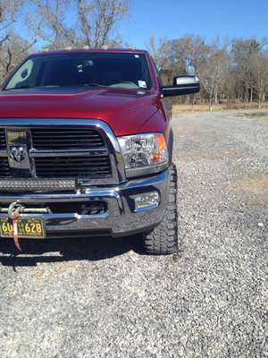

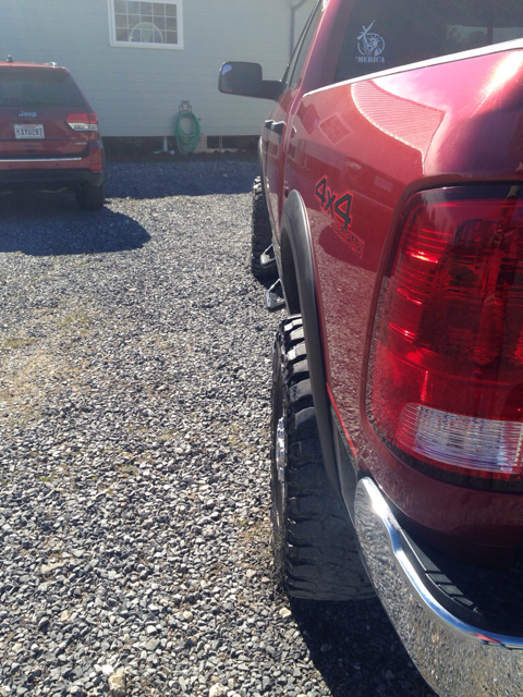

Put a set of 1.5" billet wheel spacers on my 2012 and it looks great! I've always hated how far the tires stick inside the fender flares on these trucks, and this fixed it perfectly. It got my tires away from the control arms, and now they barely rub the lower plastic fender liner at full lock. They're model specific, with the metric studs and lugs. I had to trim about 1/8" off of my factory studs so the wheel wouldn't hit them, but not even to the threads.

Looks good. I'm wanting to get offset wheels that have just a tad of tire sticking out of the wheel wells, but then I don't think I'll ever be able to flex without the sound of crunching plastic and possibly metal. :(

Plan on some other flares, rock dings and mud and what not will now be thrown all over the sides. Looks better tho. I just went to 35x12.5 all stock and rub a bit but already hate the fling they added so I can only imagine another 1.5"

I've had em on for two weeks now, they're not bad.

autogateman wrote:Put a set of 1.5" billet wheel spacers on my 2012 and it looks great! I've always hated how far the tires stick inside the fender flares on these trucks, and this fixed it perfectly. It got my tires away from the control arms, and now they barely rub the lower plastic fender liner at full lock. They're model specific, with the metric studs and lugs. I had to trim about 1/8" off of my factory studs so the wheel wouldn't hit them, but not even to the threads.
What size tires are you running? Have you fully articulated? Have your tires rubbed the fenders because they stick out further?

35 1250 17 federal Mt. If I cross a ditch at the exact right angle and stuff the tire it rubs the inner fender well. it can easily be pulled back but wasn't enough for me to worry about.
