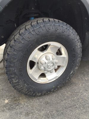

Well over the weekend I said goodbye to my stock BFG's with 28,000 miles and put some new Toyo Open Country A/T II's in a 285/75/17 on my truck. Road noise on the interstate is less than the BFG's, and according to my GPS my speedometer reads about 1mph slower than what I'm actually going when I set the cruise control at 80mph. I haven't had any off road experience yet, but I towed the family boat about 220 miles on Saturday in rain, snow, and dry pavement and they did really well. The real test will be spring bear hunting on forest service roads that like to turn to clay when it rains, but by the looks of the tread I think in the winter they will do the job for me.

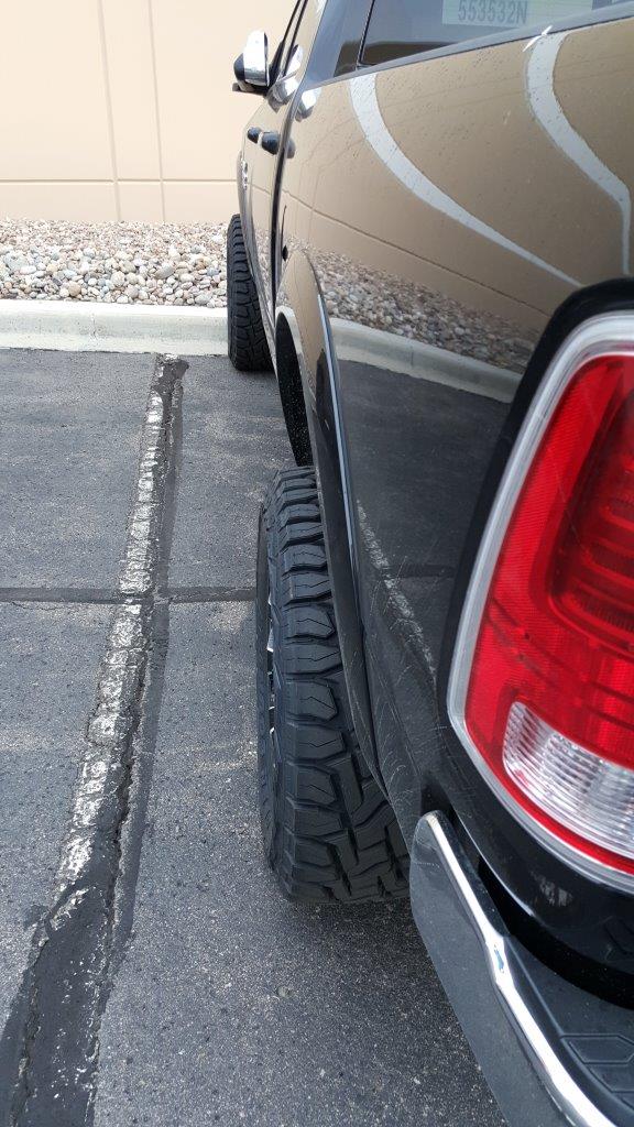

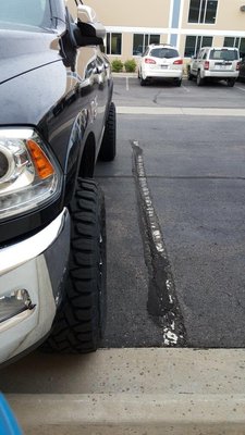

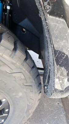

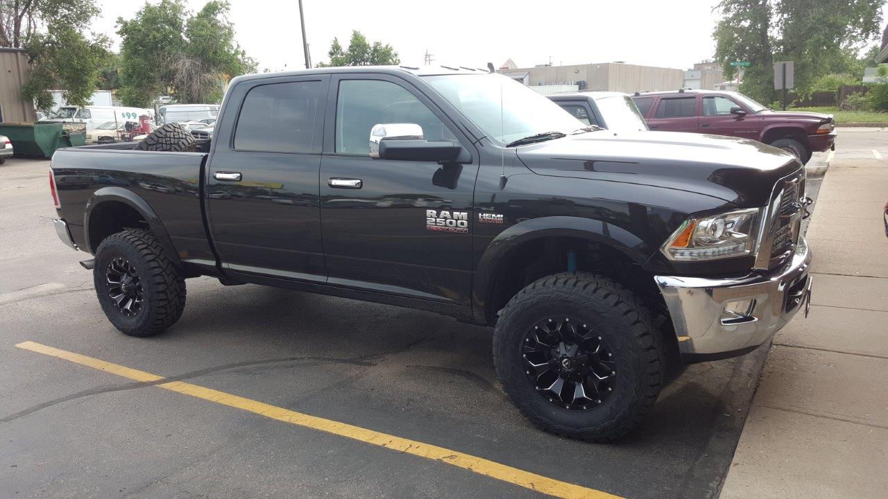

I just got new wheels and tires for my 2015 PW. I had Toyo Open Country RT tires (35X12.5R18LT) and Fuel Assault 18" wheels with an 01 offset (5.000 in) put on. I worked with Chris and Tim at High Country Performance 4X4 in Denver to pick them out. Both had experience with Power Wagons and were very knowledgeable. Tim actually had a 2014 PW that he just traded in. The new tires and wheels fit without rubbing, but it is kinda close to the wheel wells, I may rub if I bottom out while turning. I might need to trim some of the plastic back.
I am pretty happy so far, but I only have 20 miles on them. I haven't noticed any road noise and the ride seems great.
I am including some before and after pictures for anyone that is interested.

Looks good. Is the backspacing 5 inches? What is the total width of the wheel?
Re: Tire Feedback
The wheels are 9 inches wide and have a 5 inch backspace.
Re: Tire Feedback
Nice. Any chance on some pictures looking down the side from the front and rear? Thanks again for the quick response!V3rt wrote:The wheels are 9 inches wide and have a 5 inch backspace.

They shouldn't touch, especially with 35's, the closest points are actually when the wheels are straight. The plastic inside the well can easily be pulled back, you can take your hand and push them in about 2" which is more than enough. Looks good.V3rt wrote:The new tires and wheels fit without rubbing, but it is kinda close to the wheel wells, I may rub if I bottom out while turning. I might need to trim some of the plastic back.

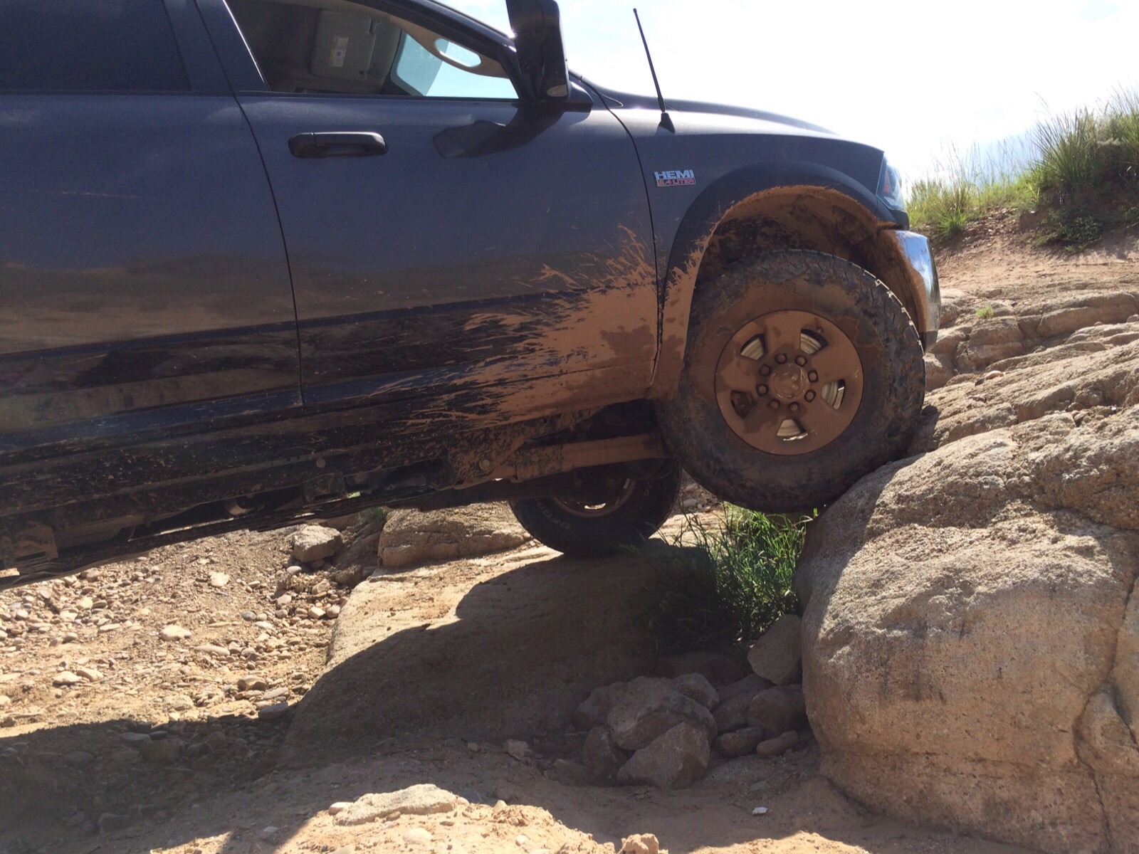

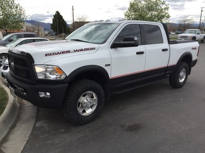

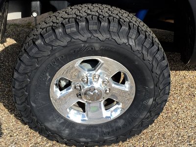

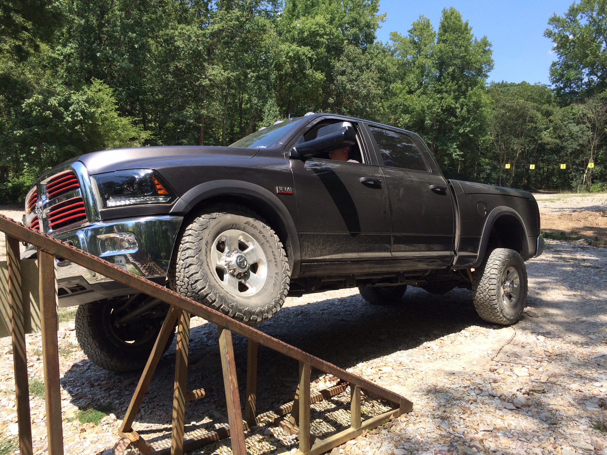

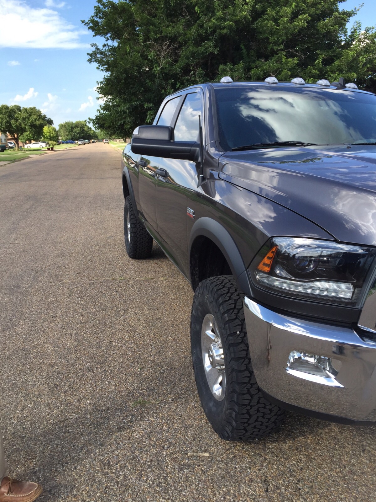

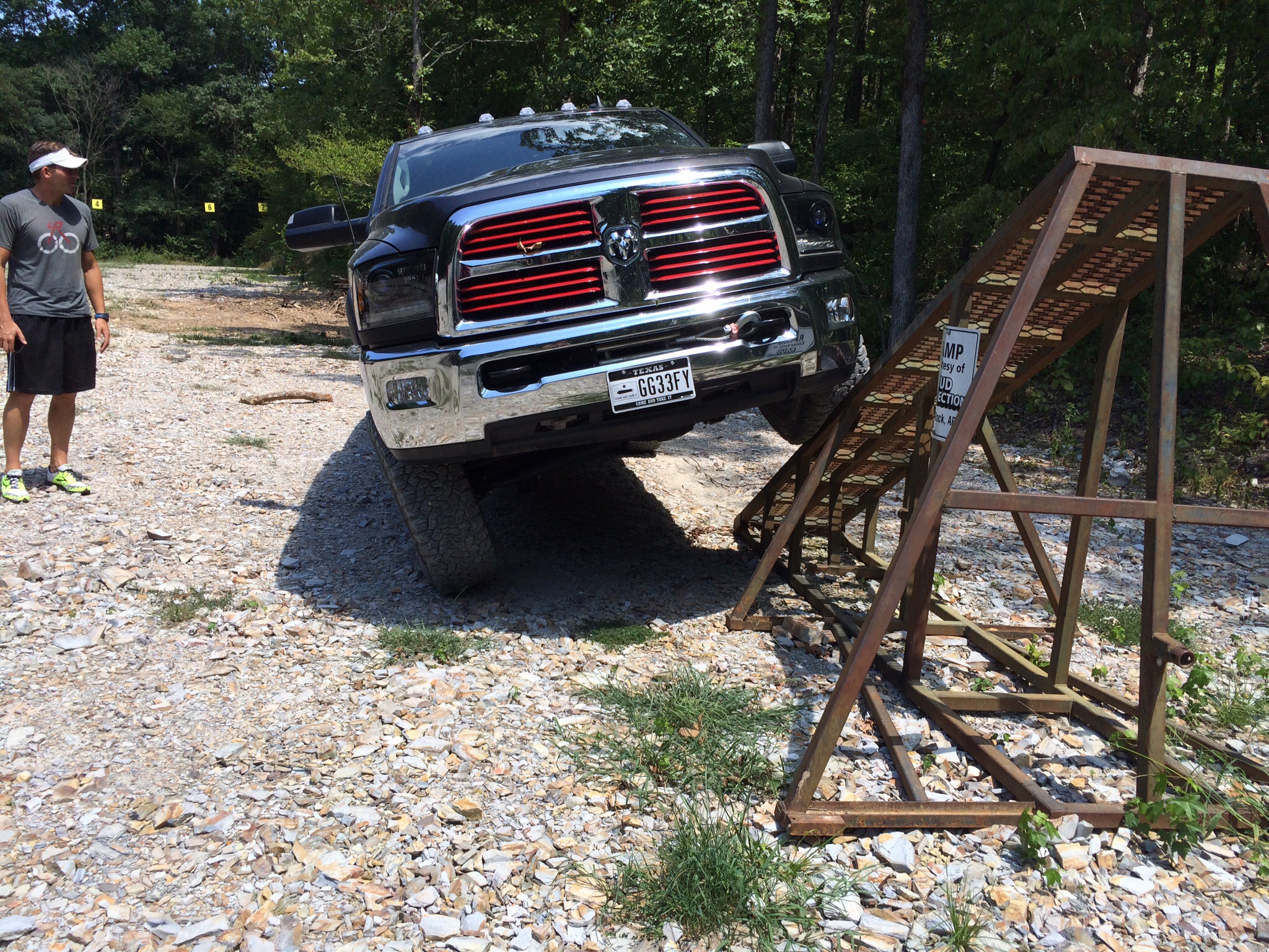

35"x12.50" BFG K02
No Rubbing at full lock or while fully articulated.
No lift.
I want 37's now and by the looks of things I don't think I'll rub much if I stick with the BFG's...
Thoughts?
Does the 2015 hve different control arms then the rest of the 4gs?
No lift.
Thoughts?

Some tires have a smaller actual center section than others (actual measurement) and I think those BFG KO2 are one of them. Measure the tread width and see if it's an actual 12.50 or it's smaller, I'd bet it's smaller and that's where you're gaining your clearance.
