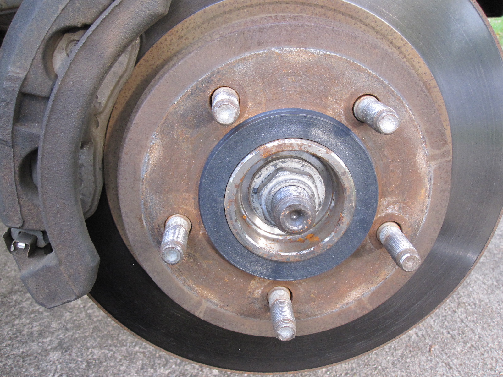

Question for those running aftermarket wheels. I was looking into get a set of XD addict 2s. I noticed they have a hub bore of 125 and our trucks have a hub dia of 120.9. was just wondering if any of you guys had hubcentric rings installed to make up that 4mm difference? Doing the math its roughly 1/16" of an inch space on a side for clearance which seem a little much.

I have the centering rings for my aftermarket wheels on my Ram 1500. The ones I have are a nylon composite material, which is fine because they won't galvanically corrode to the wheel. I have push-through center caps, so the rings I have are sized for the cap bore (106mm) and not the wheel bore (108mm).
I recommend them for anyone using aftermarket wheels to maintain the better wheel-centering of a hub-centric fit.

I had them on my Ram as well but it was a significant more space between the bore and hub than on my wagon. I would guess I would need someone to make a custom ring and even then a .062" walled ring probably won't be necessary
