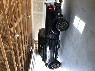

The process is rather easy and very forgiving if you make an oops. I have done several vehicles and wheel sets in the past few years. The feature I like is when I get tired of them I can just peel it off like vinyl and be back to stock.
Use 1 can of black plasti dip per wheel
Use 1 can of gold plasti dip metalizer for the bronze
Use index cards to line between wheel and tire
Use plastic bags or tape n drape to cover brakes/rotors
Key is plenty of thin coats, minimum 8 coats to ensure it’s easy to remove when the time comes.
