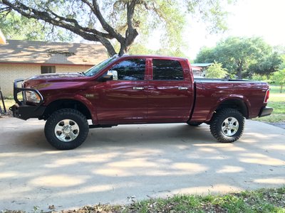

Today I had new Toyo AT2 305/70/17 load range E installed on my 15' Wagon. I love these tires and I'm thrilled to say goodbye to my Durashakes. I've had the Goodyears balanced twice and the truck would shake in the 65-70mph range. The new Toyo's are smooth at all speeds and honestly the truck handles much better with less wandering.
Since I took delivery of my Wagon last July I was disappointed in it's road manners compared to my previous 10' Ram 2500, which had 285/75/17 Toyo AT2's when I traded it. I wasn't sure if it was the new front suspension setup of radius arm vs. control arms but I can now honestly say it was the factory Duratracs. Going from the load range D Duratrac with a notoriously weak sidewall to the E range Toyo makes a big difference.
The Toyo's are also quieter and smoother than my Duratrac's with 13,000 miles on them. I did purchase a 5th tire for the spare. With the spare inflated to 65psi it just squeezed into the stock location but it fit.
I'll get some pic's tomorrow cause I know, my words are useless without pic's.

Post by Ed1774 » Sun May 15, 2016 4:39 pm

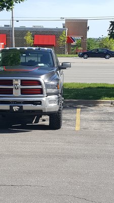

As I promised, a picture of the 305's.

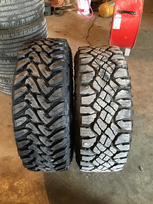

I had 35 x 12.50 R17's Toyo Open Country R/T put on my factory 15 SLT today. Little to no road noise, especially compared to the DuraShakes. I'll update as I put more miles on them. No rub on either side at full lock. Might rub a bit at full stuff with full/near full lock. Looks awesome without being overbearing. Went with these because their actual width measures 12.5 inches (open country m/t and trail grapps come in around 13.2 in this size). I was also worried about road noise with an mt. I ran trail grapplers on my old truck and the noise didn't bother me too much, but it was a half ton.
I got 37,500 miles out of the shakes, and could have eeked out 5-10k more. They were starting to chunk a bit and the wearing slightly unevenly (rotated every oil change). Performed very well in every condition I had them in (mud, snow, ice, rocks), other than highway. OK on highway, but for that level of tread aggression (moderate), they were incredibly shaky (had them balanced 3 times in the first week) and loud. I wouldn't buy them again, but I can see why guys like them.
Not expecting anything miraculous out of these, but with the level of tread aggression, good width for factory rims/stance, and a 45,000 mile tread life warranty, should end up happy. Unless they blow off road.

If you want a pic from a certain angle, wheels at full turn, etc., let me know. Here's a couple I took today.

Looks really good!

Wow that looks awesome! notice any difference in response/braking/mpg?

Thanks fellas. Guys at the shop were drooling over it (sales guy with a non pw 2500 actually took my old tires).
Only drove it from 4wp to the house, so not a big frame of reference, and I was driving into a significant headwind. That being said, didn't notice any difference in acceleration or braking.
Haven't had the speedometer recalibrated yet. For 4wp to do it, I had to buy the unit. Will get it to a dealer and have it done soon.
I'll put quite a few miles on it this week and will let you know if I notice a change in performance.

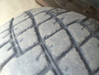

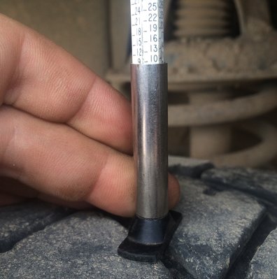

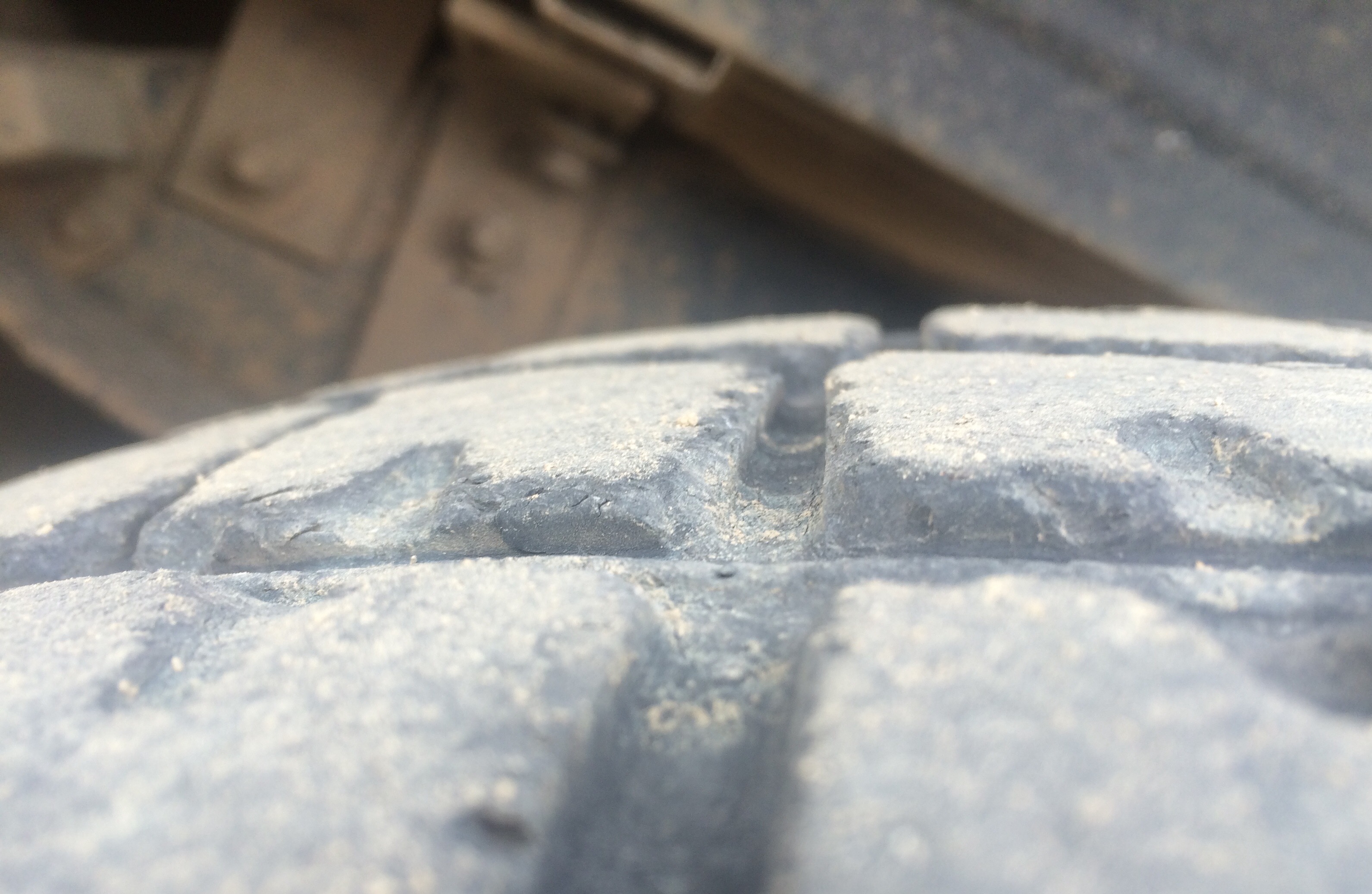

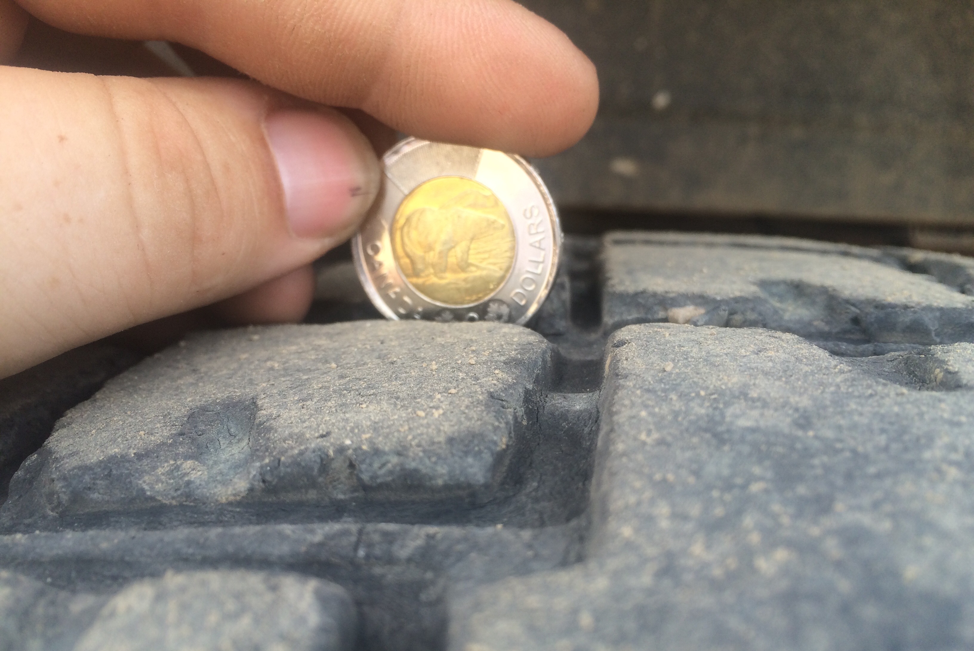

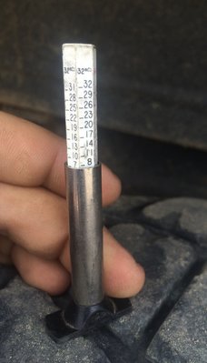

Post by nts007 » Wed Jul 20, 2016 1:22 pm
I have an update on the general grabbers in 35"
They have been going strong!! They spend half their life on gravel and half on highway. Tow about 25% of that.
They are wearing AMAZING!!
There is now 137,000km on them. The fronts are at 9/32 and the backs are 8/32 tread. Measured at their shallowest point. This is ridiculous. But no complaints. They are mounted on an 02 2500 Cummings for reference. Have been for most of their life now. Here's some pics
