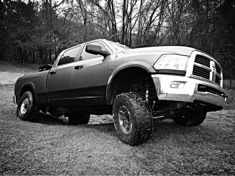

I run 315/70/17 (35") tires on my 2011 with no lift or other suspension mods. The only rubbing I have is on the control arms when turning tight. I posted a full write up on here about 2-3 months ago. It seems like some 4G's will have major rubbing problems with some 35" tires but not with others.

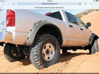

40x12.5/17 stock pw rims

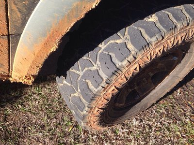

I run 35's on my 4th gen. Slight rub at full turn but free and clear anywhere else. Fierce MT, mounted and balanced less than $290 per tire. Currently have 55K miles on them...
Biggest tires on stock rims
DB...
Re: Biggest tires on stock rims
Stock rims and they have worn perfectly. Still not quite down to the replace em bars between the tread.

Any idea who supplied those flares?40x12.5/17 stock pw rims
I believe they are bushwackers
Might be, but I don't think so. Bolt pattern looks slightly different from the pics on the Bushwackers website, and the pics on that site show a rubber molding/gasket between the outside edge of the flare and the sheet metal. I don't see that molding on the one pictured earlier in this thread. I'm looking for a set of real pocket flares that bolt through the sheet metal (yes, I'm willing to drill my fenders) and all Bushwacker shows is "pocket-style" flares. I might be able to use real bolts on the Bushwackers, but I don't want to have to cut a bunch of crush sleeves to fit behind the flares before I bolt through the fenders. We used to be able to buy real pocket flares, but I have not seen any in years.I believe they are bushwackers
They're cut out Bushwackers for a Ford. Mopar did all sorts of molding to get them to fit right and even then they didn't fit entirely that well. There was a guy on another forum that started doing it himself, I never saw the end product but the amount of time he was putting into was insane, you're talking hours upon hours with a heat gun hand shaping the flares...cool idea but for what those bad boys cost to much of a chance of messing them up for me.Ducky's Dad wrote:Might be, but I don't think so. Bolt pattern looks slightly different from the pics on the Bushwackers website, and the pics on that site show a rubber molding/gasket between the outside edge of the flare and the sheet metal. I don't see that molding on the one pictured earlier in this thread. I'm looking for a set of real pocket flares that bolt through the sheet metal (yes, I'm willing to drill my fenders) and all Bushwacker shows is "pocket-style" flares. I might be able to use real bolts on the Bushwackers, but I don't want to have to cut a bunch of crush sleeves to fit behind the flares before I bolt through the fenders. We used to be able to buy real pocket flares, but I have not seen any in years.I believe they are bushwackers
Yeah, no real flares other than the Dodge 4500/5500 series flares but I can only locate front flares, no rears since they're dually i guess. It'd be perfect if they had rear ones.
