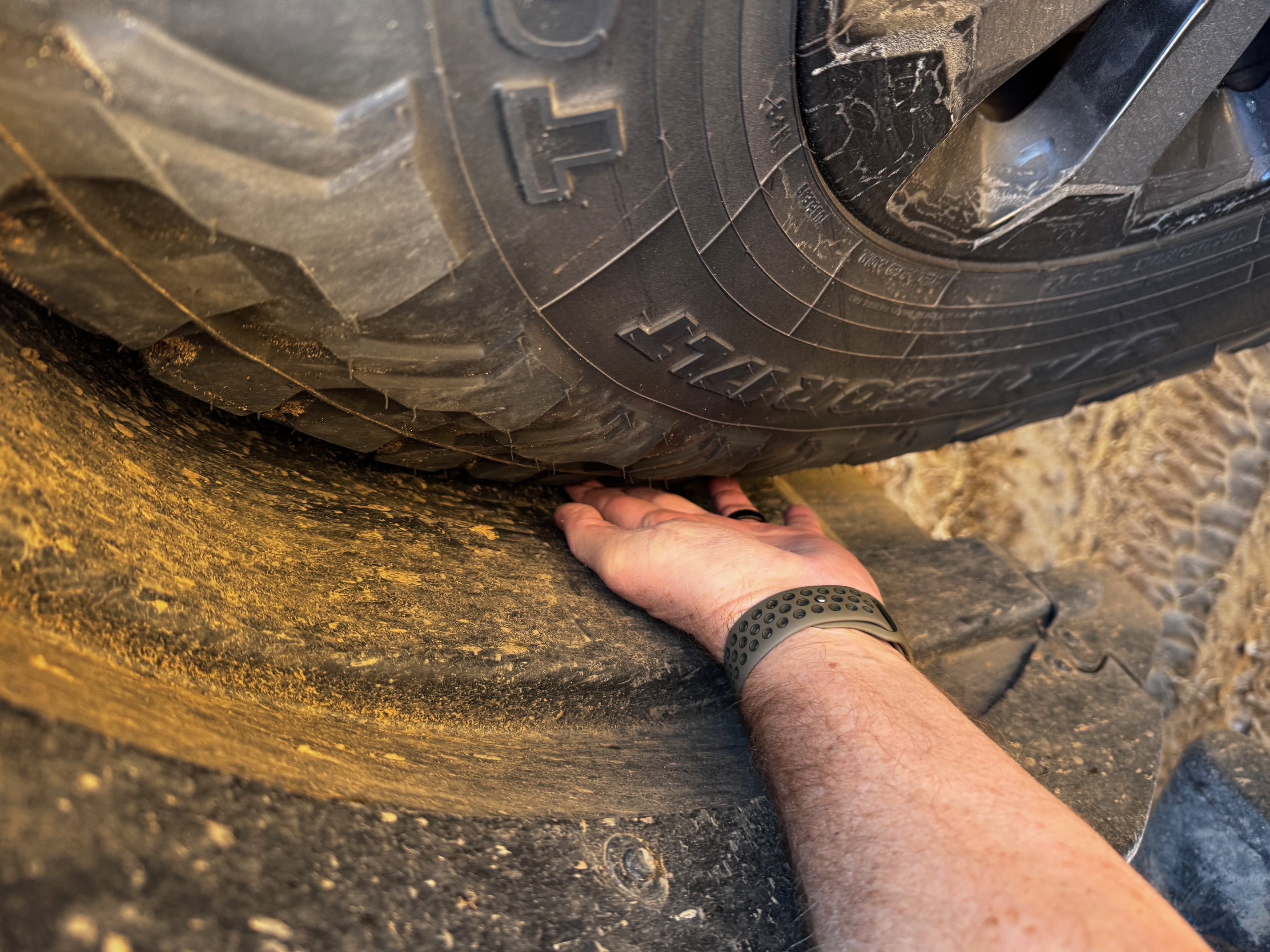

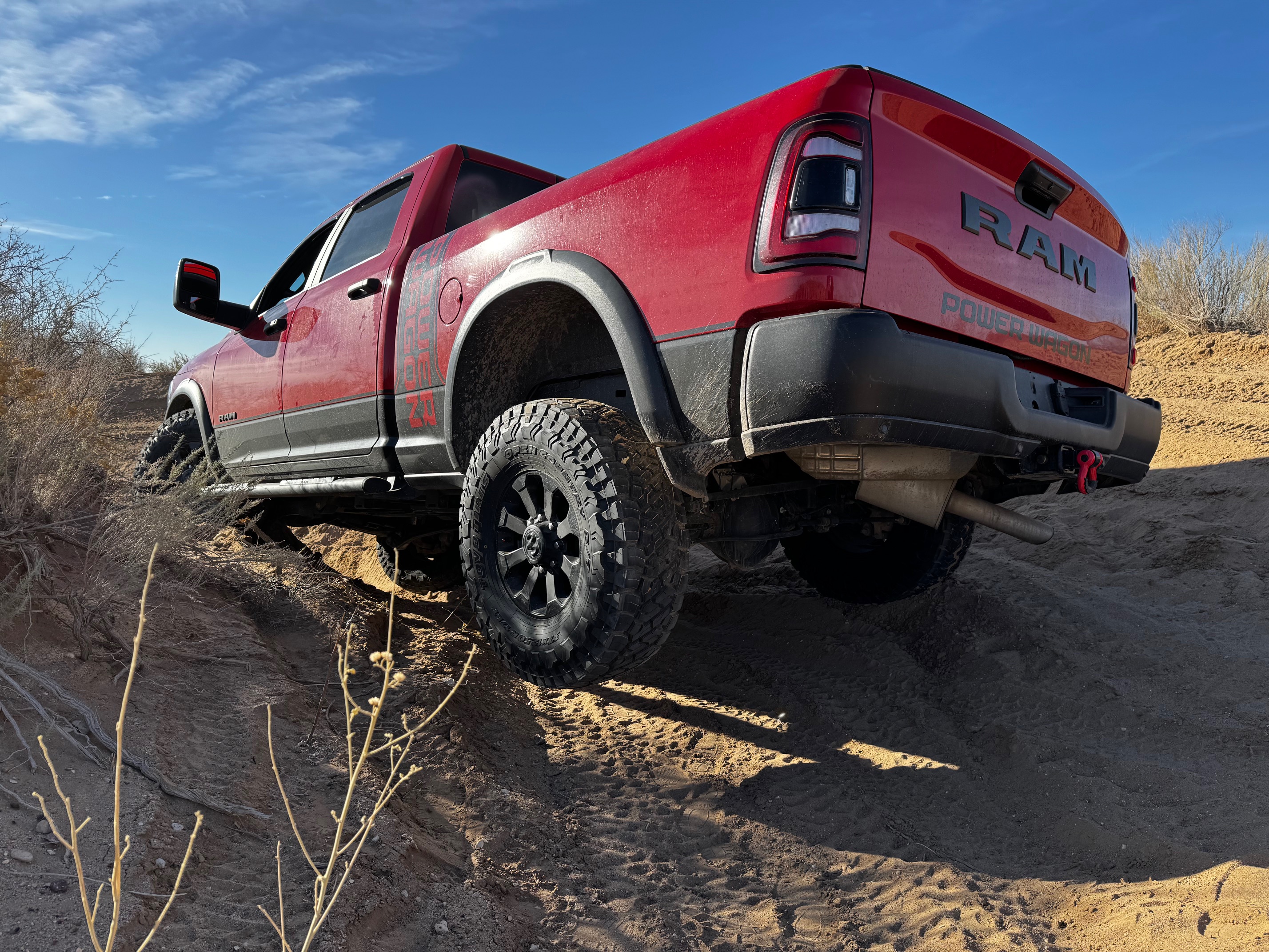

Got 37" Toyo Open Country R/T Trail meats put on my 2023 PW with no lift or leveling kit. Did a quick ride out to the desert with SilverWagon05 to get maximum stuff into the wheel well to check clearance and rubbing. There's a tiny bit of rubbing on the control arms and sway bar at full stuff, full lock, pushing into a hill. I can live with that as both are smooth and rounded parts and a little missing paint isn't gonna kill me. At full stuff and push, it is really close to the plastic wheel well lining, but it doesn't touch.
Only problem now is I need to come up with a mounting solution for my spare which doesn't take up the whole bed, is secure and doesn't require me to relocate my reverse camera or sensors.
