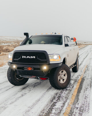

Oh right, I haven't posted in a zillion years.
Yeah I've been running them since 2020.
- Posts: 2165
Re: 39s no lift
Damn, beautiful!! So my PW trained eyes
sees a high clearance bumper set, front truss, AEV wheels to get proper backspacing for the 39’s, Thuren (or DOR) front track bar & PSC high mount steering stabilizer, not sure about coils or shocks but I see a SS braided line left of the diff, and a painted or front differential guard. Did you keep the stock disconnecting sway bar?

Those are the regular AEV (17x8.5) wheels, I had these long before the 39's. Those are BFG's KM3's (on purpose0 I cannot believe I haven't updated my thread since 2018. Kinda wild.adeluca73 wrote: ↑Fri Mar 28, 2025 11:55 amDamn, beautiful!! So my PW trained eyessees a high clearance bumper set, front truss, AEV wheels to get proper backspacing for the 39’s, Thuren (or DOR) front track bar & PSC high mount steering stabilizer, not sure about coils or shocks but I see a SS braided line left of the diff, and a painted or front differential guard. Did you keep the stock disconnecting sway bar?
DOR won't touch my truck. I have all thuren stuff, most of the build thread is accurate there, with the addition of Synergy steering. I bent my draglink.
PSC really helps push tires around. But I got that when I still had 37's. MAKES A HUGE DIFFERENCE offroad in the rocks.
I have Abels bypass but my stock bar is going in the trash can this week.
Maybe I'll go update my thread when I have some more time.
