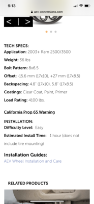

Not to toot AEV’s horn, but my opinion is they have a lot of R&D that goes into their products. And their wheels most likely are set at some of the best backspacing/offset for our trucks.
The 8.5” wide version (for 37’s) is a +27/5.8” setup, while the 10” wide version (for 40” tires) is a -15.6/4.8” setup.

+27mm
