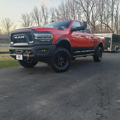

Just fit 35x12.5r17 Duratracs onto the factory wheels (I think the dealer put the 2020 black wheel on this 19 before I found it).
No rub anywhere I've been, but I haven't run it to full flex yet. Daily driving, gravel, tight turns, and slight bad road trail use has been perfect.
Also, I bent the heat shield a bit and fit a brand new ProComp 315/70r17 Xtreme MT2 on the factory spare wheel under the truck. Its inflated to 20 PSI, but I'll be damned if I could flex it at all anyway as it's a thick tire. I'll try again at 30lbs when the weather warms up. It tucks up nice and slightly higher than the bottom of the receiver hitch without issue. I'll run 3 safety cables around the tire to the frame etc in the event the factory tire winch cable breaks, but they will be easily cut with wire cutters should I need the tire.
I'm going to do more mods and physically move the heat shield and re-run a smaller exhaust tighter to the passenger side of the truck to improve clearance, but for no ti works just fine.

Looks sharp! Im pretty certain the flat black wheels were available as an option on the 2019s, I don’t think it is new for 2020.
I have the machined face wheels, and I’ve never been a fan of black wheels, so I kind of wonder how the stock wheels would look painted silver... but with the black bumpers, fenders, grille maybe black is the best fit.
