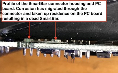

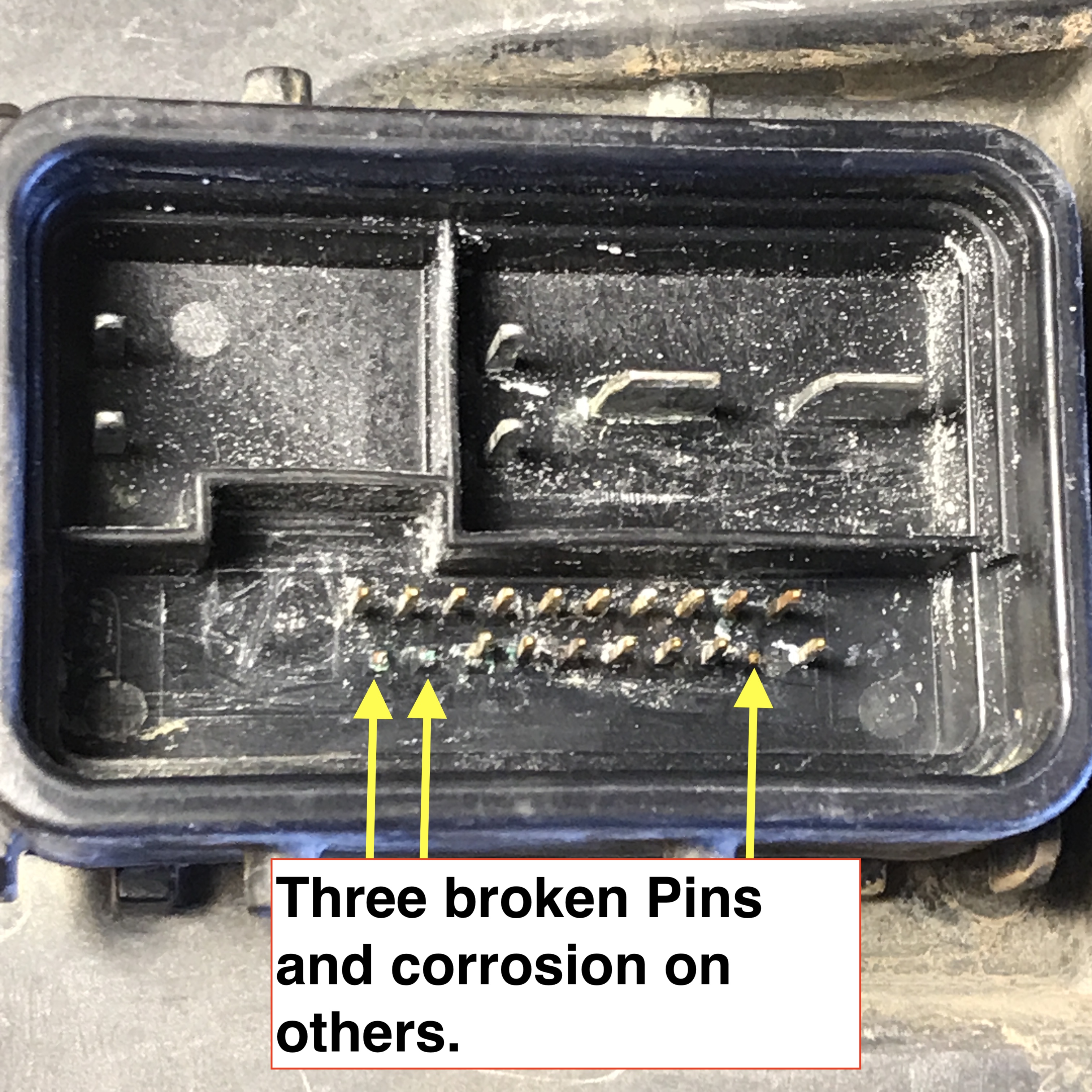

Here's a couple pictures from a recent autopsy of a SmartBar.
I built a Full SmartBar Bypass that completely replaced this dead module and restored full function using the factory switches, which was a prototype for the new system I'm building.
