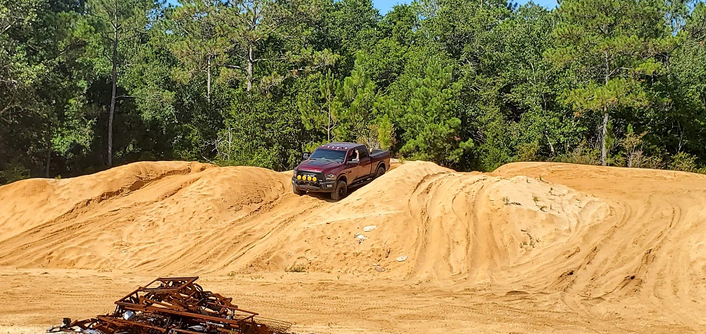

I have a 2018 PW and I noticed that when I am going up 20-30 ft sand dunes, the truck has a real problem with bouncing and hopping. Anyone know what this is and how to fix it? Is it the axles hopping? The more I press the gas the worse it gets to where the truck bucks like a horse.

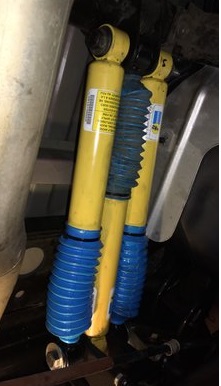

Others have added additional axle shocks which cuts the hop down significantly (but doesn't completely eliminate it in every scenario)
Run with your rear axle locked if you're on sand like in your picture

And - super loose sand may warrant very low tire pressures
