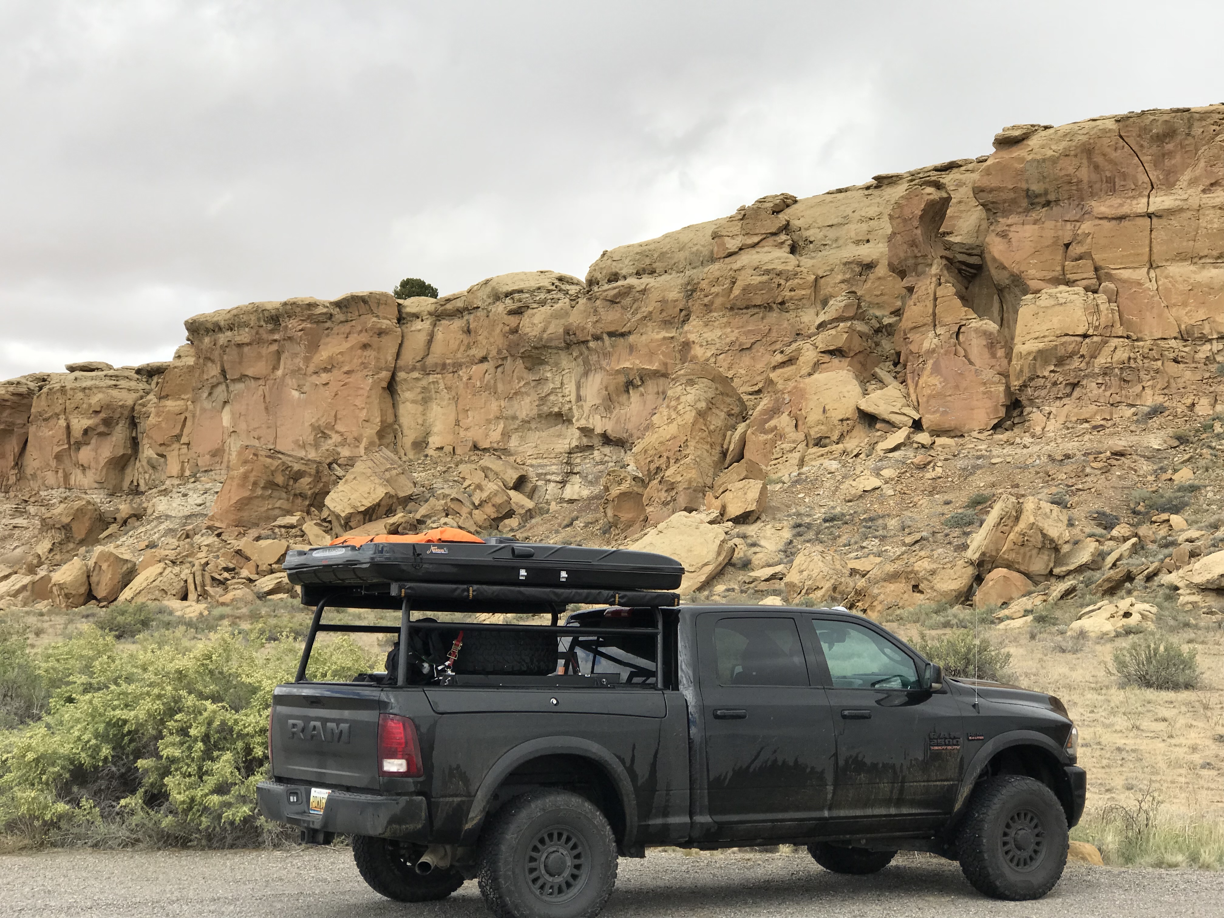

2018 PW with following mods:
- 35" K02 on AEV wheels
- JB roof top tent on Nuthouse Rack, ~230lbs total
- Coiling bed cover, ~50lbs?
- Spare Tire deck (above bed rails) and spare tire, ~150lbs?
I typically run tires ~60psi all the way around. New truck, so hadn't experimented much from where it was when I drove it off the lot. More on tire pressure in a bit.
We took our first big trip with this new rig fully-loaded, total from above ~430lbs and another ~400 in gear and family of 3 at 380, so call it about 1200lbs. On the way out West did not really notice any strange behavior - could tell the truck was heavy, but no real degradation in performance.
We did a multi-day off-road trip, I had dropped tire pressure to 20psi, locked diffs, and disconnected front bar. When we went back to highway, I aired up but decided to try 45psi front/rear instead of my normal ~60 to see if it improved the ride. Wasn't on highway for too long before we ended up doing ~40 miles out and back on some pretty rough washboard roads at 30-40 mph, still at 45psi.
Now back to highway driving and the trouble starts. The truck started to oscillate side to side in roll when at highway speed, moderate cornering. Primarily at turn-in or straightening out from turn - if it was a long, sweeping turn, the truck would settle into the turn after several seconds of oscillation. Sometimes if there was a bump in the corner, it would do it worse. Oscillation takes several seconds to subside.
At least twice the oscillations got so bad that the nannies kicked in and cut engine power, which freaked the hell out of wifey and little guy as it happened in a turn on the highway!
Given it is a bounce and happening in transient cornering conditions, my first thought went to a broken shock. There are no outward/visible signs of this - no oil, nothing bent/dented/broken that I can see. Perhaps the stock shocks just aren't capable of handling the increased weight/CG of my setup?
Next I though maybe the smart bar wasn't reconnected or was reconnected with preload / not straight. There is no misalignment and the light is not on, so the easy stuff is checked - but how do you actually know the bar is locked/connected?
Perhaps the tire pressure is too low now, and I'm getting uncontrolled sidewall movement?
The truck is back to "unloaded" state, which means the rack/tent/cover are still on but all the gear is out of bed and the spare, spare shelf are off. The behavior is much more muted, but it is still there. Certainly reduced enough that I don't think I could make the nannies come on if I tried, but in certain cornering conditions - especially a bump in the middle of a turn while cornering moderately at highway speeds - the truck is definitely still bouncing side-to-side in roll, behaving differently than it did pre-trip.
Anybody else ever run into something like this before? Any ideas on what to try next? I was thinking of going back to 60-65 psi in the tires, but every post I read on here would tell me that is way too much for my truck.

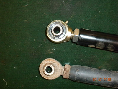

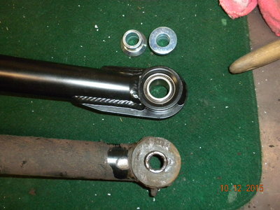

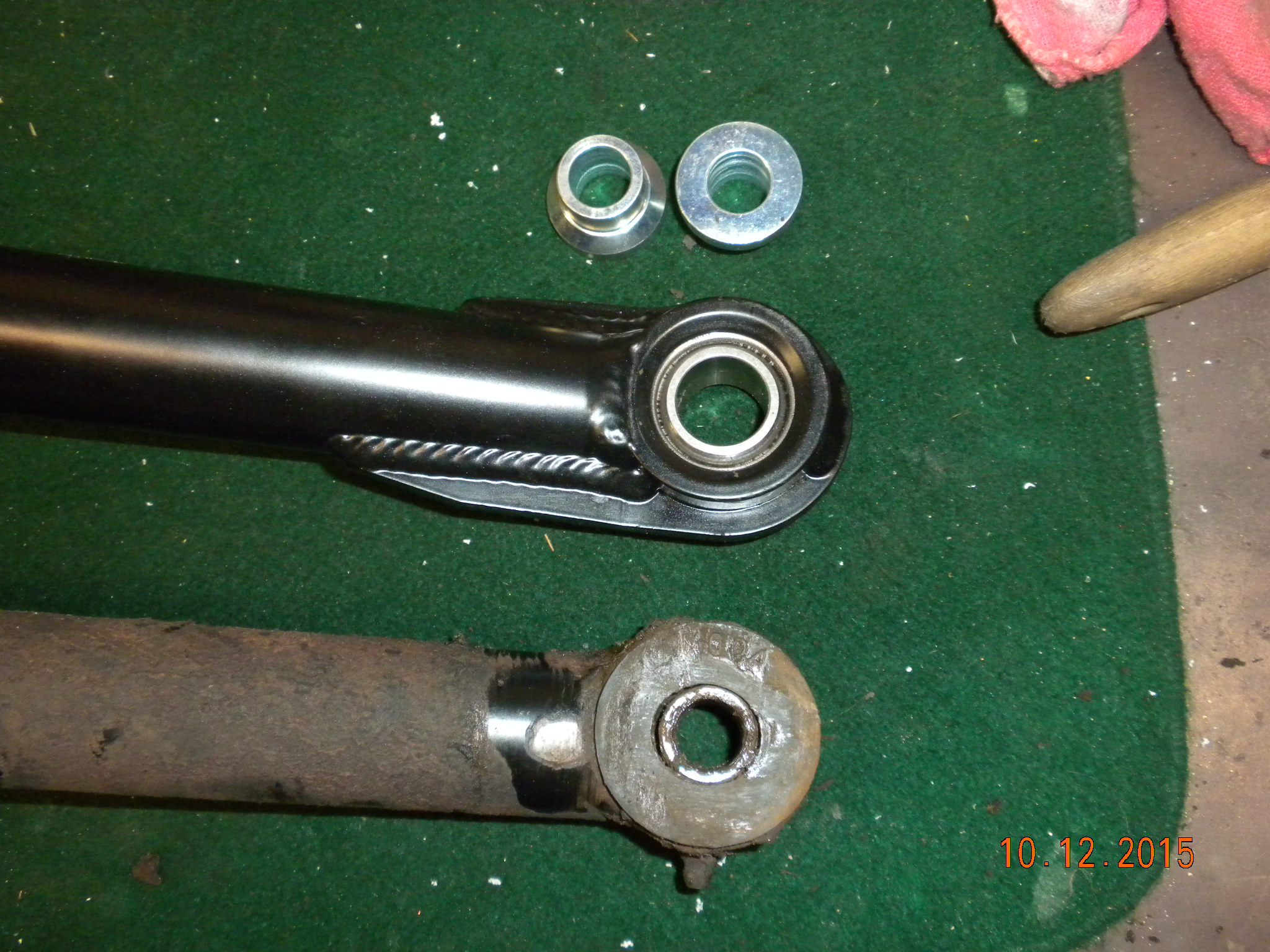

Couple of pic's.
In the pic's. The top bar is the 2nd gen Carli bar. The bottom bar is the 1st gen Carli bar.
Re: Bouncing Problemos
The current Carli bar has their new ‘CUB’ Captured Uniball Bearing. It’s captured in a poly housing.
I still have the bar in your first pic
Carli didn’t take kindly to me telling them I measured the housing at .035” out of round haha
