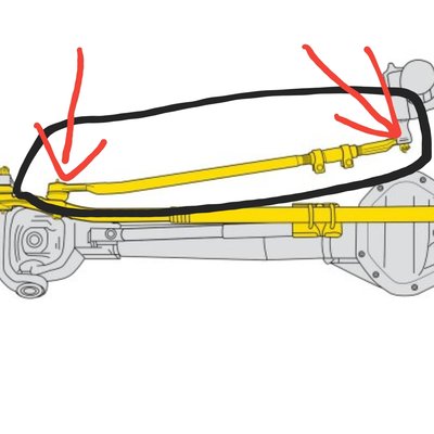

Found some slop in the joints at each arrow, I assume that's bad. Not sure what the bar is called, but I'm able rotate it up and back about an inch. Have not installed the track bar yet, wanted to see what everyone suggests.
Re: Thuren Track Bar
That is the drag link. What do you mean you can rotate it up and back an inch? Because it has spherical bearing sboth end you should be able to rotate that bar by hand about the joints. But if you have someone steer the truck, engine running, while you watch, if the joints ‘pop’ up and down then they’re worn

Yea, it will twist but didn't hear any popping.
- Posts: 94
You're fine there. Don't bother replacing it until you can see slop in them.
