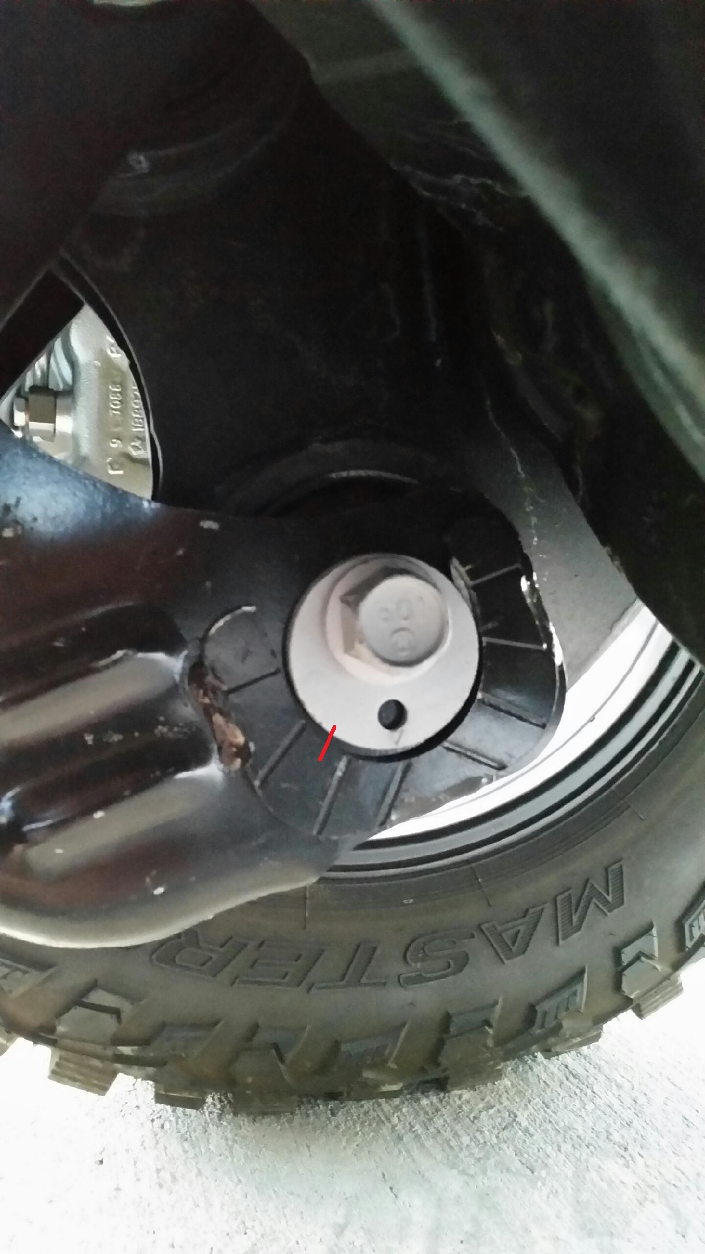

i got to looking at thos cams but im not sure how accurate the dial plate is. since its welded on, i guess its only as accurate as the jig it was fixed in when the assembly was welded. not to mention the accuracy of the marks on the plate itself when it was made. anyways heres what they looked like. now where close to 180* off but maybe far enough to cause my truck to lean a bit, mostly in the LR corner. i measured ground to fender well and also axle perch to bottom of bump stop. LR is 1/2" low. LF is about 1/4" low. ill do some more digging into this because i still cant see 1/2" being normal on new truck with virtually a empty payload. when looking at the tail gate and bumper from the rear it seems to have a definite lean to the driver side in the LR corner. maybe im over exaggerating whats really there but that corner does seem to lean down alittle. according to that thuren article the cams shouldn't be more than one mark difference. clearly i have more like 1-1/4 or maybe darn close to 1-1/2 or so. perhaps that's enough to cause a lean ?
driver side. i put red mark to show where the passenger side arrow is
passenger. red marks shows where driver side arrow is

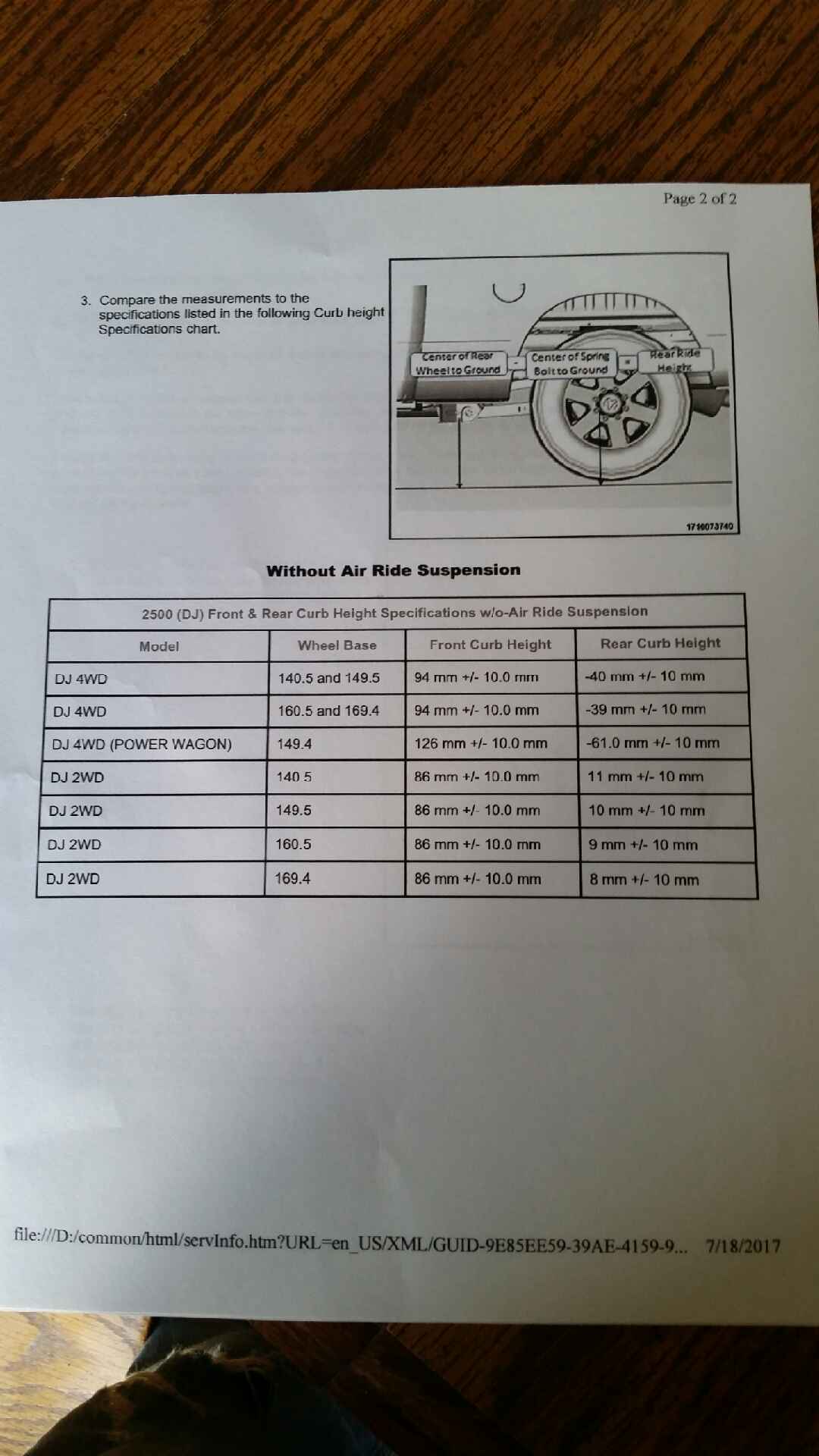

if you get a chance you can check yourself and report back what you have. the method is from the 2017 service manual. I guess theorectically you could have a side to side difference of .8" and still be in spec. +.4" on one side and -.4" on the other.OH17wagon wrote:I have a 17 with just under 900 miles on it and it definitely has a noticeable lean towards the drivers side. I haven't had it looked at yet.

I started looking into this to try and understand whats going on. it seems that when the cams are turned toward the rear of the truck it increases the caster and thus can pull that side of the truck suspension down. it would have the opposite effect if the cam where turned toward the front, caster would decrease and it would try and lift that side. unless my thinking is backwards ? my driver side is the low side but it has the cam arrow turned more toward the front so I must be confused or my thinking is backwards. anybody want to chime in on this ?
also I found something interesting in the manual which seems to echo what thuren said. when the cams are out of phase it can mess with the ride height. " For 2500/3500, caster can be adjusted by rotating the cams on the lower control arm. Left and right cams should be rotated in the same direction to minimize ride height changes side to side. Cross caster should not be adjusted by putting adjust cams out of phase."
im still not perfectly clear on what cross caster meens. is that when the caster adjustment on each side is outside the range listed in the manual, basically causing a forward and backward twisting of the axle, frame, suspension ? basically one side would have a ton of positive caster and the other side would have very little positive caster ??
im thinking I might make some marks where my cams are set now, then ill turn them so theyre alittle closer to lining up with each other from side to side and see what affect that has on the ride height. im starting to think this is the reason why one side of the truck is being pulled down, or the other side being pushed up
