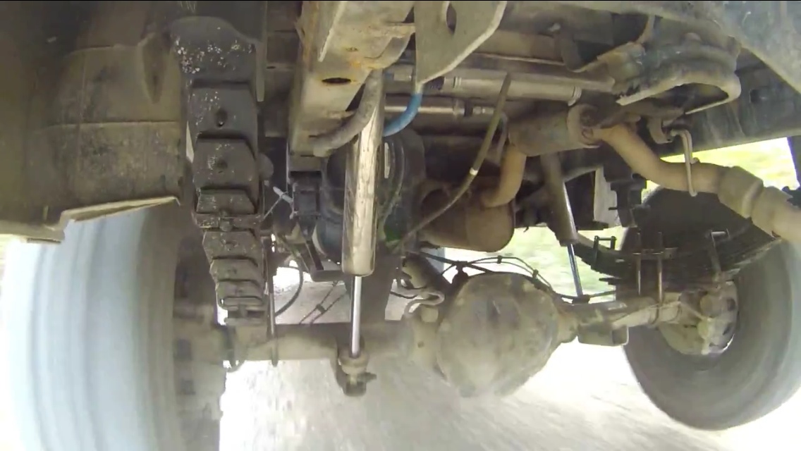

I've not had a chance to look further into this but, my Carli 2.5" Kings were shorter uninstalled than my stock shocks (like 1" or so, IIRC) and I am thinking about either changing the reservoir style of my rear Kings or getting new ones altogether. (the attached reservoirs are rock magnets) I am rocking my stock rear shocks now since I know if I reinstall the Carlis they'll just get ripped off again but now I've noticed my stock rear shocks are looking ROUGH! (looks like they are catastrophically leaking oil) So.. I need to figure something out for rear shocks, ideas????

I've heard the Carli King 2.5's can be flipped so the shock body and reservoir are up top and the shaft is on the bottom. I've thought about doing this myself. Any truth to this?

Ya 2.5 is small enough you can do that I think! Just cycle it around a few times to make sure your not gunna hit anything like the bed or cross member side piece or something etc.

Oooo btw they might be alittle smaller because the factory pw uses a small bump stop drop 1" thick and the factory 2500 I don't think has this :/ so maybe that's why Carli shocks are shorter meant for the trucks without the bump drop. If you look at your rear bump stop drops you'll see what I mean.

So, I spoke with Dan over at Carli. Apparently, this cannot be done unless bed cross-members are altered. The shock bodies will contact. Also, he brought up a good point about the shaft being damaged, which is much worse that damage to a reservoir.

This ^ is true, they will not fit reservoir up on a 2012 without cross-member modification, I tried! As for damage to the shock shaft, I agree that is a risk BUT, I don't go bombing about in my truck (like 90% of what I do is crawling), so, shock shaft damage is not so much a concern for me vs the reservoir sticking down got ripped off by a rock after only 2 outings. Rebuilding at least one rear shock every two outings would get very pricey, LOL! (one ripped off, the other was damaged but still intact)SheepdogOutdoorsman wrote:So, I spoke with Dan over at Carli. Apparently, this cannot be done unless bed cross-members are altered. The shock bodies will contact. Also, he brought up a good point about the shaft being damaged, which is much worse that damage to a reservoir.
Thank y'all for the info about the shock length, that has been bugging me since the install 44k miles ago! Does anybody by chance know the travel of the Carli shocks vs the travel of the stockers? (as was pointed out about the shorty bodied Thurens, depending on the design of the shock, a shorter travel of one design may have more travel than a longer shock of another design)
