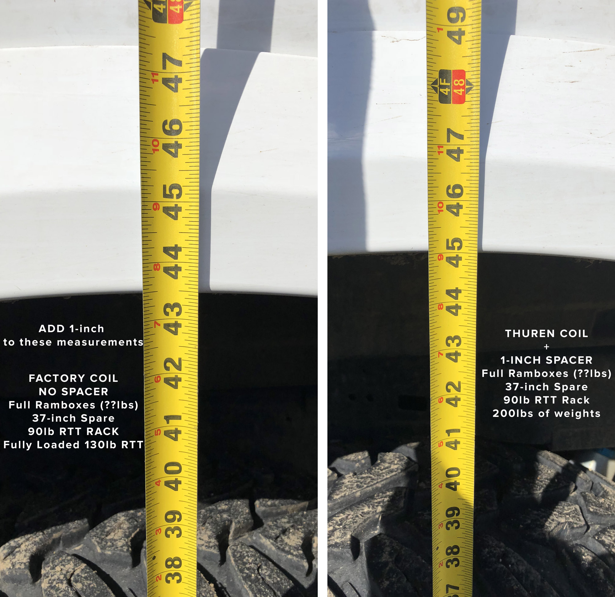

I took measurements of the RTT and squat when we did that and what happened in the rear there. It's so close. Honestly, they are softer but you're talking about a few quarters difference in the squat between both.
Yes, 1-inch spacer, the attached however is without it. These are the first measurements, add one inch, and then compare >>
Awesome, thank you. Just wanted to be sure the Thuren rears would not be taller than factory, that would be going in the wrong direction. You and Damagewagon have confirmed that. :cheers:

They're taller out of the truck, but not in the truck. Me and DamageWagon think that the softness concern is overblown. They're softer, but the squat isn't like 3 inches vs 1 inch.

Post by OffroadTreks » Thu Mar 08, 2018 7:48 pm
I was talking about the rears. The rears are taller.
The front 1.5's are the same height, but taller when the truck weight is on them.

I'm running Thuren 1.5 PW springs in the front and stock springs in the rear. Shocks and front trackbar are stock. Rear trackbar is Thuren. I have Ramboxes that I keep loaded with recovery gear. Snow chains, 25 ft of drag chain, 2 big ass snatch blocks, shackles, air compressor, etc.
I was about a half inch low in the rear. I added a Traxada 1 inch rear spacer and I now have a small rake. Maybe a .5 to 1 inch rake and removes the nose up illusion. Looks really nice on 37s.
We can take measurements of mine vs Mike's if that'd help.
My next step is probably kings, thuren rear coils, and rear sway bar extensions but i want to ride in Mike's truck first... lol. We are using the same 1 inch rear spacer.
I would definitely put the 1 inch spacer back in on stock coils. When I go to Thuren rear coils, I'm not 100% positive yet.
