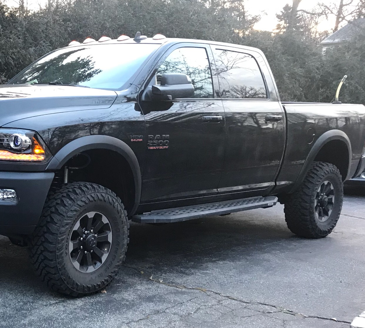

Post by TankerZak » Fri Dec 29, 2017 7:23 pm
Pre pic
TankerZak
Posts: 711
Re: Suspension question...again
Post by TankerZak » Fri Dec 29, 2017 7:24 pm
Post pic.
TankerZak
Posts: 711
Post by TankerZak » Fri Dec 29, 2017 7:25 pm
Scary during pic...
TankerZak
Posts: 711
Post by TankerZak » Fri Dec 29, 2017 7:26 pm
Let me know if you guys want the measurement pics we took. Too much to post if no one cares.

Looks great! Where did you measure to? I'm interested to see exactly how much you gained. I'm still trying to decide what coils to go with on mine. Thuren .5, 1.5, or a Carli Hemi coil that I can pick up and install same day along with some 2.5s...
TankerZak
Posts: 711
Post by TankerZak » Fri Dec 29, 2017 9:36 pm
I measured from the ground to the apex of the wheel wells. I gained the 1.5 inches exactly in the front. I.keep recovery gear in the back with rambox weight and a 5 gallon full gas can against the tailgate. I'm actually 1/8th of an inch high in the front as loaded. I think I'd be level if i took gas can and chains, and recovery gear out. I used the Thuren 1.5 springs. Carli uses stock type springs and i didnt want that. This turned out perfect. And cheap!!
