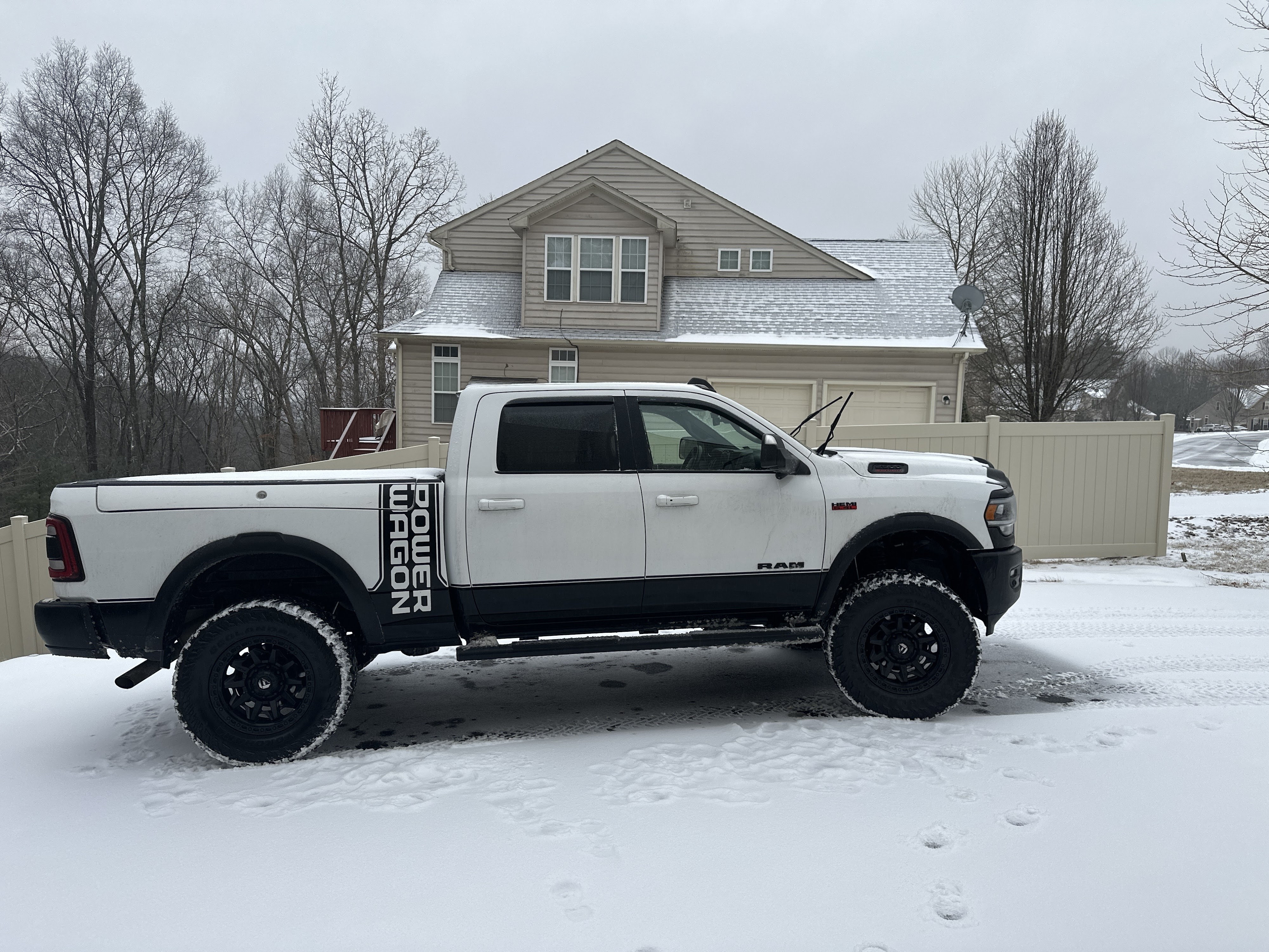

:excited: I just had the BDS 2” Suspension lift installed and my 37” Yokohama Geolandar tires barely brush the bottom of the fender well plastic on full turn… is there a body weld under that cover that I can trim? Still snowing here in PA so I don’t have an opportunity to take that off and look.

Good video on trimming everything. You can hit the pinch weld with a grinder/flap wheel if you are still making contact.

I ran 37’s on my 2014. Before & after installing the full Thuren suspension system. I had very minor rubbing @ full-lock before , none after.

I put AEV wheel with the right offset in and didn’t have to trim anything.
