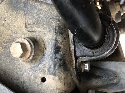

I wanted to see if anyone had any ideas on why my swaybar moved passenger side so far? I have a 2012, and I have a DOR steering brace which is mounted under the swaybar bushing clamp. I noticed the swaybar off centered to the passenger side, and it was contacting the steering brace just a bit. I though it was a bushing problem, so I replaced the bushings with OEM ones this weekend, and I centered the bar. After driving a short distance, the bar pulled over to the passenger side again. The picture is from the side on driver side. This is the new bushing being pushed by the bend in the bar.
Here is one from the bottom.
I was looking at adding a spacer plate that DOR offers to make the swaybar sit the same on both bushings. Currently the steering brace adds about a 1/4" on the driver side. Could this be causing the movement? Any help would be appreciated.

Here is the picture that disappeared of the bushing on driver side.

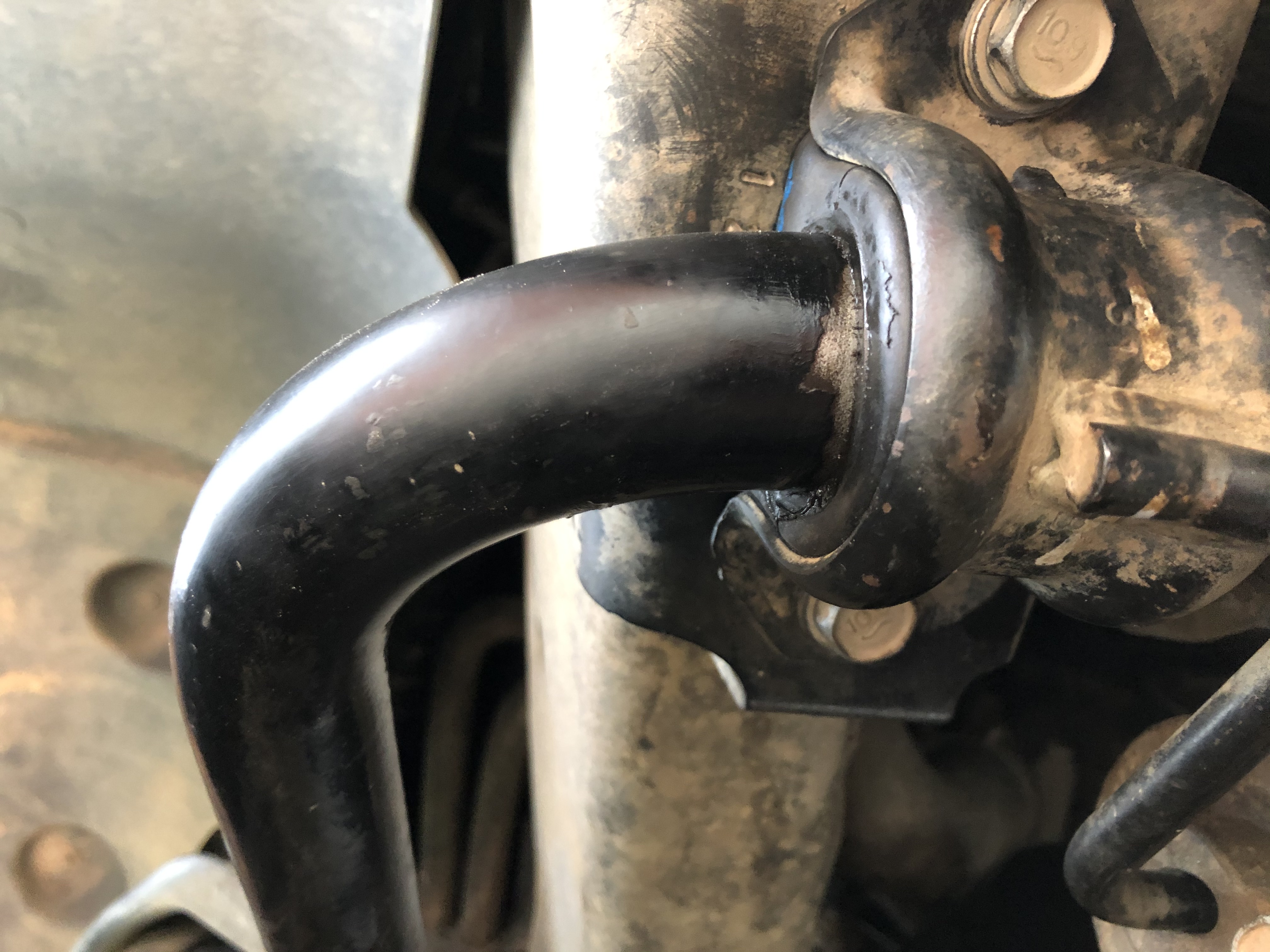

Here is the picture from the passenger side from below. You can see the bar sticks out a great deal more than the driver side.

I put a DOR brace on my '13 wagon. Mine did the same thing. I put the extra plate in. I felt that difference exaggerated the issue a bit, plus it was a major OCD violation for me. For some reason the bar sits a little passenger side. Mine self-clearanced a bit on the wrap around part of the bracket too, but I feel it is acceptable now. Perhaps it is just a smartbar thing. I don't worry about it anymore and it seems to not cause any problems. The plate shipped pretty quickly compared to the brace, perhaps an off-the-shelf item. This is one of the first projects I did. So, maybe 1.5 yrs ago. See the little bit of rust where the interference was.

It’s probably due to your axle not being centered, and the swaybar links pushing the bar over as you drive. If that’s the case it’s a side affect of a trackbar system where with your lift the axle doesn’t stay dead-center to the frame. My truck did the Ana Erving but it was never an issue.

I put mine in pre-lift (first mod), so it wouldn't have been the lift that affected it. However, post lift my axle was off-center to the driver side (as mentioned in my build post) which if anything should have pulled the swaybar to the left away from the bracket. Even when I had everything disconnected (links removed) the bar on my truck just likes sitting a little bit right. I could pull and yank on it and it only moved a little bit. Perhaps the non-smartbar has slightly different dimensions and clears the bracket as designed. I don't know, just thought that was a possibility. There is some extra unnecessary material on that part of the bracket. I suppose if someone found it to be a real problem they could grind a little off.DamageWagon wrote:It’s probably due to your axle not being centered, and the swaybar links pushing the bar over as you drive. If that’s the case it’s a side affect of a trackbar system where with your lift the axle doesn’t stay dead-center to the frame. My truck did the Ana Erving but it was never an issue.
