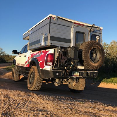

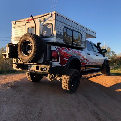

So I stopped at a place near my house to take some shots tonight, thought it might help. This is with 40psi in the bags. I thought I took a pic of the DS rear in compression, but I got a phone call right about that same time. Must have spaced it. Sad times.
'16 with '17 FWC
Oilbrnr
Posts: 164
Re: Air Lift Bags and Uptravel
Post by Oilbrnr » Wed Feb 26, 2020 8:58 pm
second
'16 with '17 FWC
Oilbrnr
Posts: 164
Post by Oilbrnr » Wed Feb 26, 2020 9:00 pm
Rear.
'16 with '17 FWC

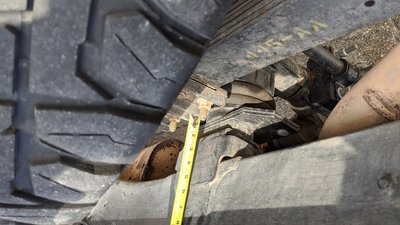

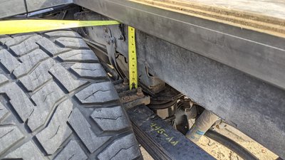

Here are a couple pictures with measurements I got when checking for clearance on my flatbed build. On the DS i let purged air out of the bags as the bags were compressing so it should be pretty close to zero psi.

richxd87 wrote:Here are a couple pictures with measurements I got when checking for clearance on my flatbed build. On the DS i let purged air out of the bags as the bags were compressing so it should be pretty close to zero psi.
Hey... it'll be better if you take that 1 inch spacer out. No need for it to be there...

richxd87 wrote:
Thu Mar 05, 2020 12:46 pm
Thanks for the pictures. I am hearing more and more that the spacer isn't needed.

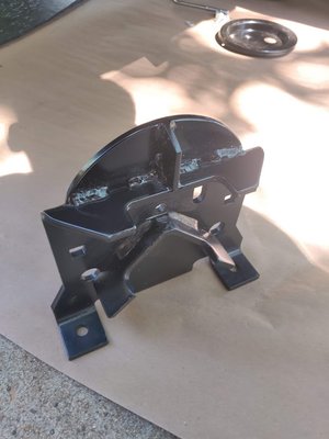

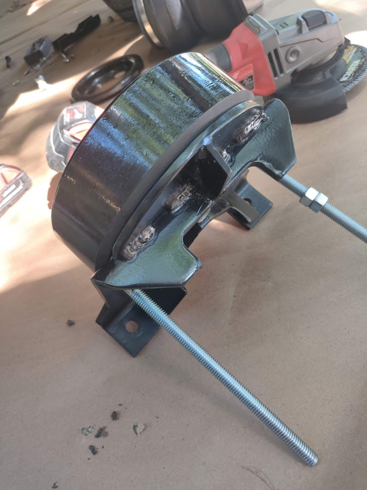

Yea, I tried it without the spacer but the bag then required more pressure for the lift/support I wanted to achieve. I may remove it after I install the Thuren shackles and king shocks. (this is to support ~1600lb slide in Hallmark Camper)
My thought was to get the level with the lowest psi for a smoother ride. right? wrong?
Does anyone know if the Airlift 7500 bags fit the daystar cradles?
I also modified the Airlift brackets to better support the cradle.

richxd87 wrote:Yea, I tried it without the spacer but the bag then required more pressure for the lift/support I wanted to achieve. I may remove it after I install the Thuren shackles and king shocks. (this is to support ~1600lb slide in Hallmark Camper)
I drilled and taped the bump pad for cradle installation. No bottom bracketry. I'm not sure the PSI difference would be significant enough to give up an inch of travel with the spacer in. I still only need about 20 PSI in the bags to tow my RV but it's a much different use-case than a camper especially offroading with a camper. I'd be trying to do as little as I could with airbags to offroad with a camper. Maybe different leafs? Idk...
