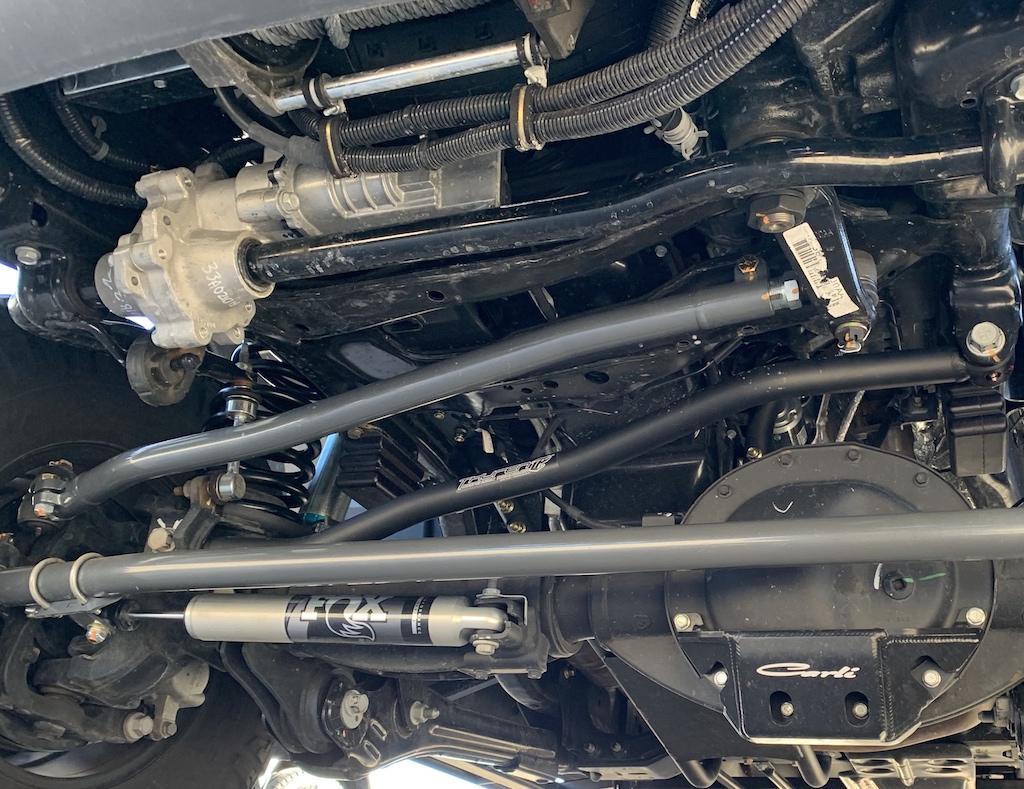

Got the front end sorted. Waiting on Thuren truss and DOR brace to get here. Then I think I'm pretty much tapped out for the front end for a while. Going to wait to upgrade the ball joints and RCV axles as part of the re-gear and 37's this spring. Anyone have experience with Thuren XHD sway bar links?
Re: Overland 1.5 inch Spring w/King OEM 2.5 Shock
Post by DamageWagon » Thu Nov 14, 2019 10:45 pm
I don’t see any hydro assist in there? It’s like you’re not even trying :)
The thuren links are great. Frankly overkill. Unless yours are worn out the Power Wagon links are just fine. The rear links (and the front links on non-PW’s) are more necessary.

I alway measure from fender lip to center of hub. Front = 27 3/4", Rear = 28". After installation of Thuren 1-1/2" springs up front, 1" coil spacer in the rear. Never did take measurements before doing the work. So, you may want to go with a bigger spacer in the rear for your wants. Cheers.

Picture in first post is pre-lift. It was a few weeks between doing the front and installing the rear spacers. With just the front done it definitely looked low in the rear. Where it's at now looks pretty good to me. Your milage may very. Cheers.
