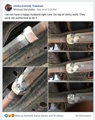

The V06 recall calls for a weld the length of one flat on the nut on each end of the collar. I'm not letting them do it on my '16 3500 yet, as there is still the possibility of an ACTUAL fix somewhere down the road, according to my dealer service manager.
They actually had to buy a welder for this recall. How much practice time do you think the techs had before they struck an arc on a customer's truck???

Maybe 5 minutes of practice if you are lucky enough. "Hey, I made sparks." "Ok , you're ready to go, NEXT!"FirerescuePW wrote: ↑Sun Jun 09, 2019 10:03 amThe V06 recall calls for a weld the length of one flat on the nut on each end of the collar. I'm not letting them do it on my '16 3500 yet, as there is still the possibility of an ACTUAL fix somewhere down the road, according to my dealer service manager.
