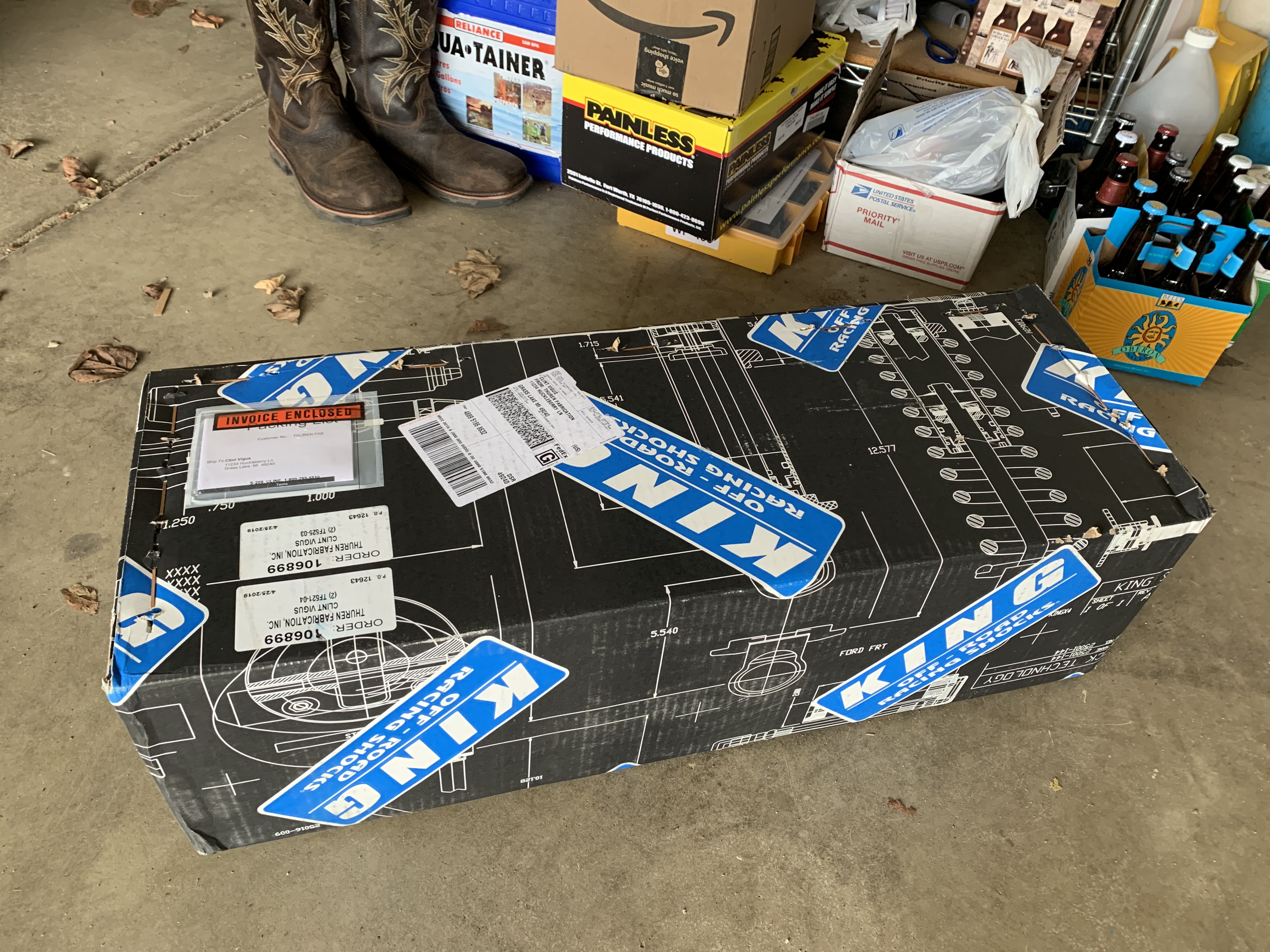

When I got back I had this in my driveway and the rest of the hard parts arrived a day later - hoping Don’s custom valving and raised rear track bar will fix me up.

That looks like a very expensive box of fun.
