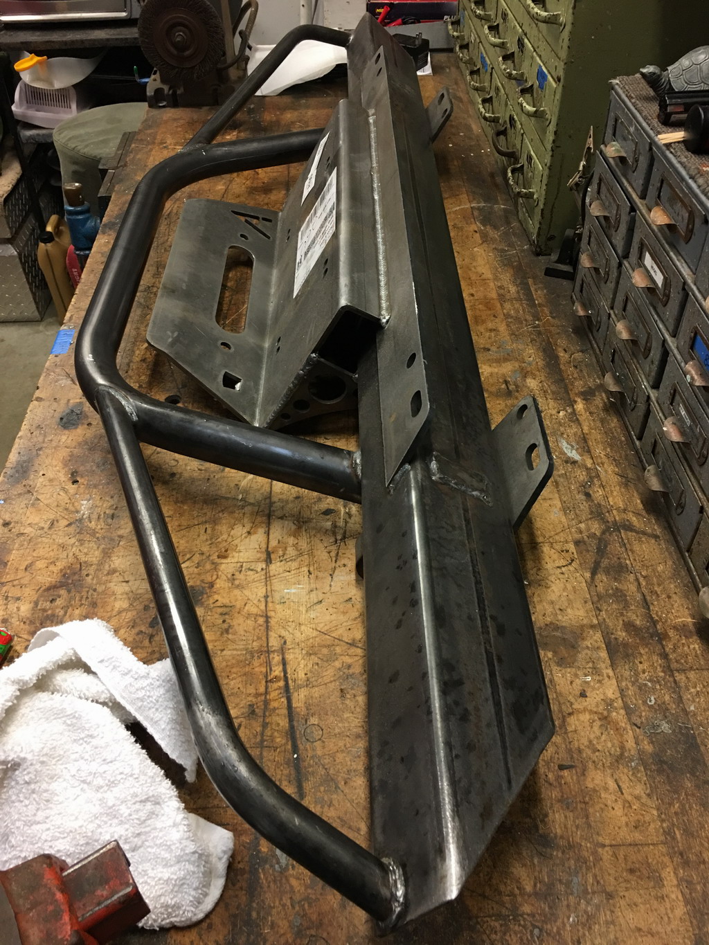

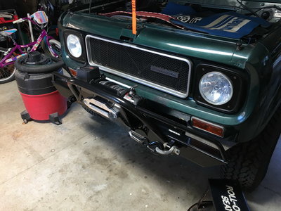

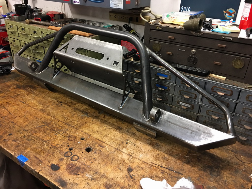

I bought this Bumper from a guy on ebay, for my 1970 Scout 800.. he's been selling them for awhile he's sold 54....it was $325 delivered. I'm really impressed with the quality and the price. I wish he made affordable 3G bumpers.
The bumper measures 60"wide x 10"deep and 16"high and weighs 44 lbs. The bumper is made out of 3"x 4"x 1/8" steel tubing with closed ends. Main tube hoop is 1 ¾" .120 wall, with 1" .095 wall side tubes. The mounting brackets are ¼" thick and bolt right up to the stock bumper location, with the stock hardware. The clevis mounts are 1" wide. Winch plate is also 1/4" and features our trademark "Bottle Opener" stamped into it. Compatible with most winches that have the market standard 10” x 4.5” bottom foot mounting profile.

Looks great! Scouts are awesome little trucks.

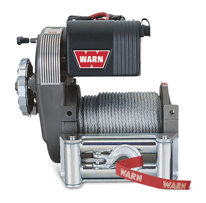

If it were me, I would definitely go with a 10,000 or 12,000lb Warn of some sort. The Zeon 10/12-S would probably be my first pick, although it depends on how much off-road use it might see.
- Posts: 1216
Re: Winch Bumper
On a classic Scout I'd go with a classic winch, Warn 8274.
That's all you'd ever need and mega fast.

DamageWagon wrote:Do you have any stipulations? Cost, power, electric or hydraulic, etc. electric-$500 I was thinking 8000 lb might be good for the Scoutfbenross wrote:Thanks....Any suggestions on a winch ??????
Re: Winch Bumper
Retired BLM Rig wrote:On a classic Scout I'd go with a classic winch, Warn 8274.
That's all you'd ever need and mega fast. Thanks i'll check one out

X2Retired BLM Rig wrote:On a classic Scout I'd go with a classic winch, Warn 8274.
For a 8000lb. winch, the 8274 has pretty much been the gold standard for years, but they are not cheap.
Re: Winch Bumper
bstefanic wrote:I've been running a warn powerplant on my wife's Rubicon for years and it works great. Having the additional air compressor attached is a huge plus
When I first heard about them I thought it was a joke. Like some harbor freight contraption, like their 10kW inverters for $100. Haha I was so wrong... Now I understand it is an awesome idea, it is so much simpler than having to install or carry a compressor or tank. Very sound investment.
Re: Winch Bumper
The new ones are expensive but you can buy an old model for way cheap, maybe $200-300. All the rebuild parts are out there too, and good tutorials. Very popular setup and can be had cheap. Plus the old models just look cool.cruz wrote:X2Retired BLM Rig wrote:On a classic Scout I'd go with a classic winch, Warn 8274.

The International looks great!
Re: Winch Bumper
Beautiful scout!
- Posts: 5567
Re: Winch Bumper
Looking good!
