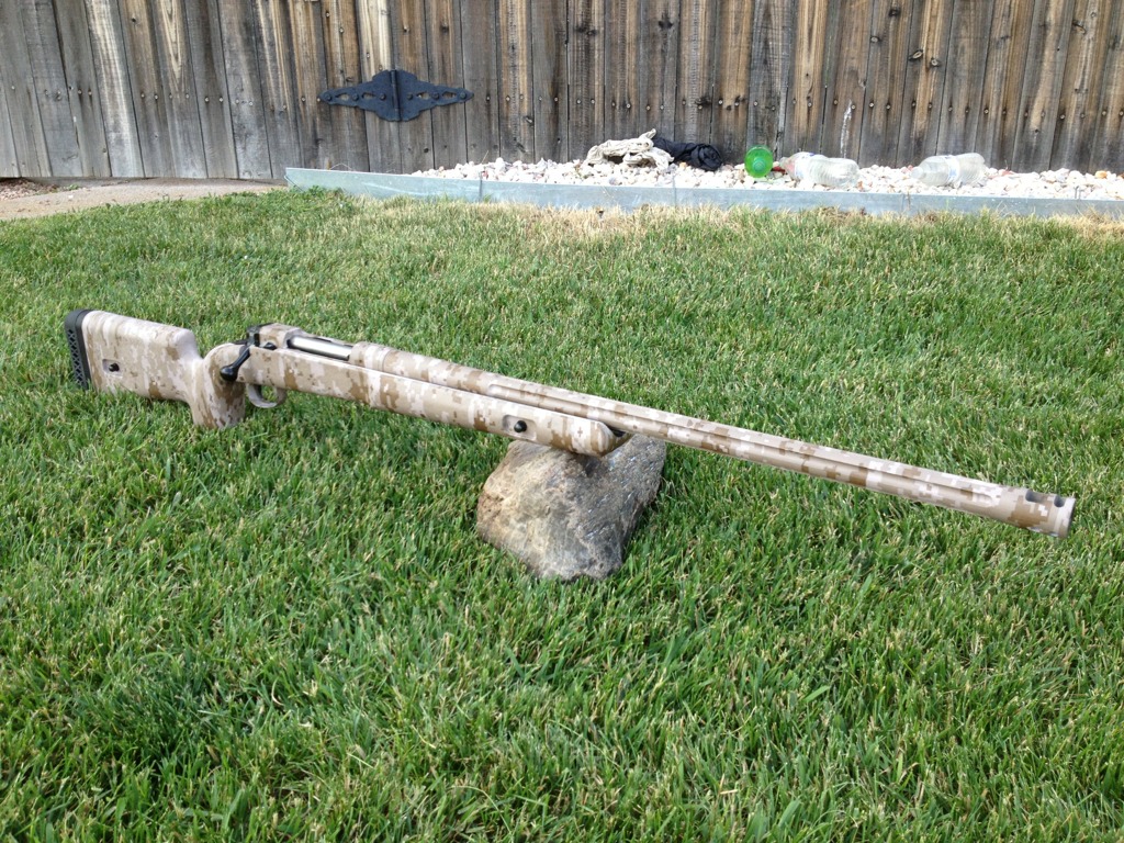

Hey all just built a custom rifle chamber in 30-378. It's time for optics! Night force, leupold LRT, not sure. Zero stop or not. So many decisions. Help! This will be not just target but a lot of hunting. Wyoming presents its self with lots of long rang opportunities.

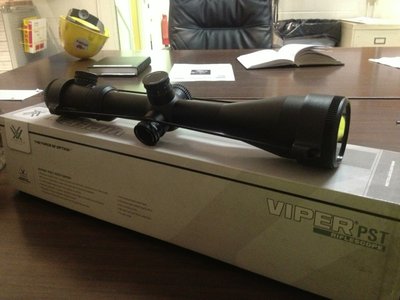

Dropped the hammer!!

Nice choice! We've used Vortex binocs for the last couple years - great optics.

Had nothing but great reviews we will see! Took a while to figure out the MRAD thing (MRAD to inches)but I got it now. Can't wait to try it out!

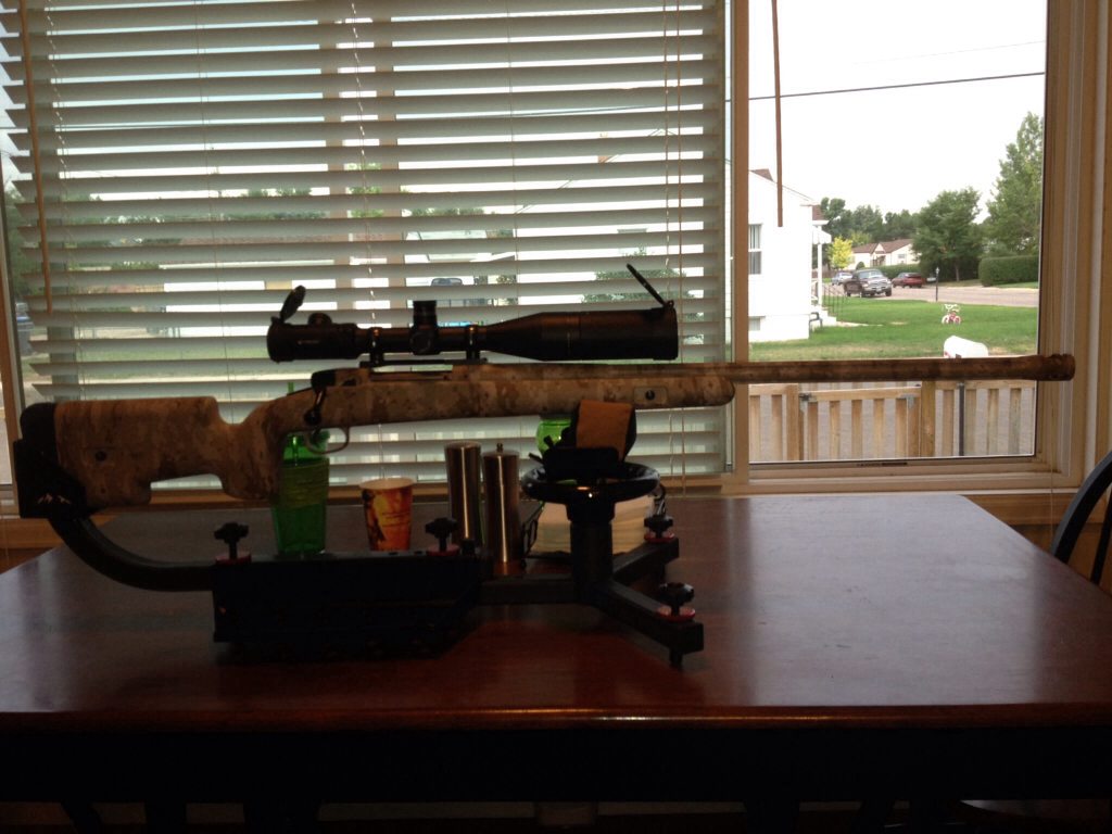

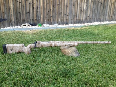

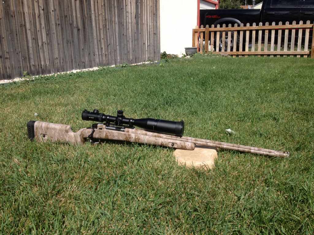

Thought I'd update the gun build!

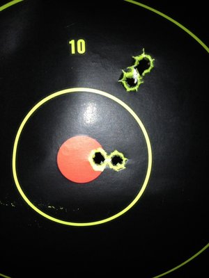

3 shots 2 holes!

Wow...$$$

Mind a throwing out a few specs on the rifle? After doing a little research, I'm very interested in round. You build it yourself or buy it complete?

After doing a lot of research on this round I decided on. A .30 cal bullet is all you need to do any hunting anywhere. For long range 500+ yards on elk for example I want a heavy grain bullet going fast. This is the fastest .30 cal ever built to date. Buying the brass is the worst part at about $70 for 20. Once you own the brass is not that bad cost wise-some where in the neighborhood of $3.00 a round. If you buy loaded ammo it's about $135.00 for 20. Big difference. I bought the barrel and action from someone in Colorado on armslist for $500. Barrel is a Douglas heavy fluted with break 1:9 twist and action is savage long action. He just wanted it gone because it had a break and "I hate anything with a break" he said. Paid $250 for a new stock and $900 for the scope and had a trigger job done buy the local gun smith. I load the brass as follows-103.5 grains of H1000, Remington magnum primers, and a 200grain Barnes LRX. 3185fps with this mix up. Gun is sub MOA.bstefanic wrote:ScottWagon1 wrote:
