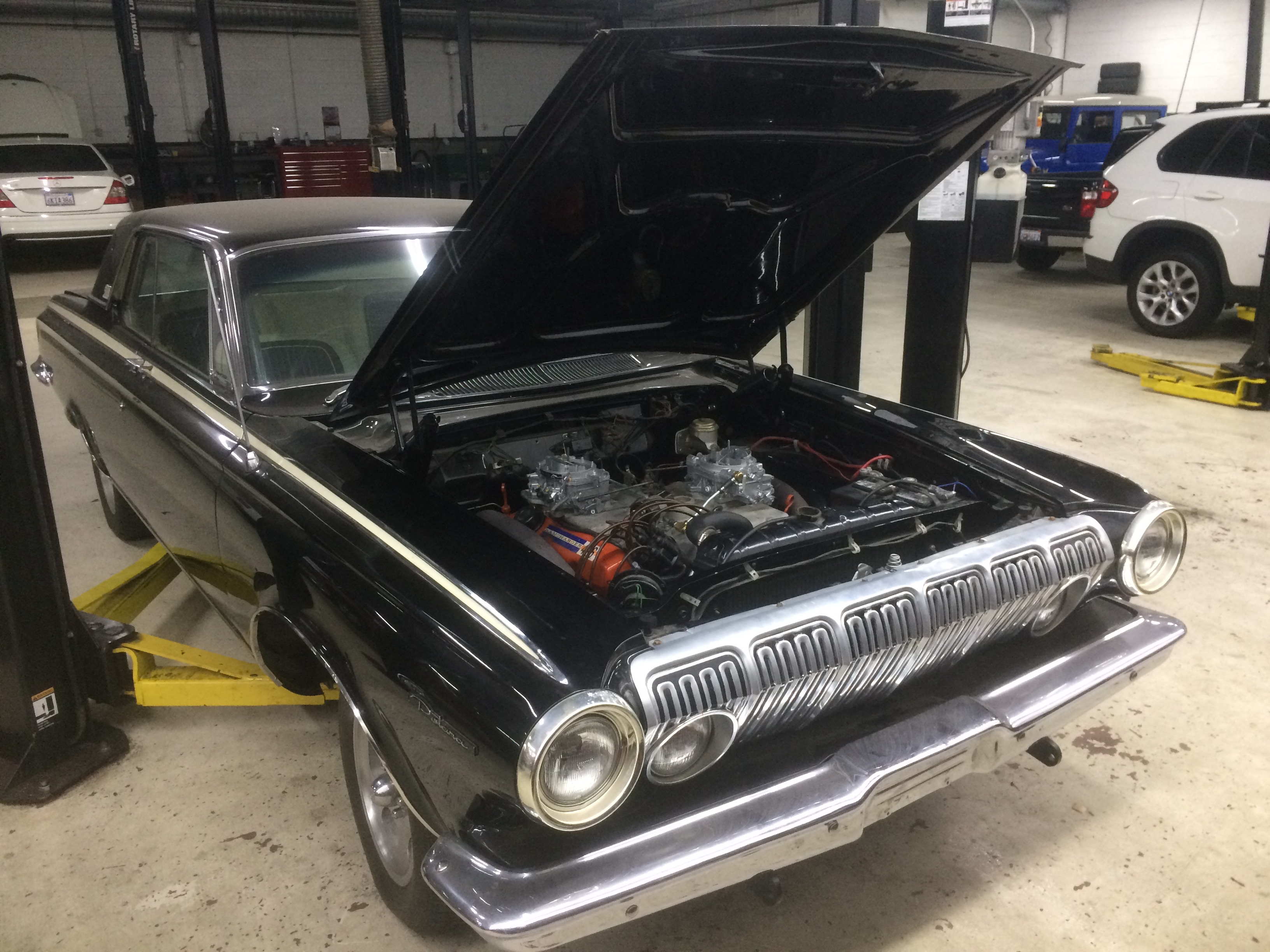

Finishing up a valve job on this beast. Made it breathe fire before I left work tonight. It's not a 426 Hemi, but it's close (I think that came a year or two later). Dodge has a long history of performance minded production vehicles.
1963 Dodge Polara 500
Not much to look at really, until you open the hood.

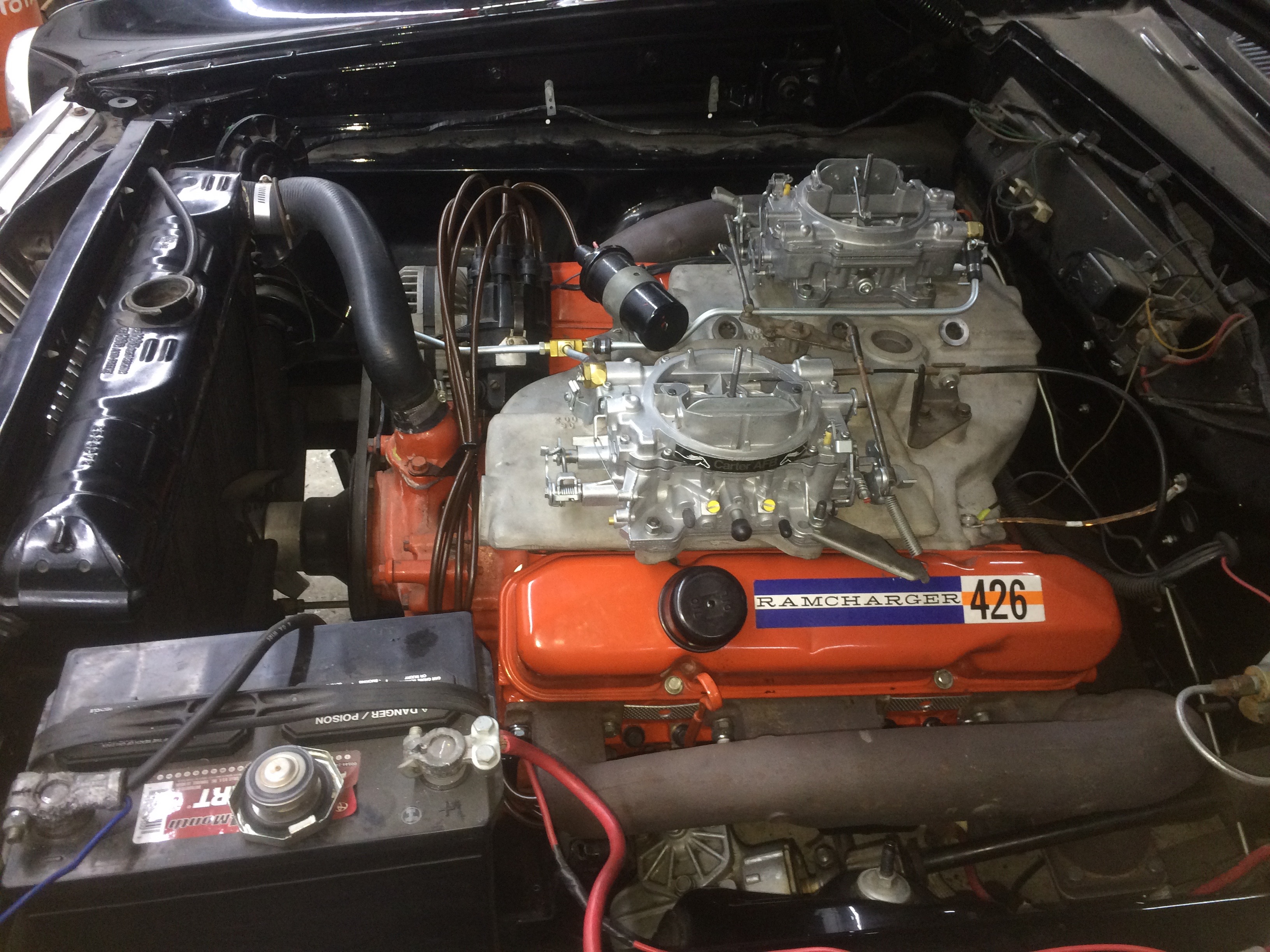

Factory 426 Max Wedge, dual 4 barrel carbs, solid lifter cam, factory cast iron headers and a little, tiny non-power brake master cylinder to stop all that horsepower.

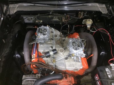

The left carb feeds the right cylinders and vise versa, through a low profile long runner intake manifold.

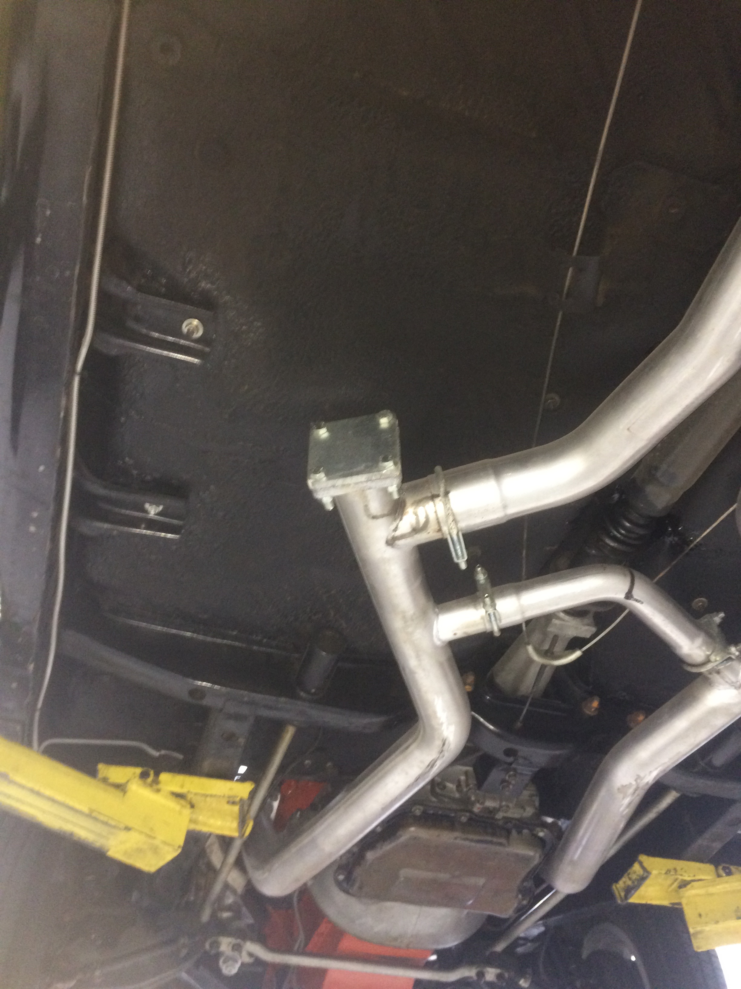

Factory 3" dual exhaust w/crossover pipe and blow off tubes.
Close up of one of the exhaust plates you would remove for drag racing.

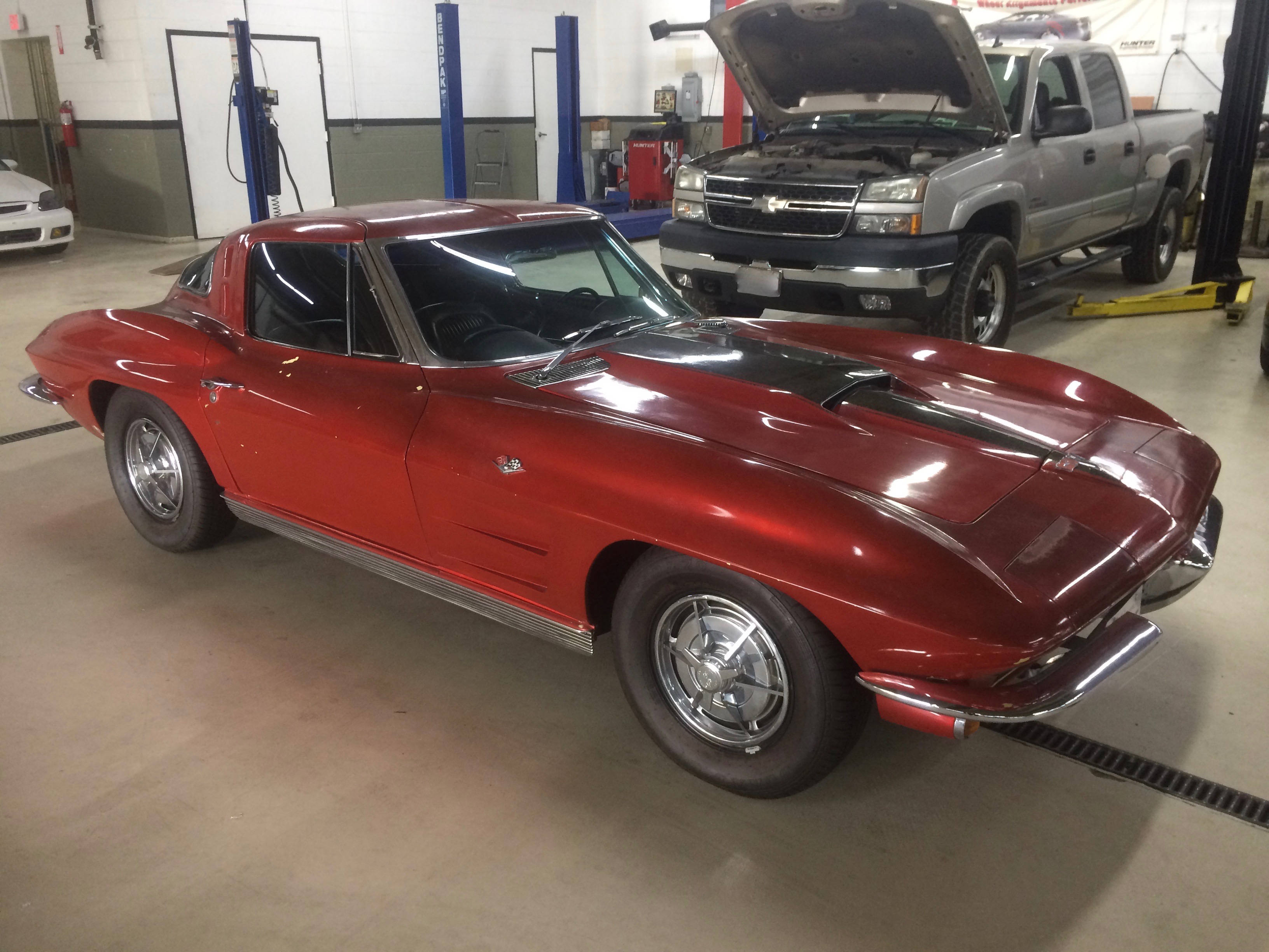

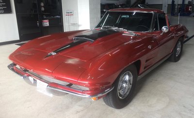

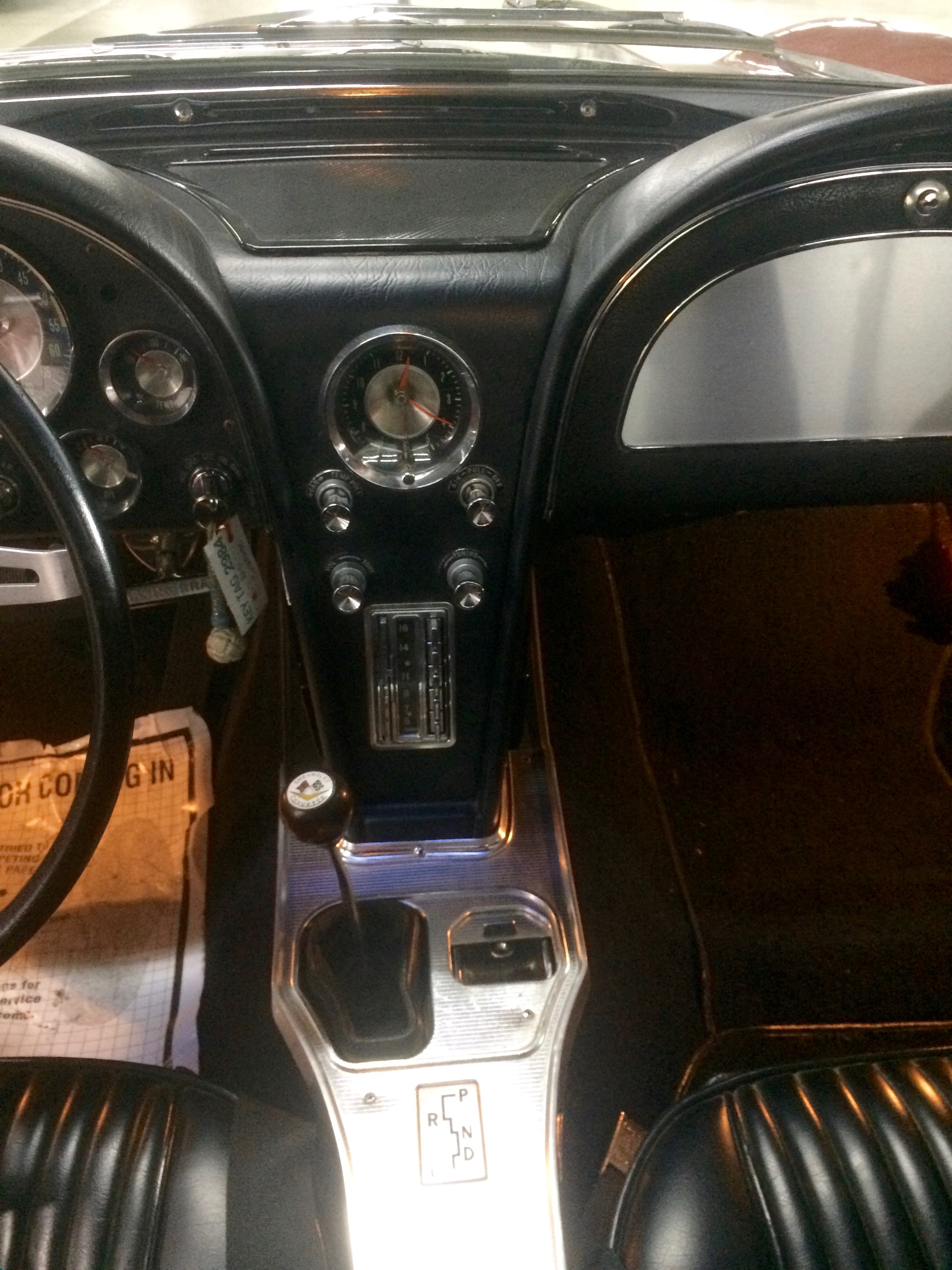

Just finished this one today. It's a 1963 Corvette Sting Ray split window with a 327 and a two speed Power Glide transmission. The story I got was that it had been a show car at one time, which was evident from all the parts that had been chromed, but after being stored in a garage for the last 38 years, all that chrome is in pretty bad shape. The paint is in bad shape as well. It's going to take some :cash: and TLC to get this one back to show quality. Actually, the new owner bought it for his wife. Now they own two classic Corvettes and two Toyotas. :lol:
Classic lines
The coveted split rear window.

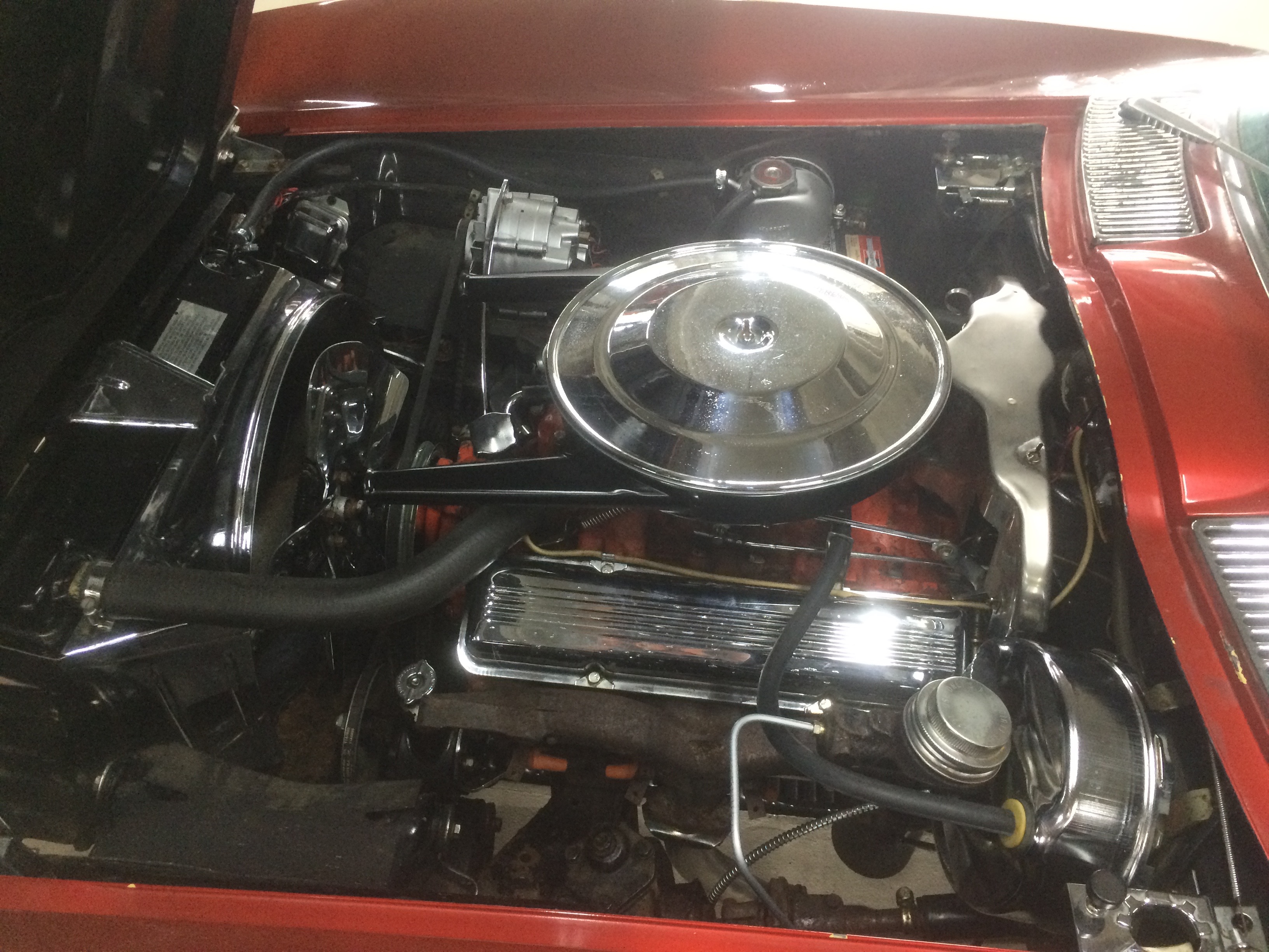

I did a tune up which is made more difficult by all that chrome shielding covering the distributor and wires. The wires drop down the back of the engine and come up to the plugs from underneath The front plug wires thread up through the motor mounts.
Look at those two tiny air cleaner snorkles drawing hot air right from the radiator. I don't know how they expected the engine to breathe.
The interior is in good shape, but that new car smell is long gone and was replaced by 38 years of storage stagnation.
Vertically mounted radio. LOL
The majority of the work on this one was the brakes. All the drums were 1/8" oversize. All new hydraulics including hand bent steel lines. New shoes, springs and parking brake cables Much safer now.
To be continued. :patriot:

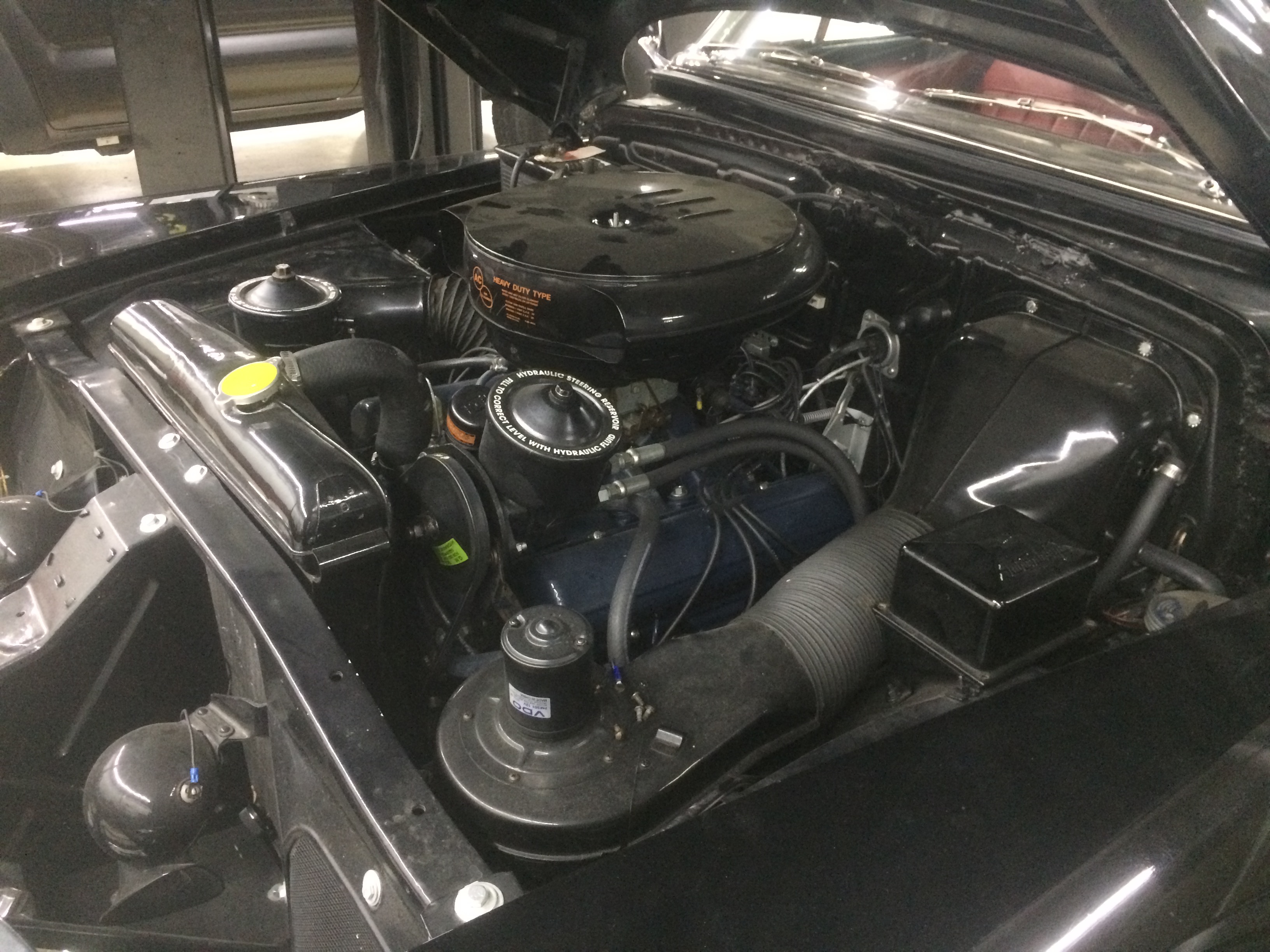

So one of my service writers used to work at a classic car shop and after they went out of business a lot of his old customers followed him to his new gig. Thats why I have such an inordinately high number of these vehicles that I work on. Plus I guess they figure the oldest guy in the shop should know how to fix them. :lol:

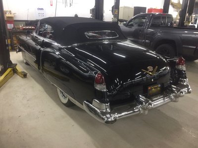

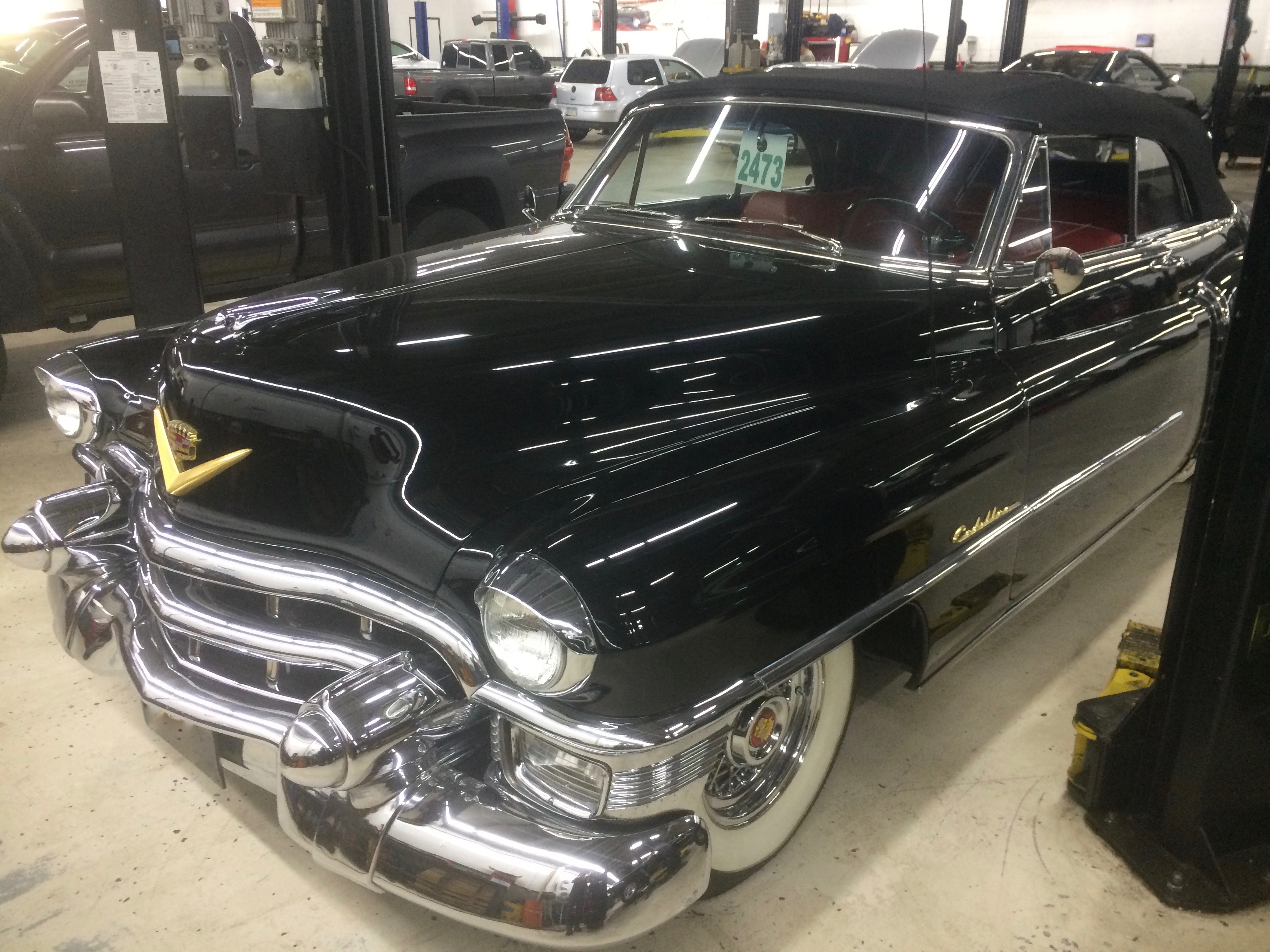

Today I began the process of evaluating this black beauty, A 1953 Cadillac DeVille convertible.
The customer has a lot of complaints, mostly regarding electrical issues and after looking at the wiring, I could see why. :sick:
Complete with the iconic Dagmar bumper (Google it).

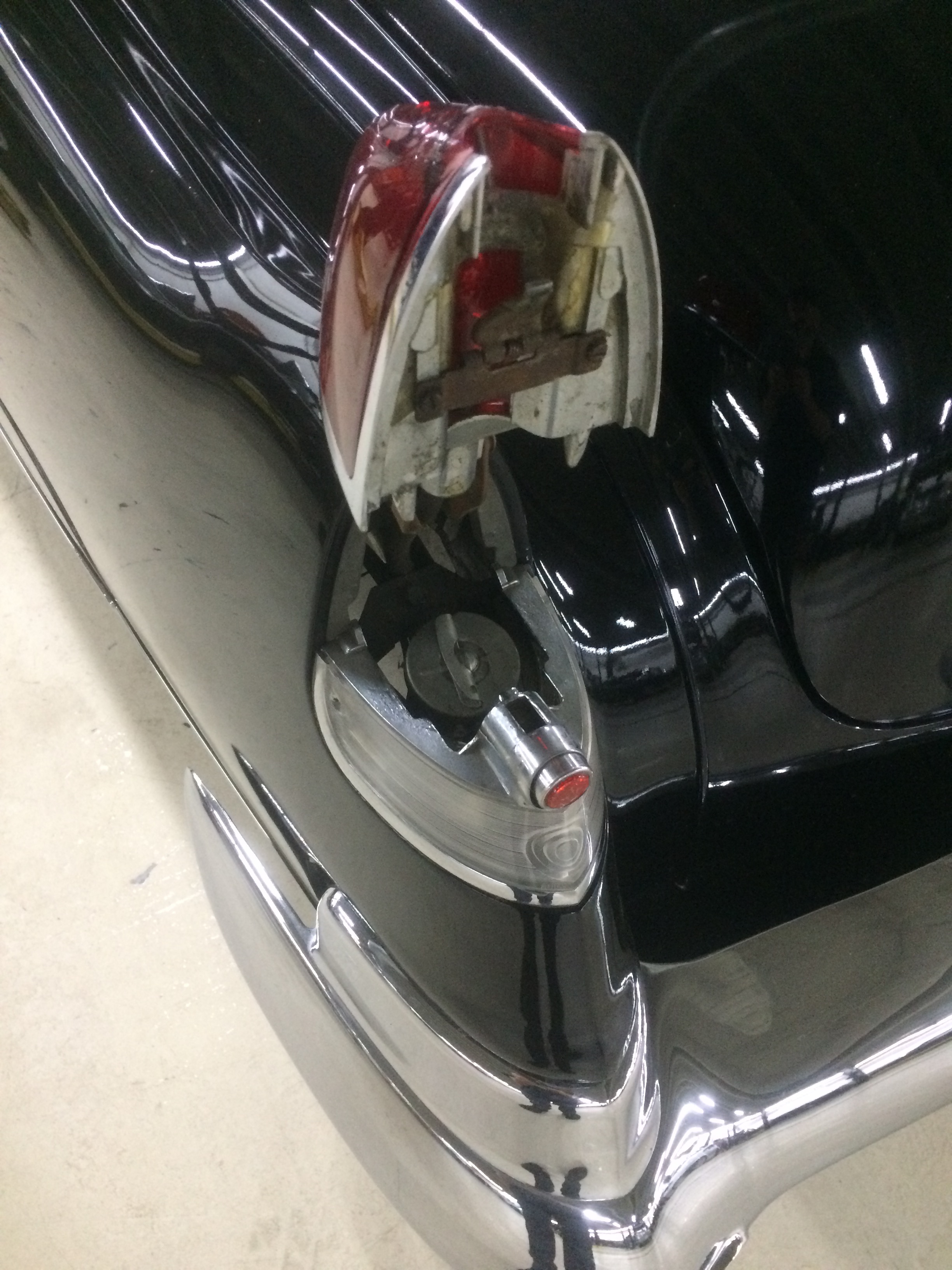

Can you find the hidden gas cap? Just push the reflector button...
...and lift up the taillight housing.

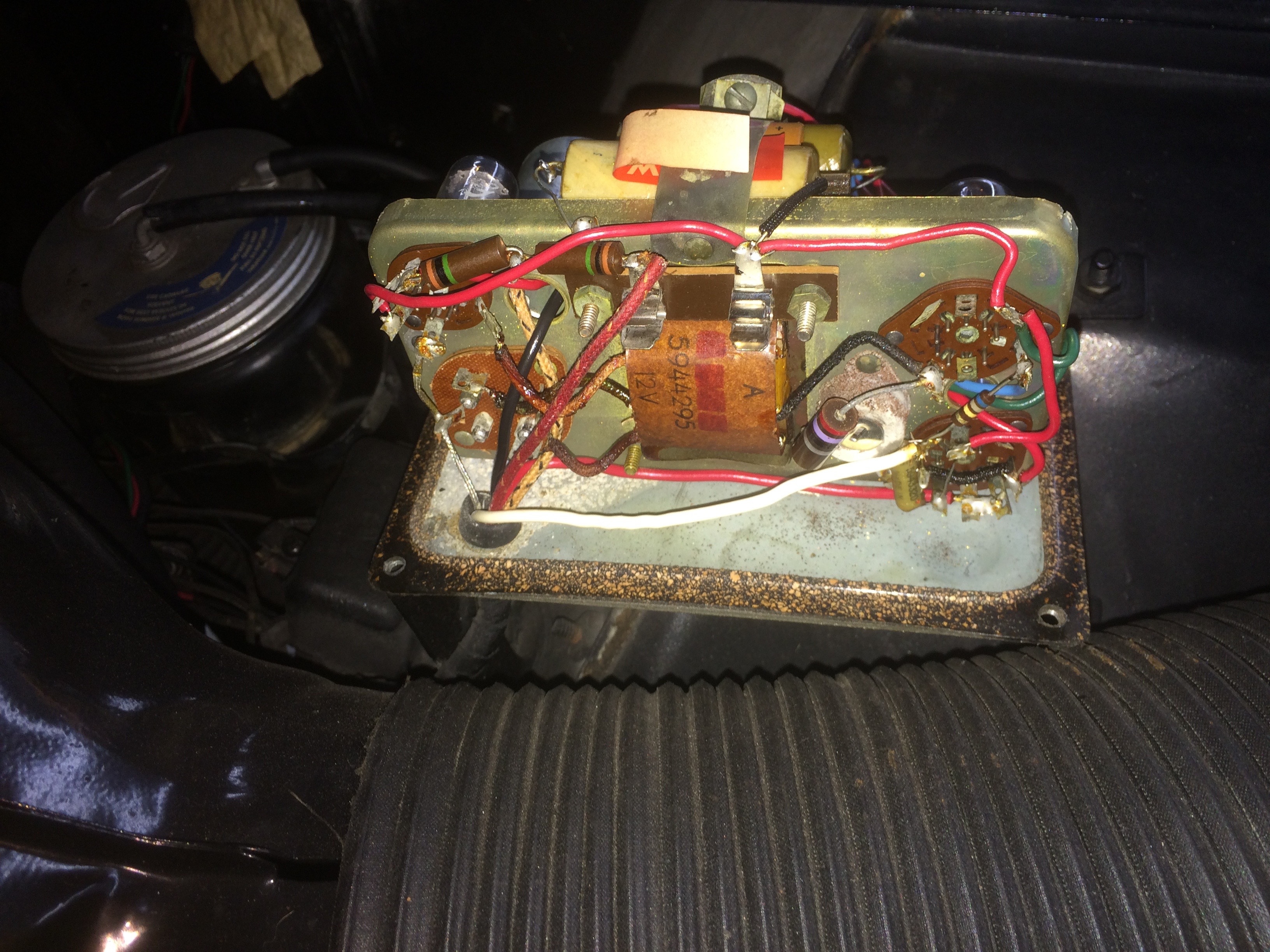

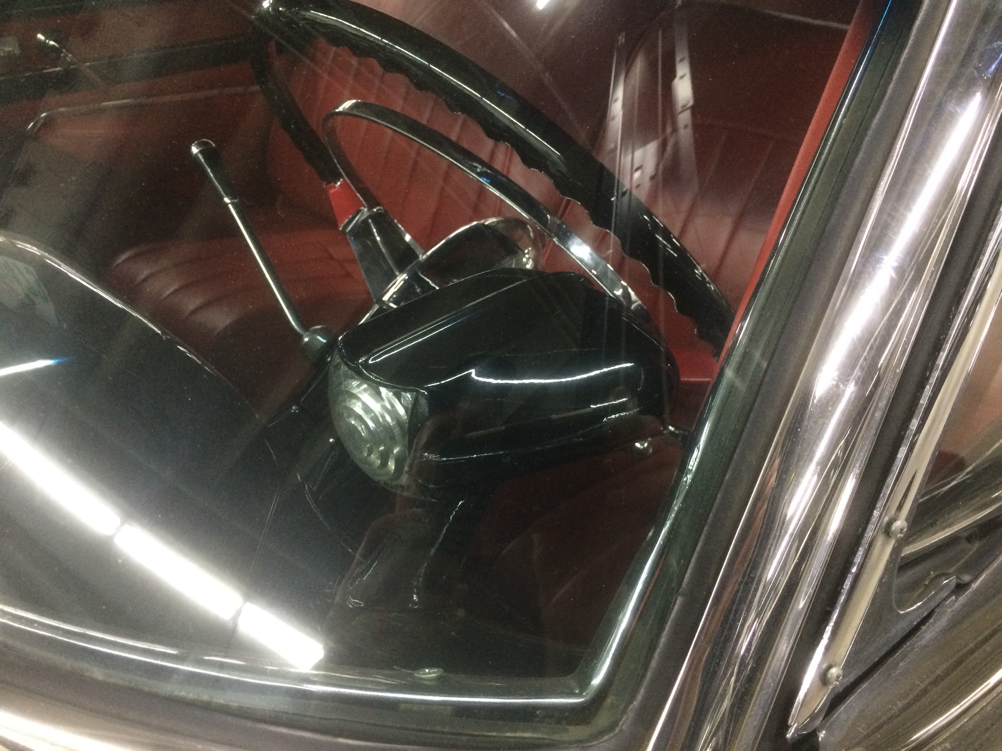

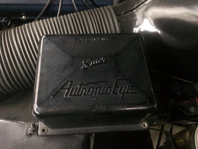

One complaint is that the Autronic Eye system no longer works. It's supposed to automatically dim the headlights when it senses light from opposing traffic. This is called the amplifier.
I personally believe that it's an early version of the flux capacitor.

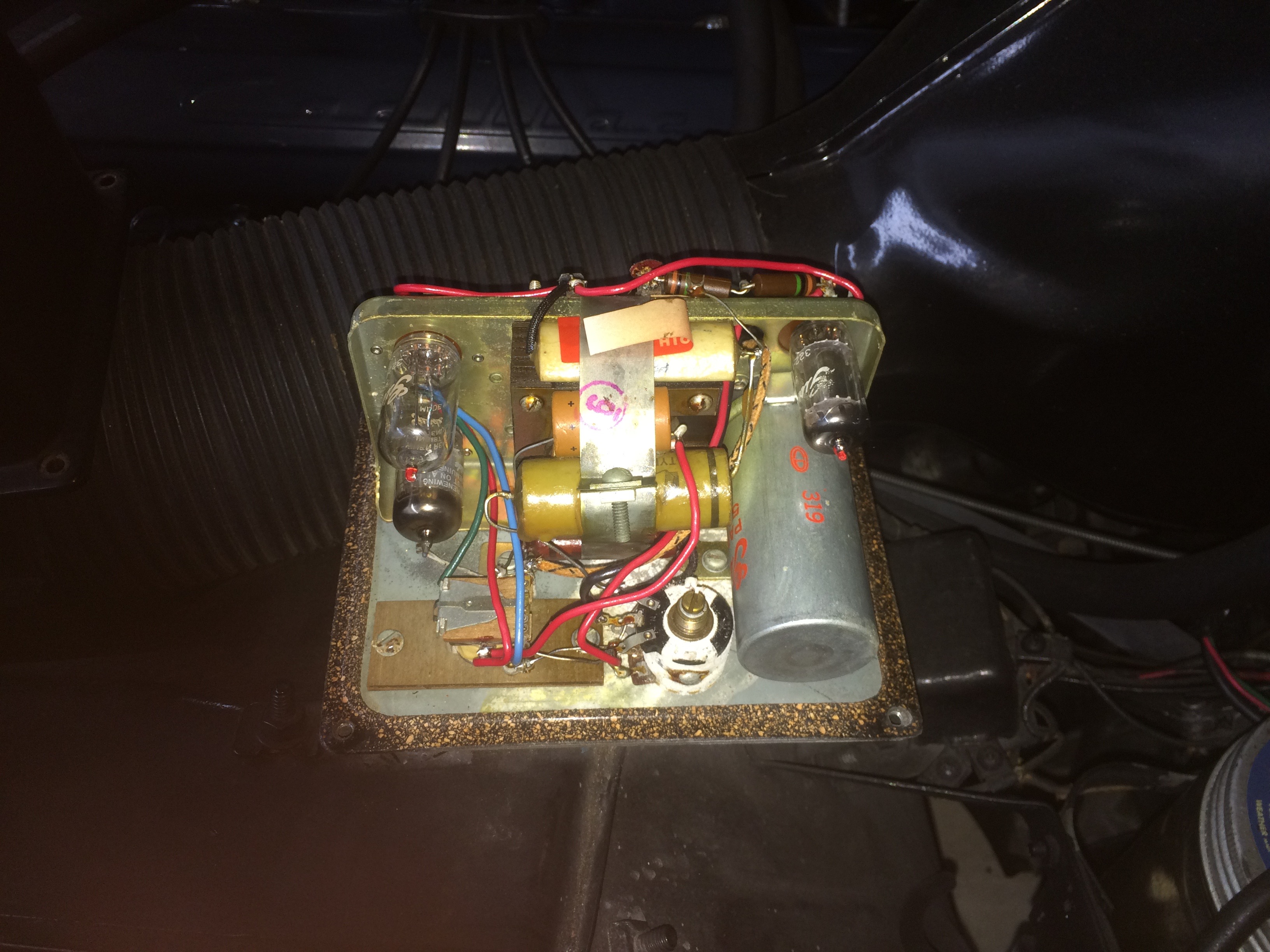

When was the last time you saw vacuum tubes used in a car?
I'm not sure when trip meters entered the scene, but here it is in 1953.
Most of the space behind the dashboard is occupied by that radio. I'm sure there's vacuum tubes in there as well. The radio has an automatic station search function that isn't working.

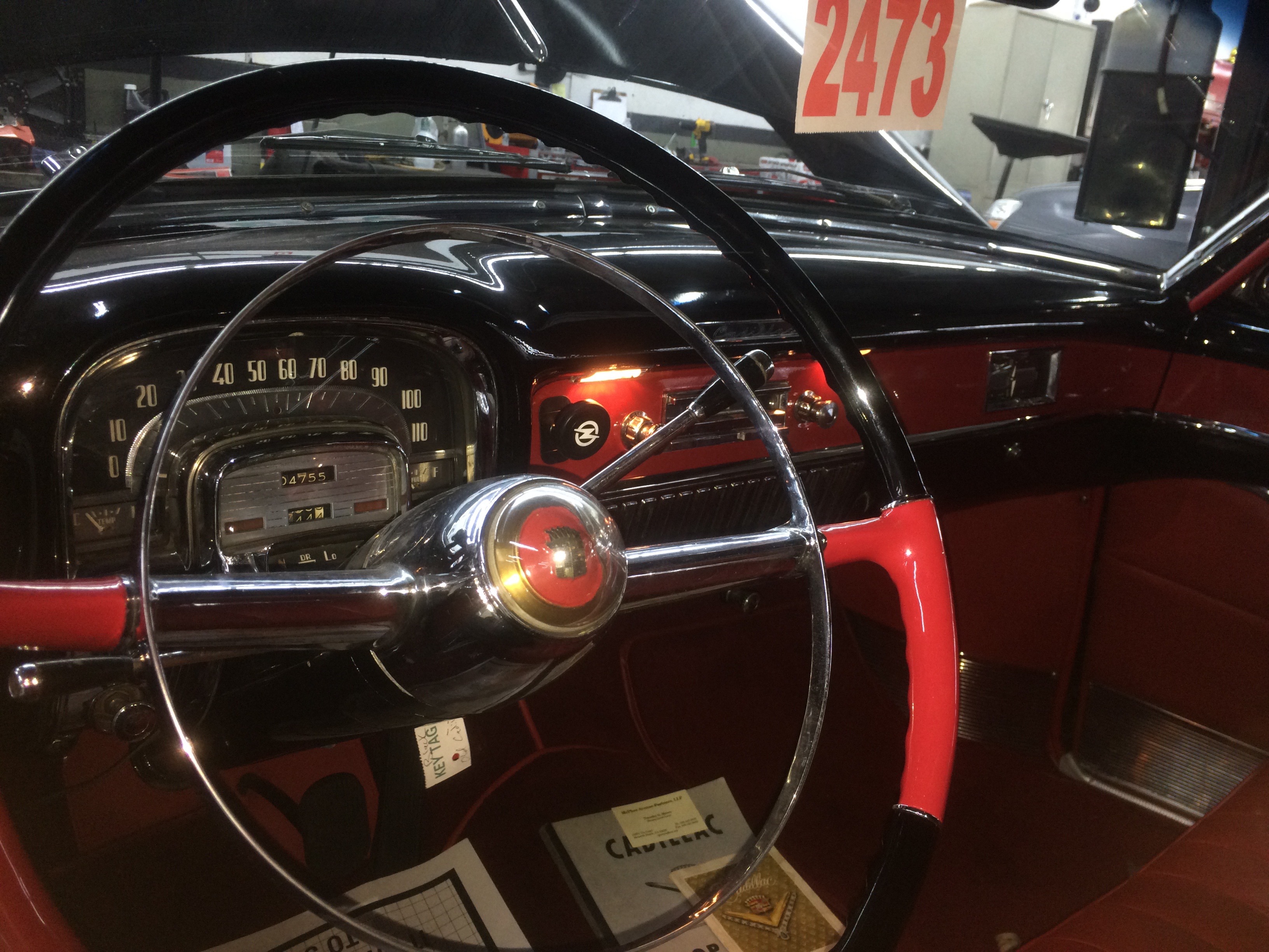

Miles of solid steel dashboard and not an airbag in sight. How did we ever survive without them?
This is the Autronic Eye light sensitive photocell mounted to the corner of the dashboard.
Wish me luck, I'll need it with this one.

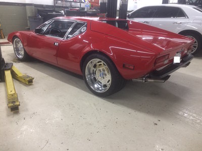

1974 De Tomaso Pantera
We sent out the leaking shocks to be rebuilt and had the wheels polished. I also addressed some brake line routing/chaffing issues, replaced the battery and serviced some fluids.

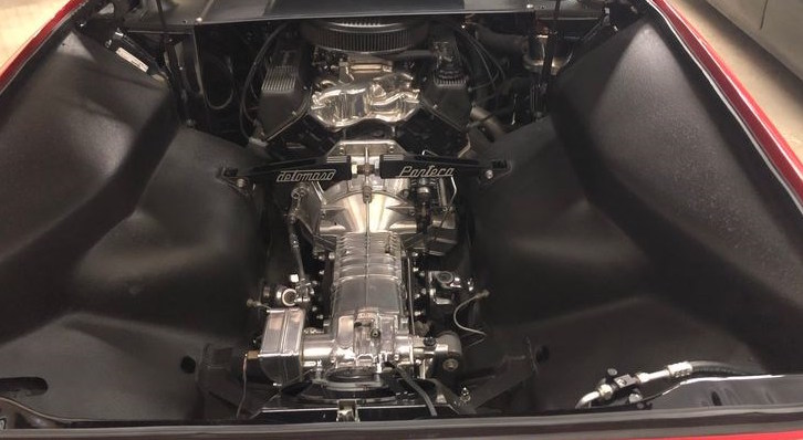

Remove the rear trunk liner...
...for more access to the engine and transaxle.
The power is provided by a Ford 351 Cleveland mated to a ZF transaxle
The interior is tight. I'm 6'1" and I would have to say it was the most uncomfortable test drive I've ever taken. The pedals are so close together, I was having a hard time managing them with my work boots.
Maybe it wouldn't be so bad if I bought a pair of skinny Italian shoes. :lol:

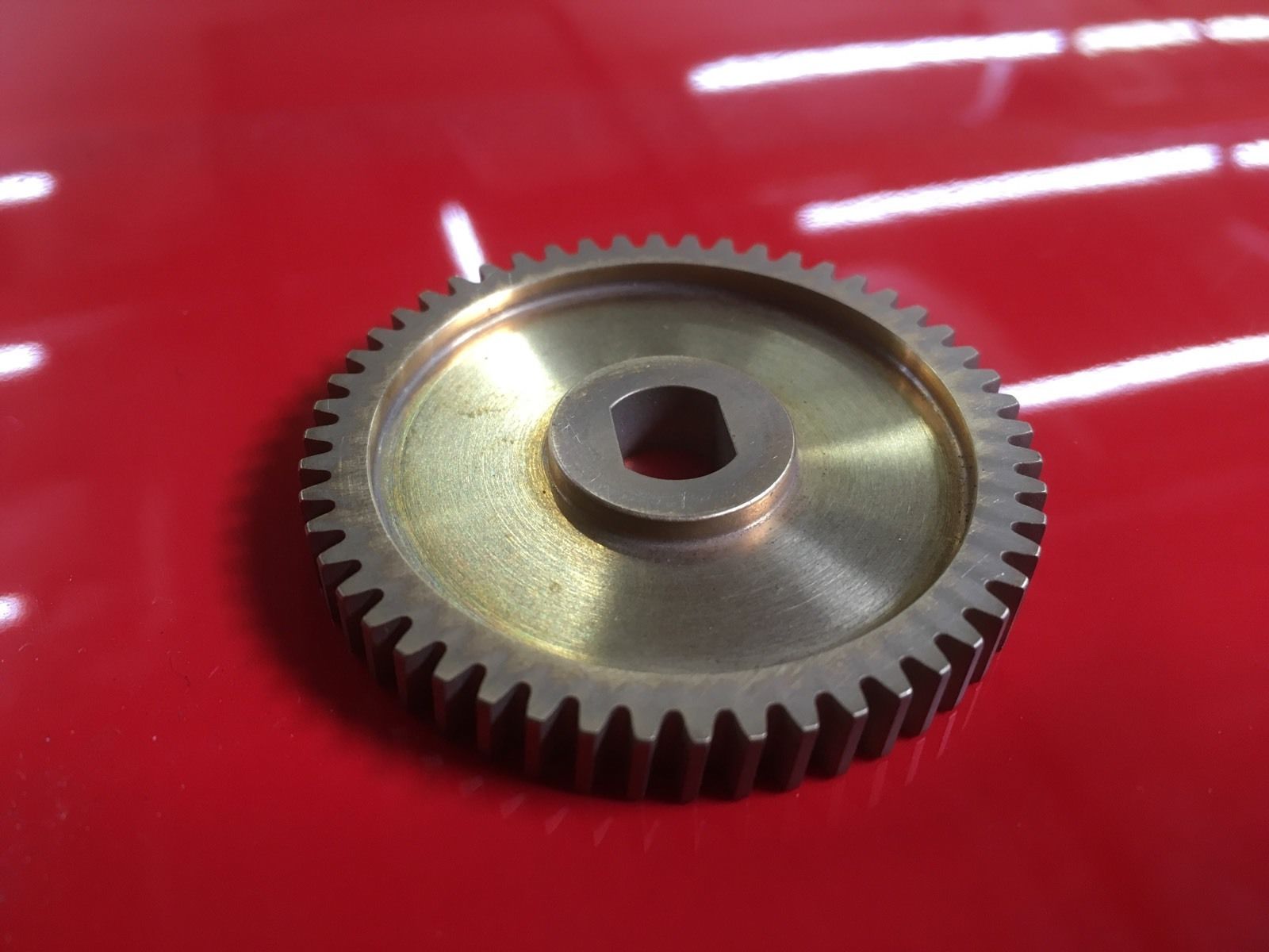

The car was nicely restored, however the headlights didn't work due to a twofold problem. When it was restored and the interior was reassembled they wired the relay incorrectly. When I would turn on the headlights, all it would do was buzz under the dash.
It uses a DPDT relay with a clear housing cover like this one, which was handy for being able to identify the internal circuit flow for each pin.
Luckily there are pretty good resources available online with forums and enthusiasts where I was able to find a proper wiring diagram to get the electrical side of the problem figured out and wired correctly. However the headlights still wouldn't pop up, but at least there was no more buzzing and I could hear the motor running.
It turned out that the main drive gear in the lift motor was made of plastic and had become brittle and stripped out. The motor is used for a lot of other european applications (power windows) and a brass replacement is available. After making some adjustments to the travel limit switches, everything works like it should.

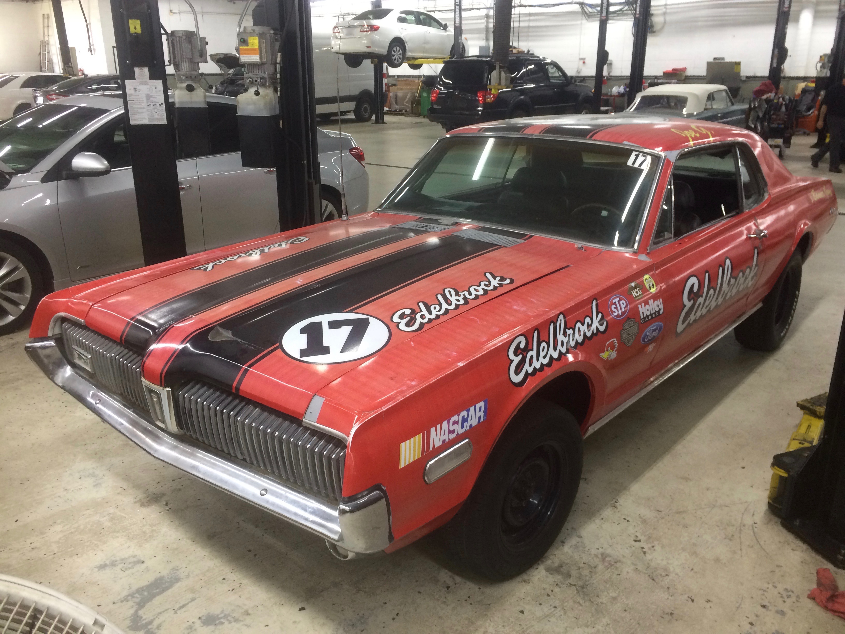

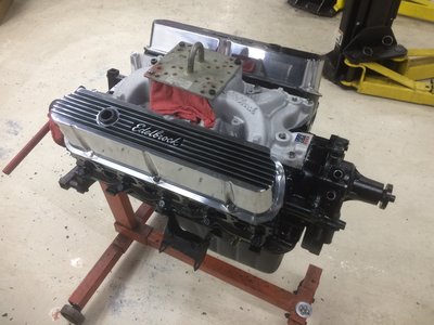

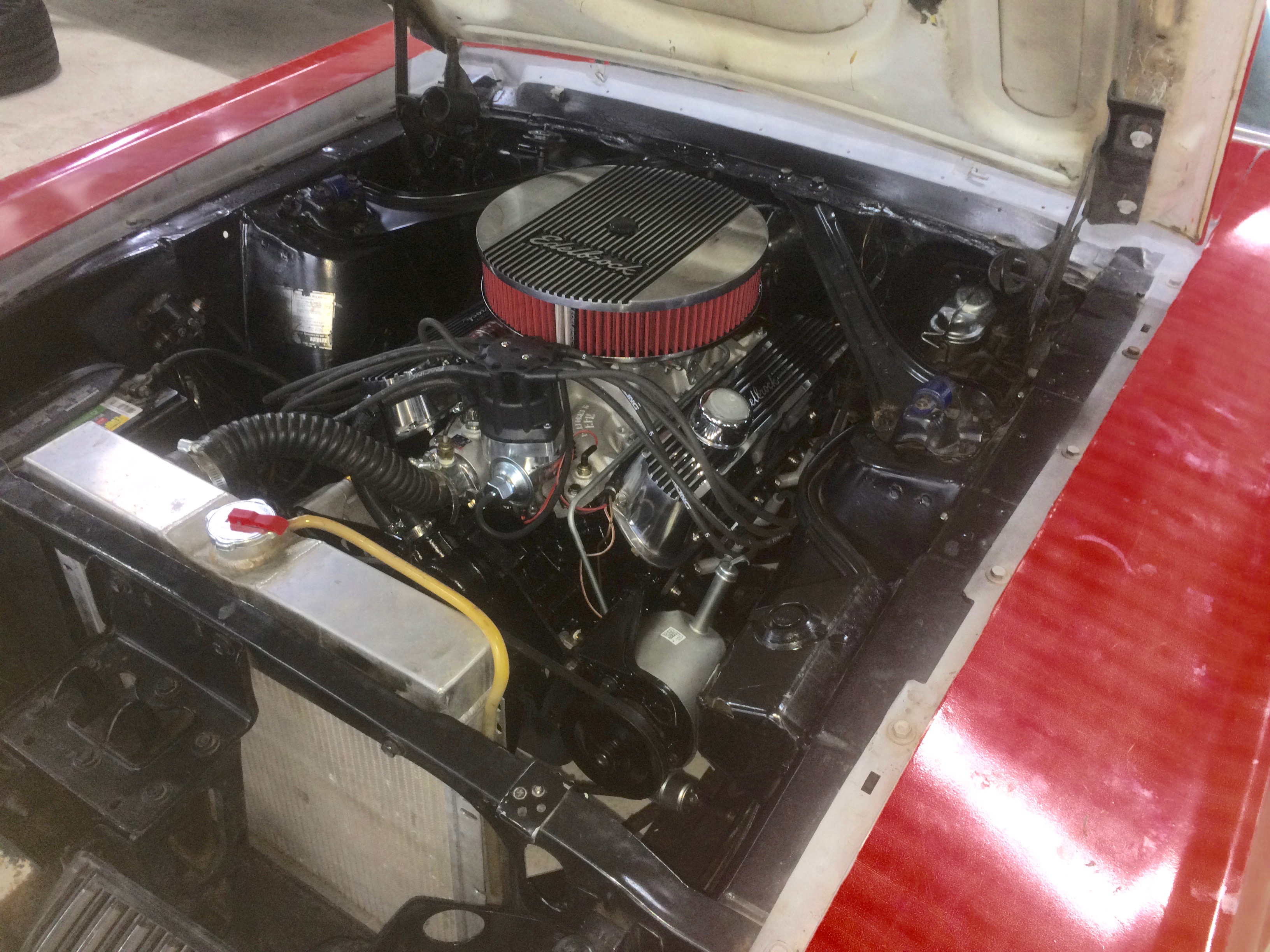

Got the engine installed and finished yesterday. It's a 1968 Mercury Cougar. The customer was hoping to have it for a special occasion this weekend, I'm glad it worked out!
Ford 302 V8 following the cars Edelbrock theme.
Still needs some finish detail on the spark plug wires.
He says it's an original "Dan Gurney Special" but the graphics wrap appears to be a combination of a tribute to a Dan Gurney race car and a Hot Wheels Edelbrock Cougar.
The graphics are actually a wrap that's fading and peeling pretty badly. There's still a long way to go to make this restoration complete.
But at least it runs and moves reliably under it's own power now and sounds awesome with the new Flowmaster exhaust system.
To be continued... :patriot:

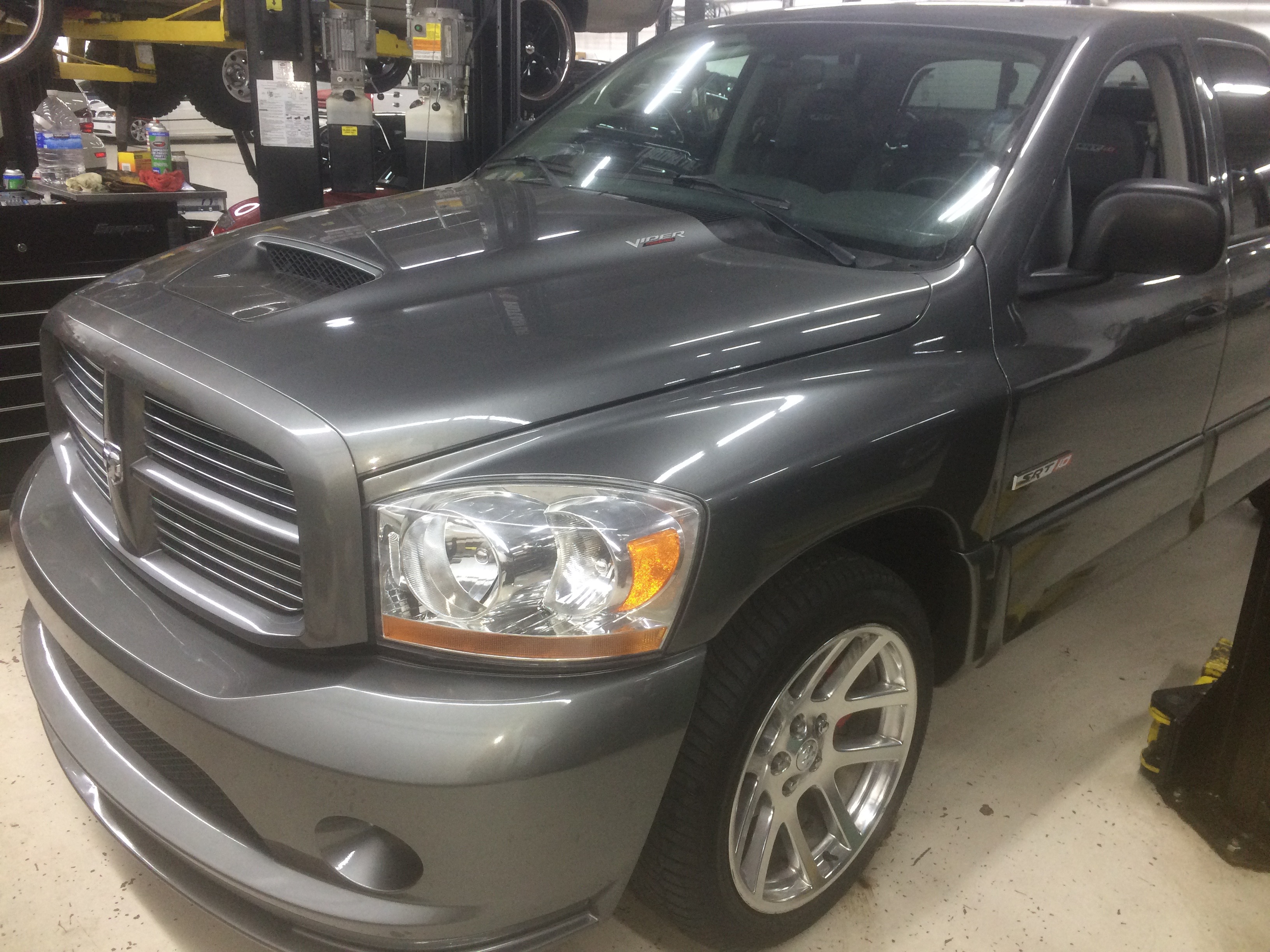

I had the opportunity to work on one of these modern classics.
2006 Dodge Ram SRT-10
These trucks still hold the record for being the worlds fastest production truck @ 154.587 MPH.

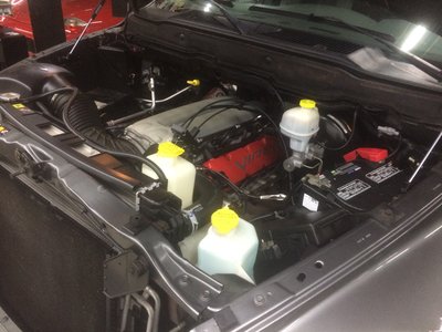

8.3L (505 cu. in.) Viper V-10, 500 HP, 525 lb. ft. torque
Lots of power, however I've never gotten used to the drone of a V-10. I still prefer the note of a healthy V-8, it just sounds right. I'm looking forward to the introduction of a 7.0L Hemi! :excited:
Maybe this is the engine that should have come in the Power Wagon (if the winch would still fit).
I replaced the front pads and rotors, which were quite massive for a 1500. They went metal to metal with only 20K on the clock. :jawdrop: Lots of hard braking apparently.
