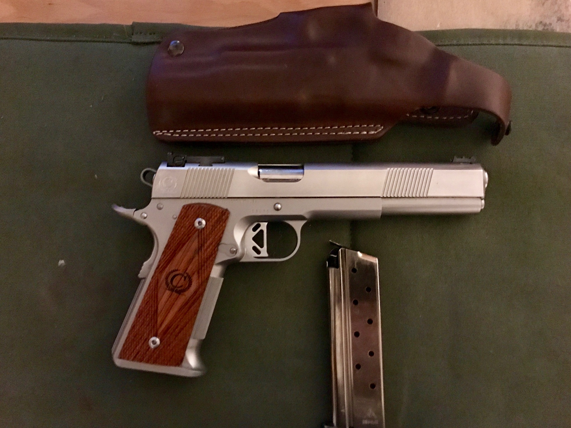

Yes it is a lot for parts. It comes as a raw frame & slide (I had an integral plunger tube & ejector machined into the slide). You have to either order or macine every part. The frame/slide are milled to min tolerance, while all the Ed Brown or Caspian forged parts are made to max tolerance, thus every part has to be hand fitted. Some parts required 10-20 min of filing & stoning and then a quick metal polish, while others had to be reamed/milled by hand and took hours to fit.
The match Bar-Sto bbl & bushing took the longest, required the most machining & filing, and was the most tedious, probably have near 20hrs on the bbl alone.
The sights also took a lot of time to fit, provably 1-2 hrs for the front sight & probably 5+ to get the rear sight installed...huge pain.
So yeah, it’s a labor of love, but it’s a unique gun that no one else has because i custom ordered every single feature. But, it’s not for everyone—you have to like doing that kind of work, be really patient, & be mechanically inclinded for this sort of thing to interest someone. I enjoyed it. I’m proud as hell of how it turned out. It was a shit ton of work, and it is as smooth, tight, & as custom as you'll ever feel—Ed Brown isn’t hand fitting, filing, machining, polishing, stoning an entire gun like this either.
Good luck finding a gun like this for $2K. Ed Brown finally released a a 6” long slide 10mm while I was building my gun, and it is $4K, and other than the rmr, has less features.

6” Caspian 10mm pics

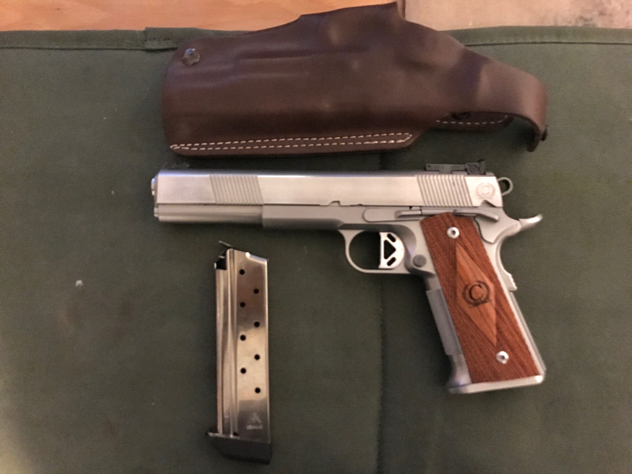

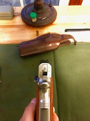

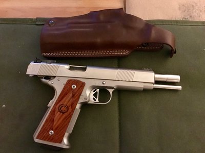

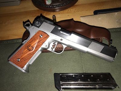

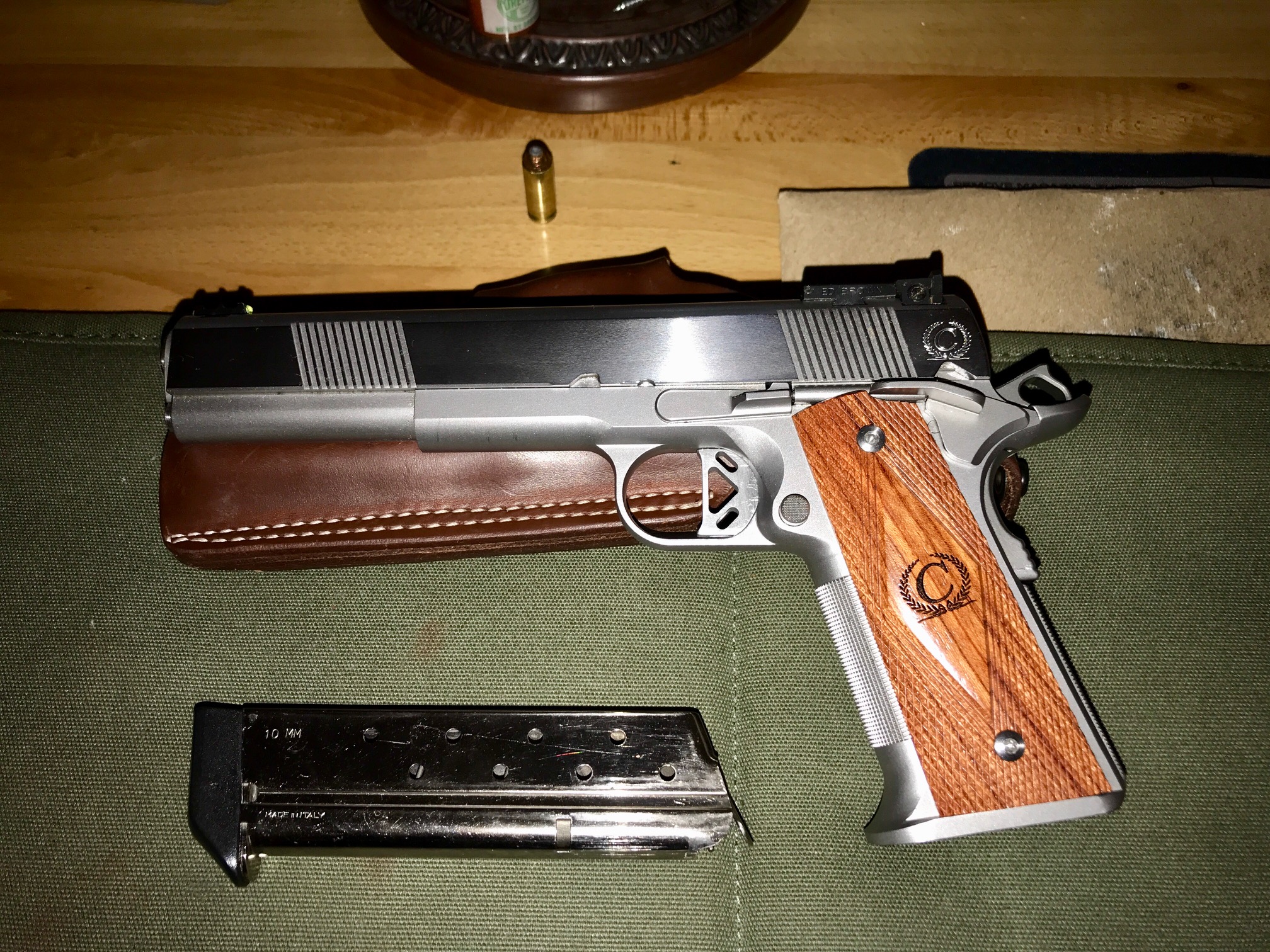

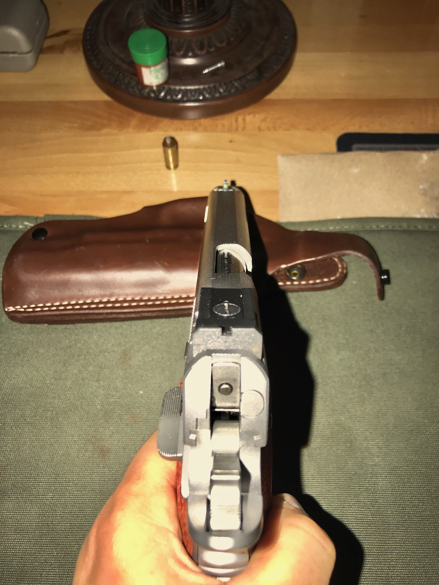

Post by adeluca73 » Sat Nov 04, 2017 1:05 am
As promised, my recently completed custom built, antiquated, Caspian 6” 10mm 1911 (w/ Caspian and Ed Brown parts, Bar-Sto BBL, WOLFF springs) :

I have to say, that Caspian frame and slide are works of art.
Posts: 779
Re: 10mm Doubles
Post by Mule007 » Tue Nov 07, 2017 7:14 am
Congratulations! Your gun is beautiful; excellent work !

It came out great. You have to love the feeling of putting one together yourself.

Great work sir! It came out very nice! :rockon:

Post by adeluca73 » Wed Nov 08, 2017 3:15 pm
Rodeoflyer wrote:
Mon Nov 06, 2017 10:36 pm
Thank-you. They do a good job. When I was finished, I bead blasted the frame, and used Mother's metal polish and newspaper on the slide several times. After I was finished building it, as you could imagine, the frame had several handling marks, scuffs, nicks, etc. from just handling while building--nothing major. I got most of it out, a few more passes with 2000 grit and Mother's probably will make it look better. I still have to cut down the grip safety to match the lines of the frame beavertail. Not a fun job, but the 1/16" misalignment is unsightly, purely cosmetic, but it's bugging me, so I'll have to make a quick jig to align everything, then grind the beavertail, hone, polish, and then bead blast the back side again.
