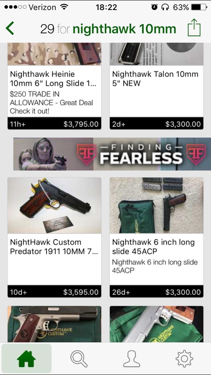

Selling it never crossed my mind. Fourms aren't my thing. I've spent more hrs than I care on Gunbroker, GunsAmerica, & similar, and a quality 1911 10mm (Nighthawk, EB, LB, etc) are not available for under $2500, hence the decision to buikd my own equivalent gun...which will be under $1700 all in. There's never an EB for sale, especislly in 10mm, and they don't even sell a long slide. Here's a Nighthawk close to what I'm building, except in SS: http://www.gunbroker.com/item/655865436
29x Nighthawk 10mm available, none under $2500
