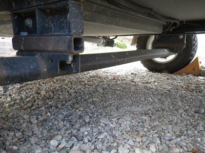

How did you go about lifting the trailer with the Torflex axle? Did you just add taller blocks between the axle and trailer frame, or did you swap out the axle? I have the Hood River Edition as well and also considering lifting it a little more. I am considering swapping the axle to a 5,000 lb. leaf spring system.[/quote]
I was going to build a whole new riser but instead I just added a 2" square pipe spacer and stronger bolts. To make a template for the bolt holes I removed the bolts from one side raised the trailer enough so I could slide a heavy piece of paper in between then set the trailer back down, the weight imprinted the paper for exact location of bolt holes. The trailer pulls the same as it did before the extra lift and I have had it on there since 2011 and taken the trailer in some rough terrain with no issues.The photo is giving the illusion that it isn't square but it is, ( I had to go back out and make sure after looking at the photo) .

Thanks for the information. I was thinking about doing the same thing that you did to add some lift, but wasn't sure about how strong it would be. I am glad to hear you have had it down rough terrain. I may just have to do this.
