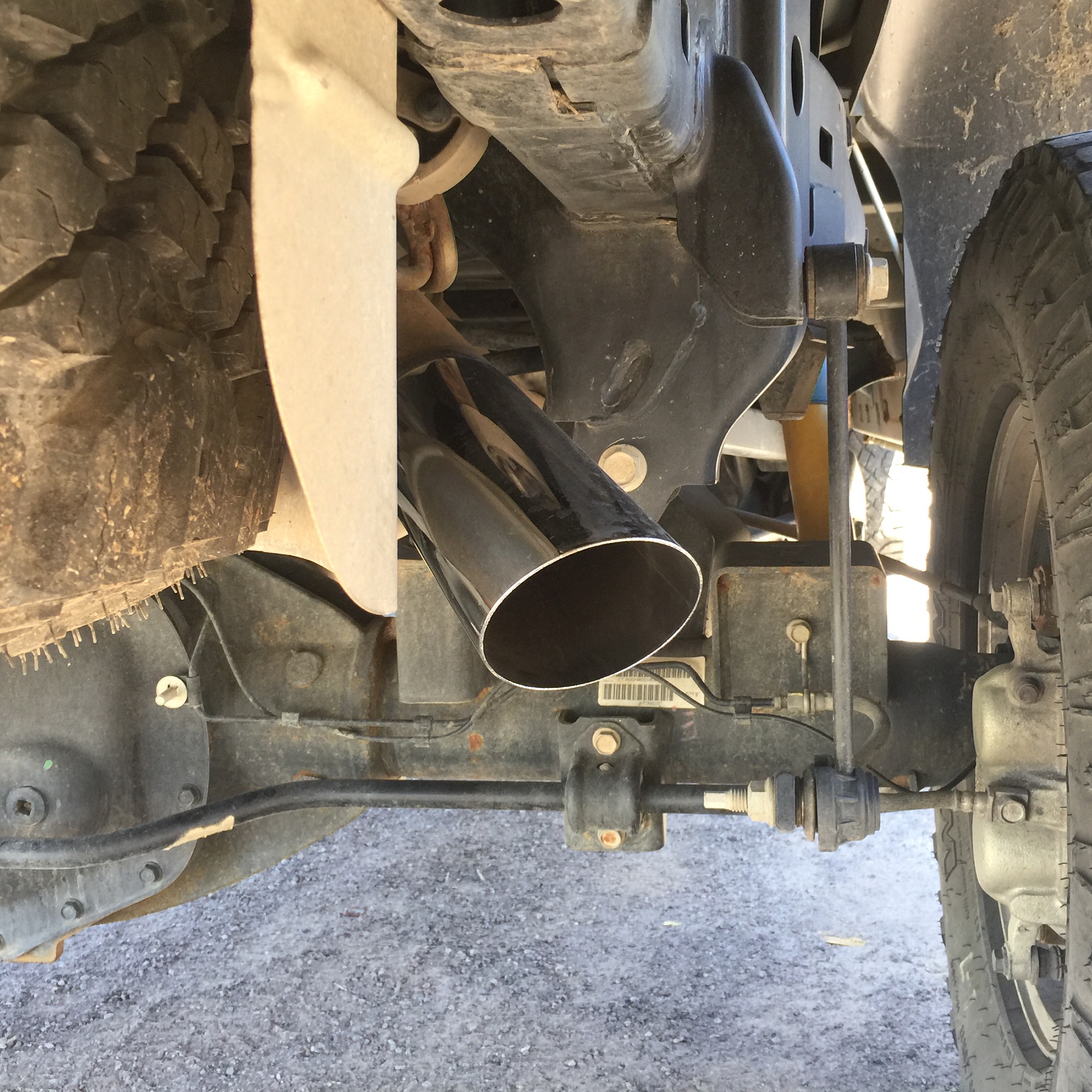

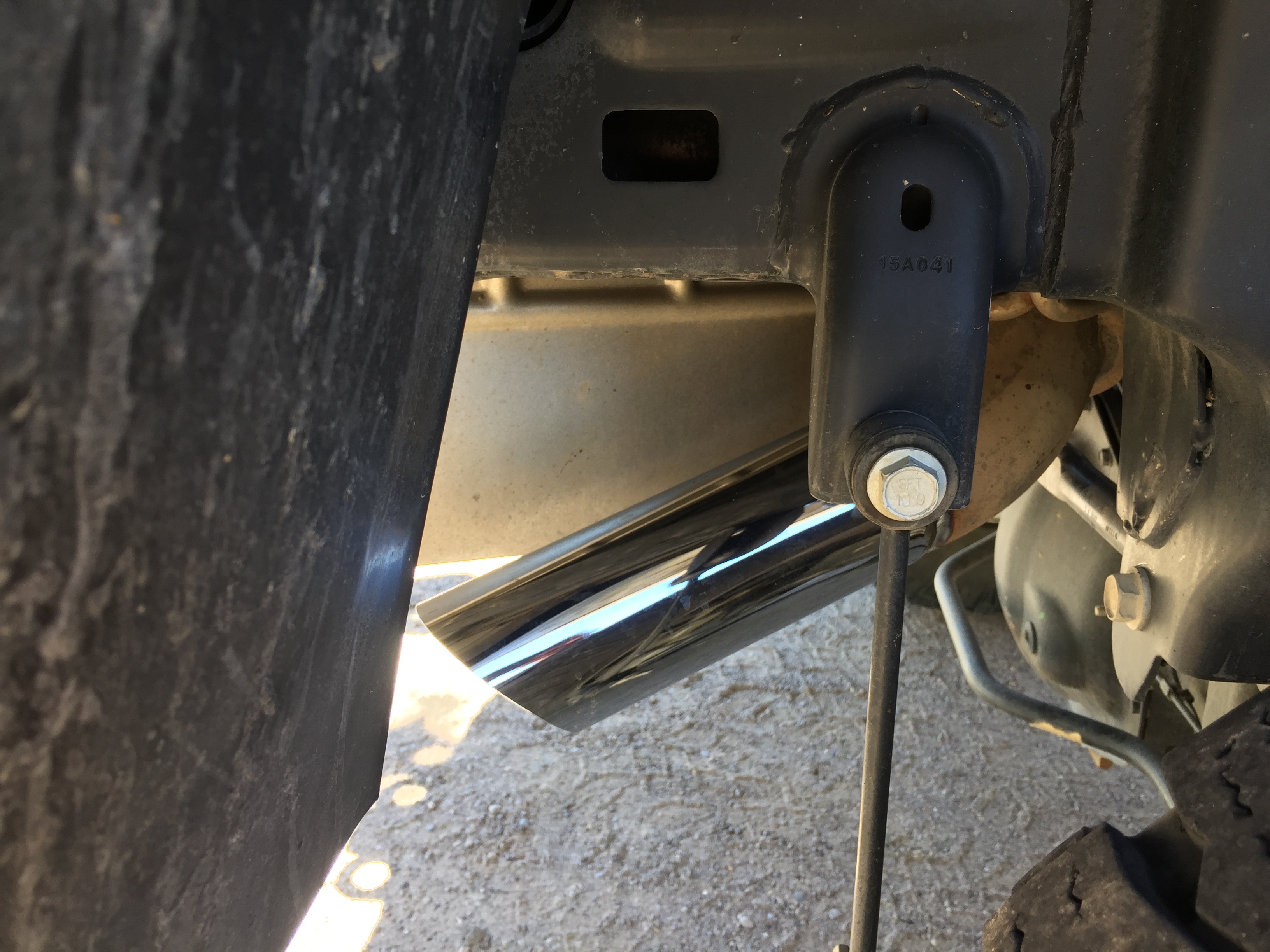

Post by adeluca73 » Tue May 13, 2025 2:16 pm
First mod I did on my 2014 was the mufflex “drop” in muffler replacement. I wasn’t satisfied with the change in sound, so I had a muffler shop remove the resonator and weld on a dump pipe. The dump pipe lasted about 8 years and rusted off. I had a replacement pipe welded on but this time I had it run out the side behind the rear tire near where the stock resonantor/exhaust was located. After living with that combo as a hunting only truck for 10yrs and 60k miles, I’m glad it’s gone. It was loud on the highway, had horrible drone at like 3 different speeds, was worse in 6th gear, so I routinely turned ON tow/haul to keep the motor at a higher RPM which helped with the drone. I am not planning on installing either the mufflex or removing the resonantor again on my 24, well maybe the mufflex just to save weight over the ridiculously huge OEM muffler—my build thread has pictures and the dB readings I tool at the time.
