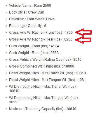

Here are the Power Wagon specs that I printed when I ordered my 2014:
Axle Capacity specs.jpg (21.93 KiB) Viewed 9930 times
Keep in mind that the Engineers run the suspension/chassis parts through an FEM analysis and then apply a generous safety factor for mass production vehicles - Perhaps the Safety Factor could be 3X ;) Shock load would be the primary killer for an axle...

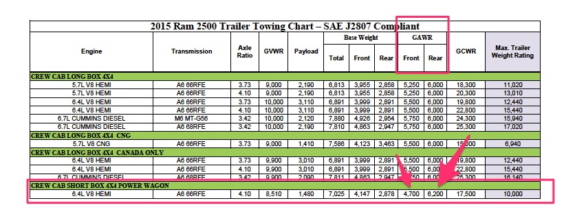

That's odd. That doesn't seem right. Not arguing, but apparently RAM can't even get their own info right. This is their PDF off their site for towing.
I'd been going off this forever and thought I was over my gross front axle weight all the time.

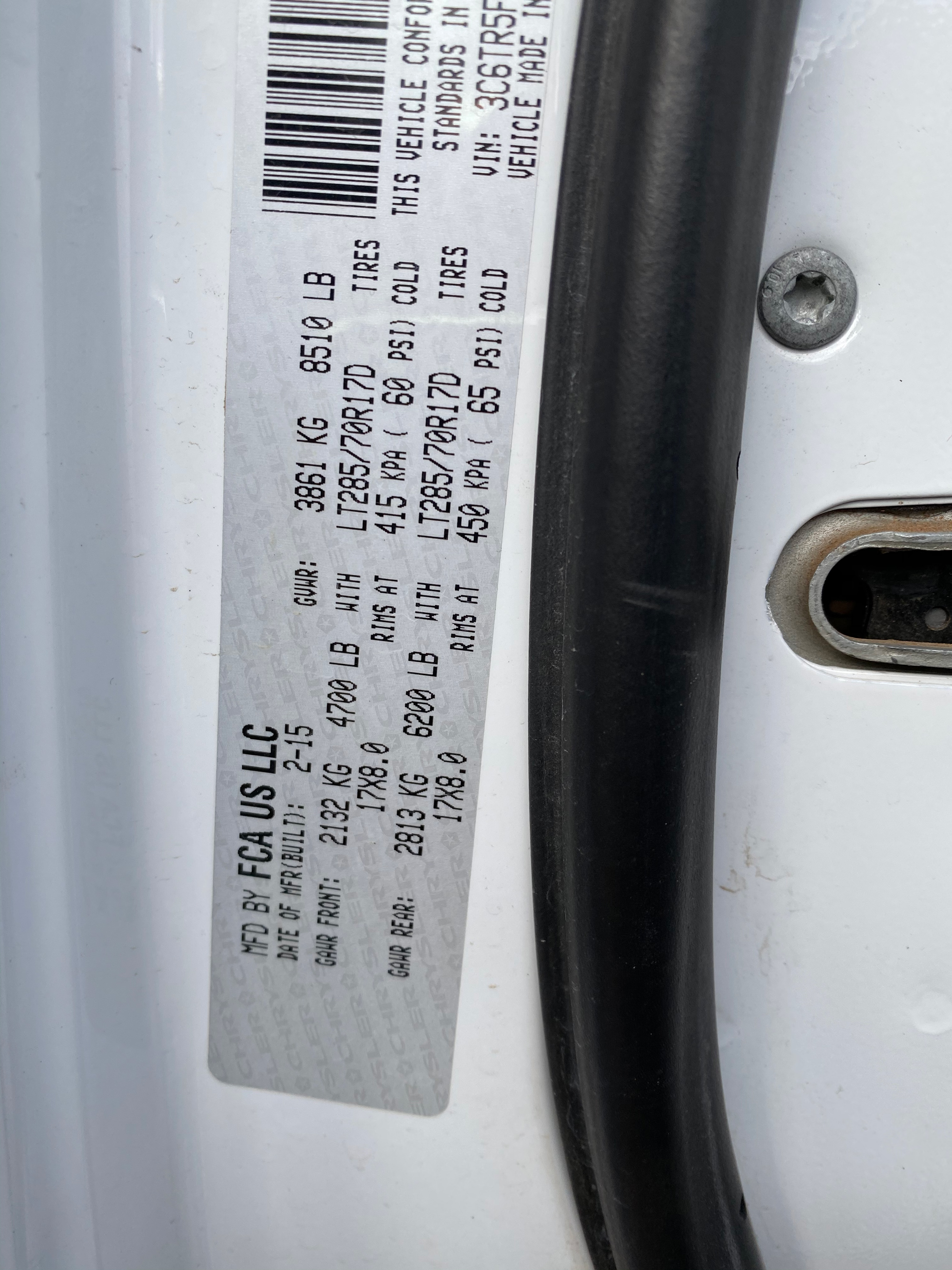

Re: Anybody build a driveline protection solution that works?
Post by OffroadTreks » Tue Mar 03, 2020 11:10 am
Well, this is my door. This is all the matters.
Zak you might wanna go look at your door again.
I know from my cat scale receipts that when the family is loaded, I'm over my front GAWR all the time. But I do have a truss.
