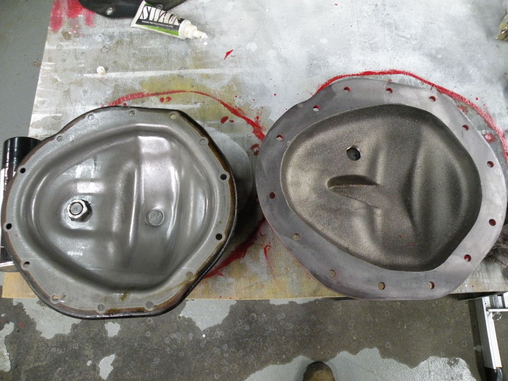

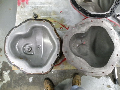

I was wondering about my RockCrusher diff covers. Found some pictures when I installed them. I can see the higher fill hole.
The inside shape is close the the factory. Just changed the fluids in both diffs back in June. 3 qts in the front and 6 qts in the rear. Thinking on taking some out.

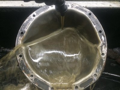

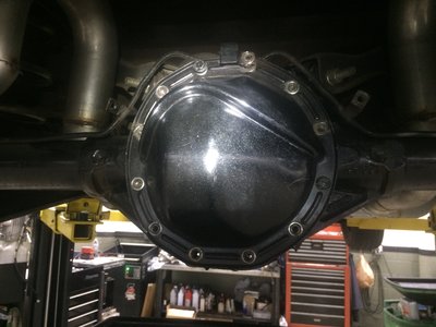

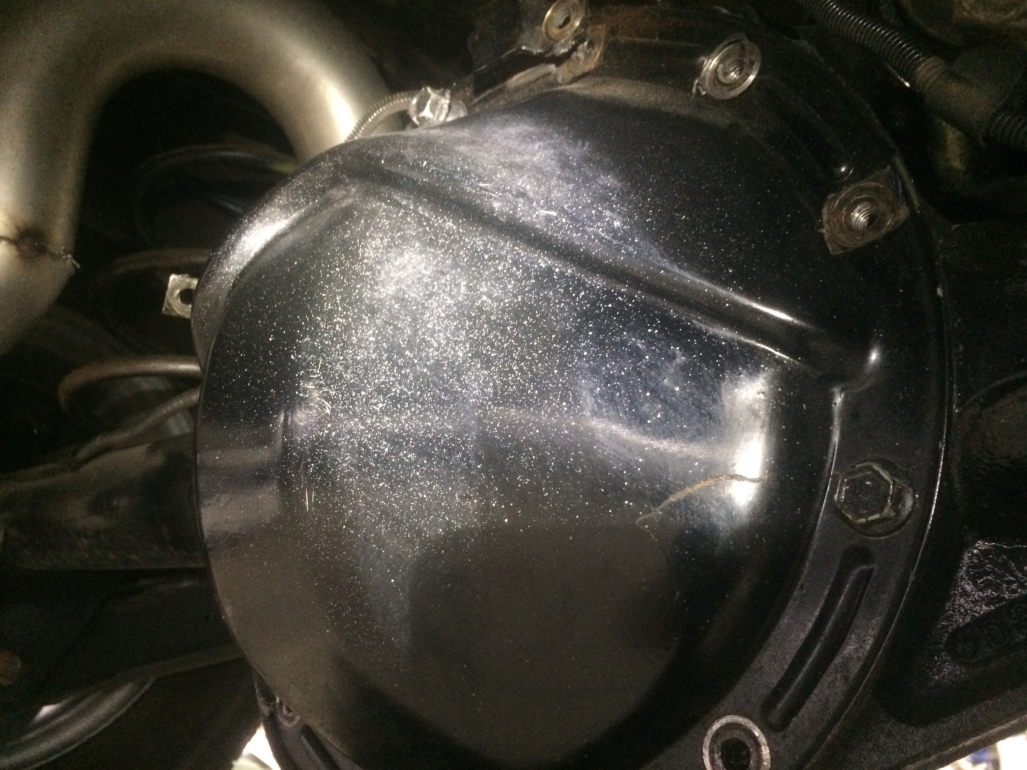

I did a fluid service on an old Chevy 12 bolt LSD this week and thanks to this video series by Banks, I couldn't help but notice the unique shape of the factory cover. It has a channel formed into it to help direct oil to the axle tubes, increasing lubrication to the axle shaft and carrier bearings. I've serviced a lot of diffs in my day, but never paid attention to this feature before.

Look at 14 posts above this one. I posted pic's of the stock and Rock Crusher cover insides.

I see the stock cover has a "channel" for the oil, but our diff housing/axle does not have any holes in it (see white arrows in post by retired BLM rig , pic #3) to redirect/help send oil to the axle tubes, which is what i meant when i said "I don't think ours have anything like that."
Does it ?
Does it ?
