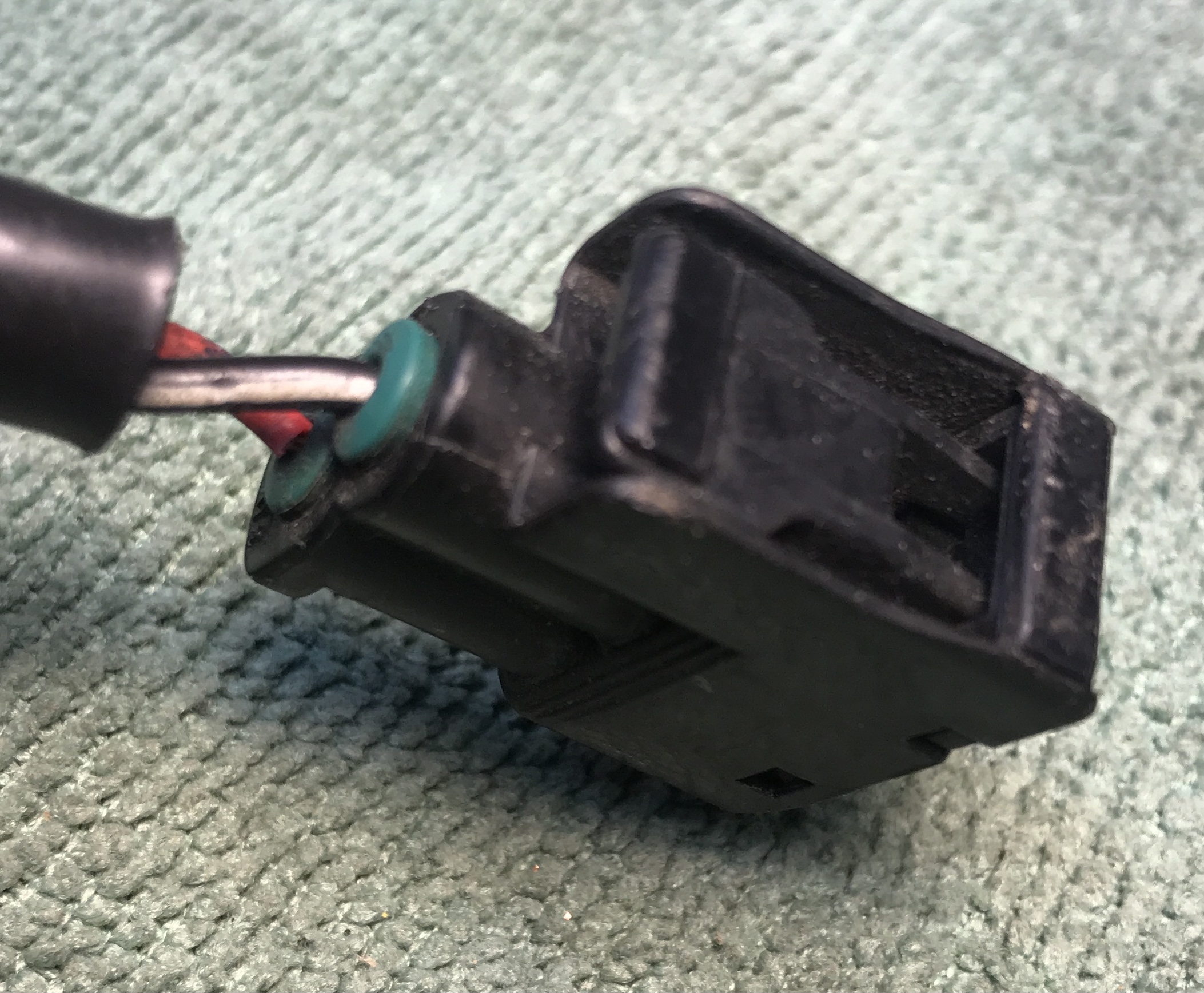

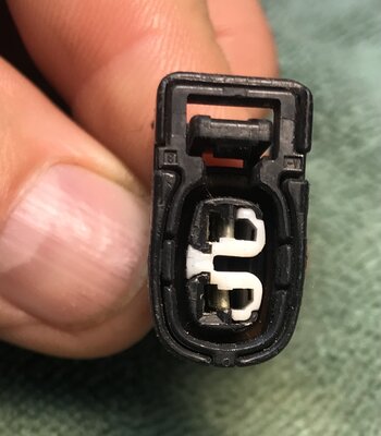

The latch pivots when you squeeze it.
Apply pressure by squeezing the very top of the latch.
This will lift the latch off of the locking tab on the face of the connector. The problem is that the connector faces down, which allows grains of dirt and sand to get trapped in the latch area, inhibiting movement. The best thing to do is use compressed air and a blowgun to try and clear that debris out of the area so the latch moves freely.
You could also try to get a small dental hook tool under the face of the connector and pry out gently.
If you break the connector, you can find a replacement by searching for a "Toyota ignition coil connector" on Amazon or Ebay.
Toyota part# 90919-02216 or 90919-02205.
Good luck! :patriot:
