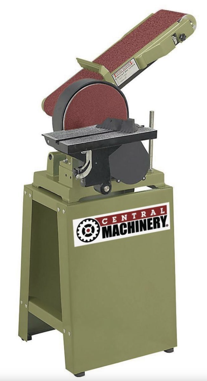

Heat warps the manifold over time and that warpage applies extra strain on the outer bolts, causing them to break. When you get the manifold off, lay a straightedge across the surface and you'll see 1/8" - 1/4" of warpage. Take the manifold to a machine shop and get it resurfaced before you reinstall it and it'll last much longer. Original manifolds that have been machined hold their straightness better, because it has already warped once and they don't tend to move as much after. New manifolds, on the other hand, still have a lot of room to warp, because it's a new casting.
You can resurface it yourself if you have a 6"X48" belt sander. It doesn't need to be a perfect finish, like a cylinder head or engine block. My .02¢
