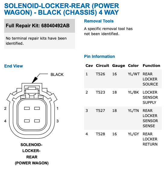

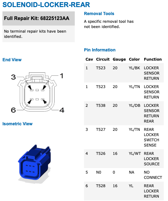

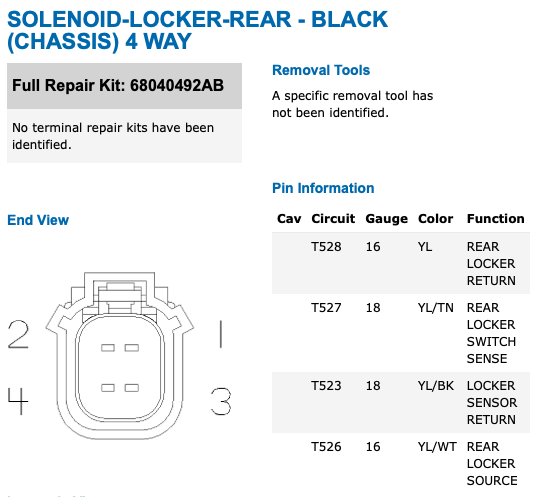

The 2012 has a 4 pin locker connector and the 2014+ has a 6 pin locker connector but it only uses 5 wires.
You can see that they both share circuits:
- T523 = 5V+ sensor reference voltage
- T526 = 12V+ locker actuator supply voltage
- T527 = Locker sensor switch signal going back to the SmartBar
- T528 = 12V- locker actuator ground

Good to know. Sounds like I'd need a 6 pin repair connector to plug into the 14+ axle and would need to either modify/splice my existing truck wiring, or potentially build a small adapter of sorts. I'm hoping it could be as easy as just joining the two ground pins (including the supposed ground T538 pin) at the 2012 truck's T528 connection/pin. Fortunately, it appears as though the other voltages/signals should be the same, and my '12 would be happy with the connection.
